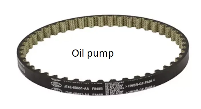

What do you guys think of this cheap wet belt and issues in the future? Until 2017 the 3.0 ecoboost oil pump was chain driven. .
This is a big engineering downgrade, and don’t come with things like less friction an emissions, because this is a fail on purpose design. .
Your concerns are warranted but stem from old technology and early on experience in materials and design with oil bathed timing belts, oil bathed oil pump belts from all the way back to 2008 and failures. This can stroke an emotional issue with some but if the design was problematic we would see an internet riff with the reports/recalls. We all learn from our mistakes and manufactures pay in recalls to address issues and yes they learn to. In 2021 Ford actually tested the 5.0l coyote oil pump belt all the way up a 1100 hp engine. In hate to burst your bubble but as we the consumer respond to more performance gains/mpg manufactures do to. Longevity in engines is a big concern. Well timing belts went back to chain drives in many engines for several reasons a big one was, component load, more valves, cams etc.... Chains can stretch much further than any timing belt, depending on particulars of the engine and still work fine. Those chain setups have a higher friction coefficient than any rubber belt. EPA guide lines if not met, cost them money so that loss had to be made up for, aka oil drive belts and drive systems which vary pressure among other things to meet guidelines. The belts today are made with Kevlar not the rubber ingredients of old, plus larger cogs, much shorter and rounded gear teeth not the common squared found in the older timing belts which also went to a more rounded design today to reduce friction and many moved to the Kevlar. See Pictures. So if overall testing shows a certain percentage in friction reduction and says gives them .3% mpg gain toward EPA standards multiply that times the sales numbers. That's big bucks in comparison of not meeting EPA can cost manufactures hundreds of dollars per vehicle. Oil changes and type as others have mentioned are key! Some of those belts are 7-8 years old now with whatever miles. Untold hopped up coyotes with the belt. I can't tell you how many of the old style timing belts I've replaced well above the recommended 70000 miles back then in motors with 120000 plus on them. Bad news lives a long life and strokes fears, where as good news seldom gets reported. Hope this helps with all of ours OCD on the belts but hey we still have warranty, don't we, I hope! Time will tell along with mileage but I'm not going to loose any sleep over it. Ranger On! :rockon:
