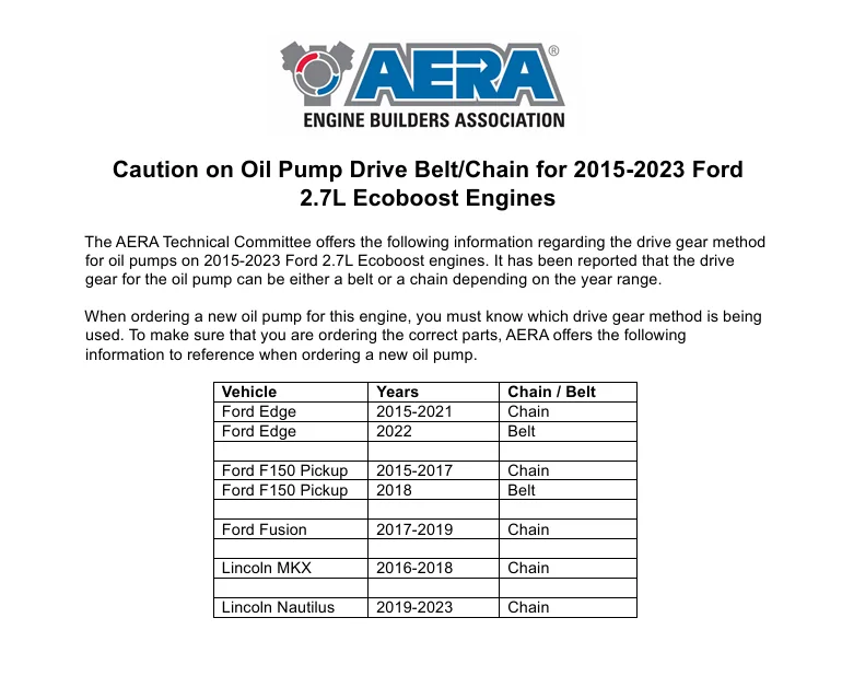

machinist
I just throw this here. Although it doesn't say anything about Ranger.
The oil pump belt has been used in F150 since 2018. And there are millions out there.
