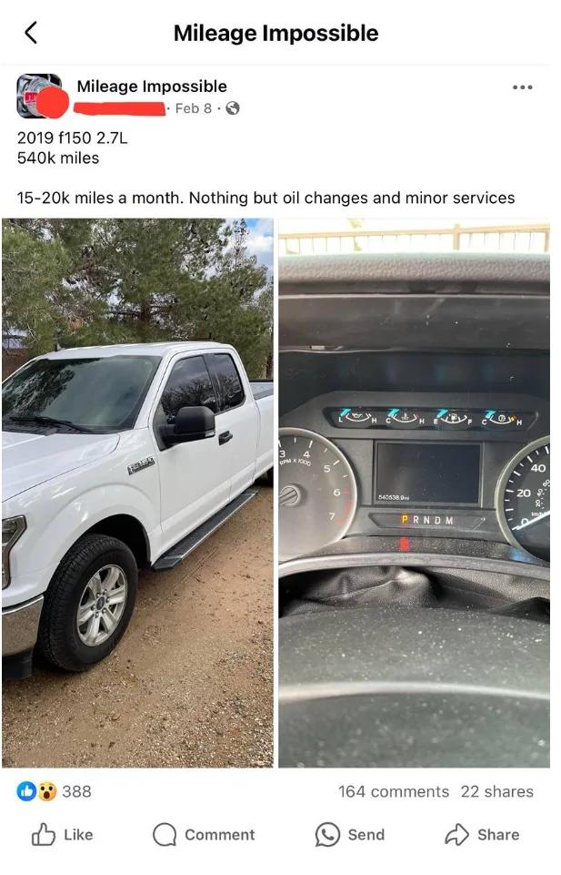

This one really gets me, 2019's have wet belts just like 2018+:
Mileage Impossible | 2019 F150 with the 2.7 motor 542k | Facebook
