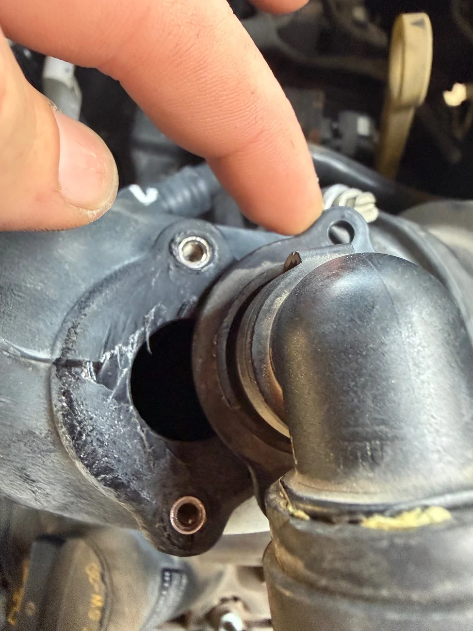

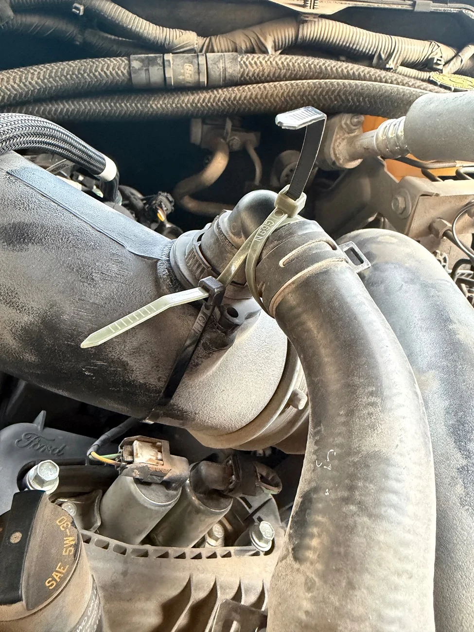

Mine is loose as well, in the install video they say it’s optional to even have it. If you’re considering or regularly need to cross water that is above your tires, I personally think that’s snorkel territory…
if you’re going to go fast on washboard roads, put some loctite on the screws holding the BOV recycle PCV connection , otherwise this could happen to you (see picture).
