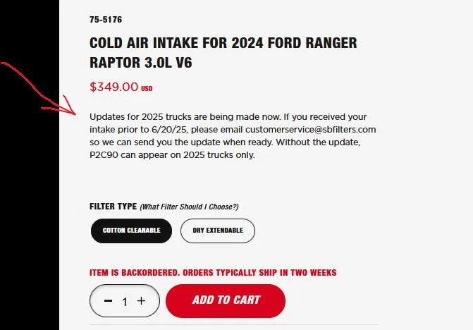

its actually noted on S&B's site now under the intake listing:
Sooo, I reached out to customer service and this is an odd response to their posting:
“After speaking to the engineering team, this shouldn't affect your vehicle. You can go ahead and install the kit as is. In the event of CEL just let us know and we can update yours with the revised parts when they become available. The new parts will be a few months down the road.”

Per their direct posting on the website and the detailed post from Nick0188 it is an issue and they are dismissing it:
I was the one who posted on Facebook with the CEL after installing. I talked to S&B a week or so ago and confirmed with them it’s a real issue, but only on 2025’s. For 2025 there is a code that wasn’t monitored on 2024’s that checks the PCV flow.
So a TLDR of sorts:
  • Only effects 2025’s
  • Does not happen on 2025’s with the side panel installed. Will definitely happen on your 2025 with the side panel removed
  • Not an issue in any configuration with 2024 trucks
  • S&B are working on a fix, which is most likely a revised PCV plate to reduce the flow back to OEM levels to get around the code
  • With the side panel removed there is much more flow through the airbox, which in turn pulls much more from the PCV, making it think the hose is disconnected, causing a code.

I wasn't saying that a CEL doesn't happen with the 2025's, I understand the issue that is happening. I'm saying according to them it will not hurt the truck so you can run their intake without the side panel if you want to or just leave the side panel on and not throw a code.
Once they have their remedy for the issue they will sending out the revised parts once they have them if you let them know you need them. That does not sound like they are dismissing the issue to me, they are not going to have a fix over night.
Unless the issue puts you off that much and you just don't want the intake anymore and want to send it back and get a refund that's an ok response in my opinion.

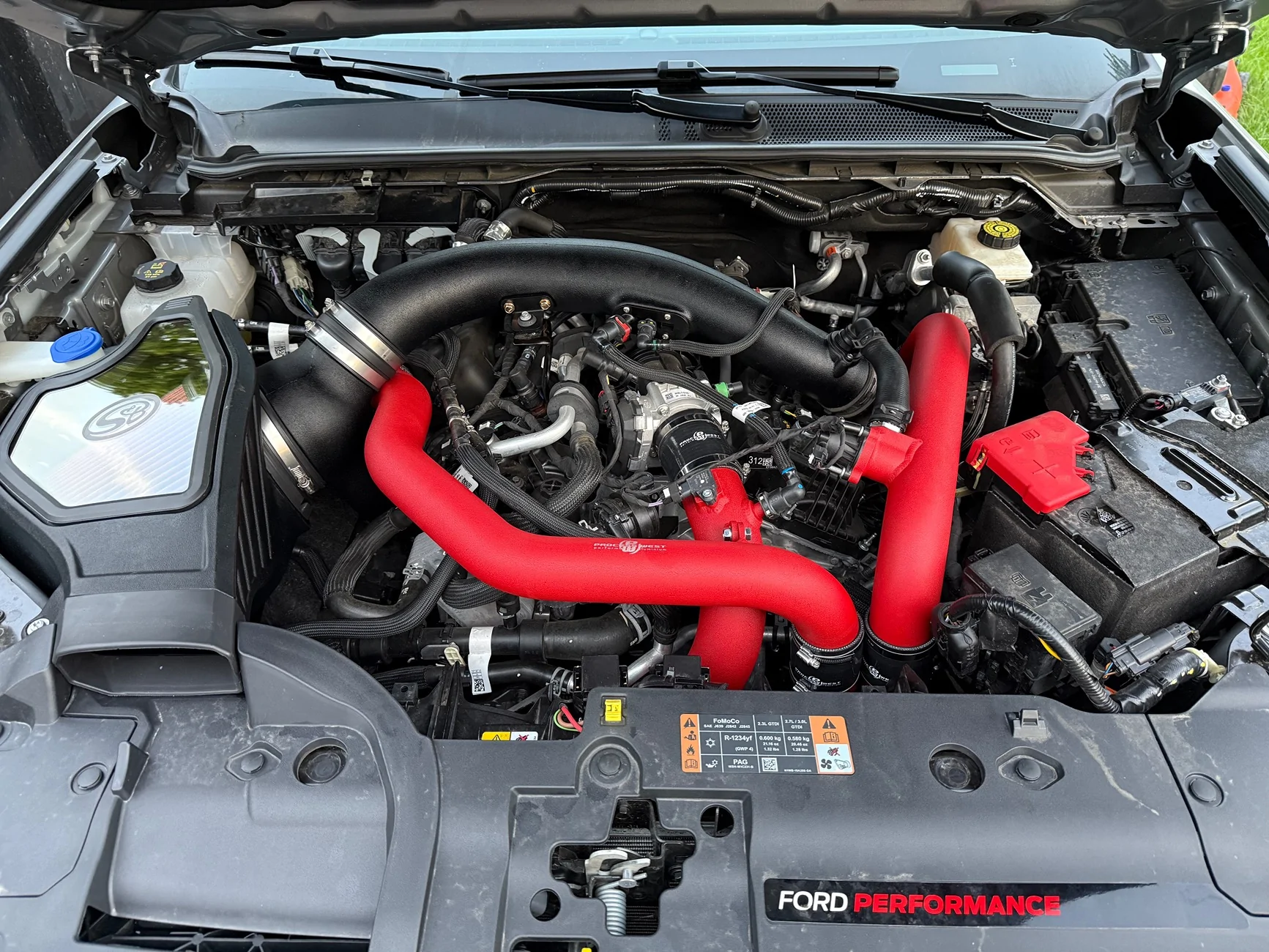

Will this intake work with a process west crossover pipe
arandazz
Andrew
Jul 22, 2024
PA
2024 Raptor Ranger
Fits with charge pipe. Not sure about the crossover.
