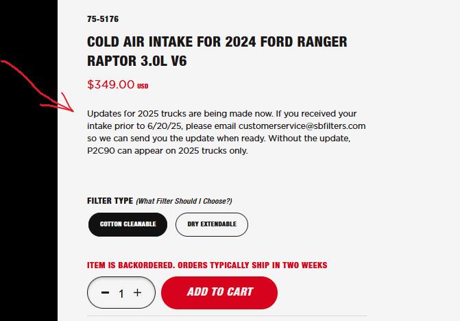

I was the one who posted on Facebook with the CEL after installing. I talked to S&B a week or so ago and confirmed with them it’s a real issue, but only on 2025’s. For 2025 there is a code that wasn’t monitored on 2024’s that checks the PCV flow.
So a TLDR of sorts:
  • Only effects 2025’s
  • Does not happen on 2025’s with the side panel installed. Will definitely happen on your 2025 with the side panel removed
  • Not an issue in any configuration with 2024 trucks
  • S&B are working on a fix, which is most likely a revised PCV plate to reduce the flow back to OEM levels to get around the code
  • With the side panel removed there is much more flow through the airbox, which in turn pulls much more from the PCV, making it think the hose is disconnected, causing a code.

its actually noted on S&B's site now under the intake listing:

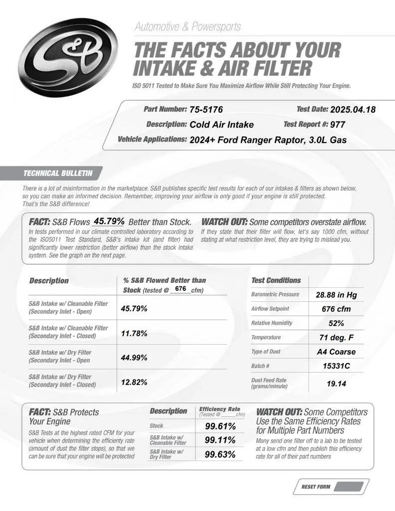

I'll leave this here in case you haven't seen it, its kind of hidden on the site on a little link but i'm assuming the secondary inlet is "that Cover on or off". Pretty drastic difference?
Ford Ranger S&B Ranger Raptor Intake available in May 1751053518625-90
  • Wow
Reactions: BKP
Wow, yes, quite the difference indeed! I've emailed customer service. Will leave it on until the fix is ready. Guess I should think seriously about an IC upgrade as well...*sigh*

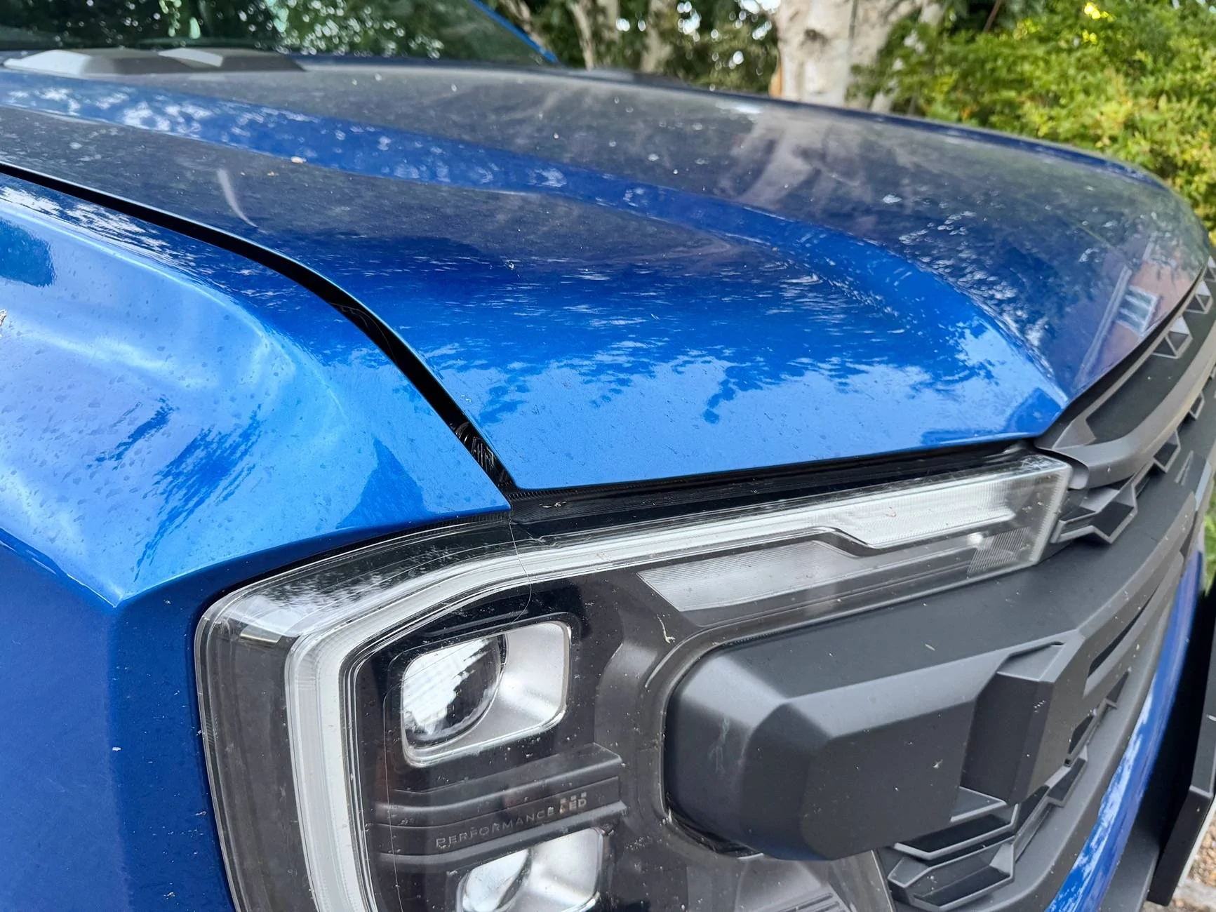

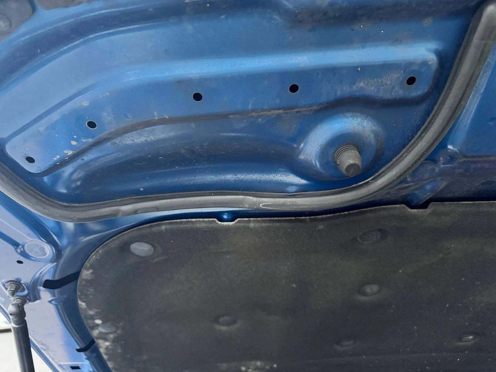

I got mine over in the UK and fitted this evening. Does anyone else find the hood doesn’t close as well as it did with the stock airbox? I think it’s the rubber on the underside of the hood where the S&B inlet sits slightly higher. Attached some pictures to show what I mean. Might trim it off a bit
No issues here. Are you sure it's seated flat in the OEM holes and not sticking up a little?
It’s the bonnet strut hitting the intake.. I had the same problem and had to get other ones that attach in different locations
