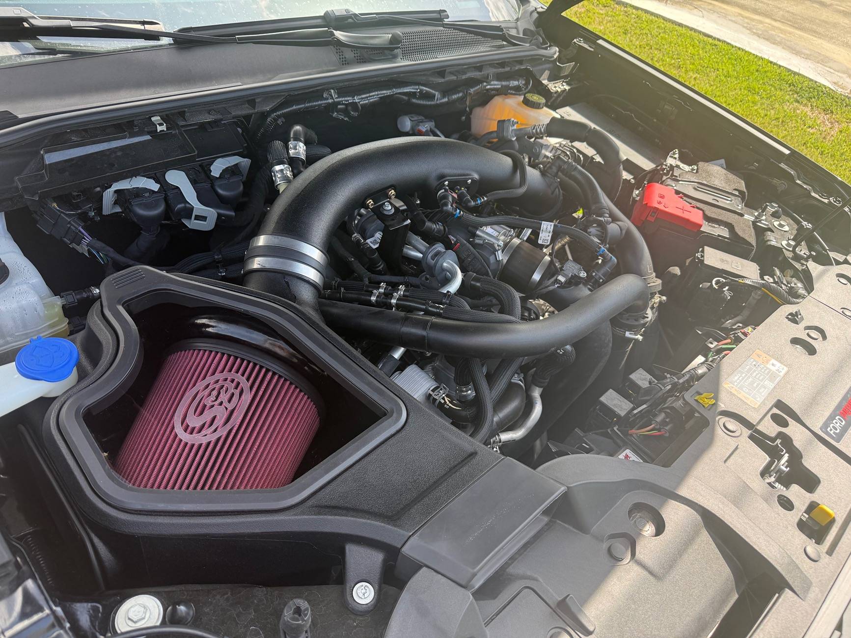

Received the S&B Cold air intake this morning and just finish the install. Instructions link that came with it are incorrect, But the S&B website has a really good video. Install took less than 2 hours.

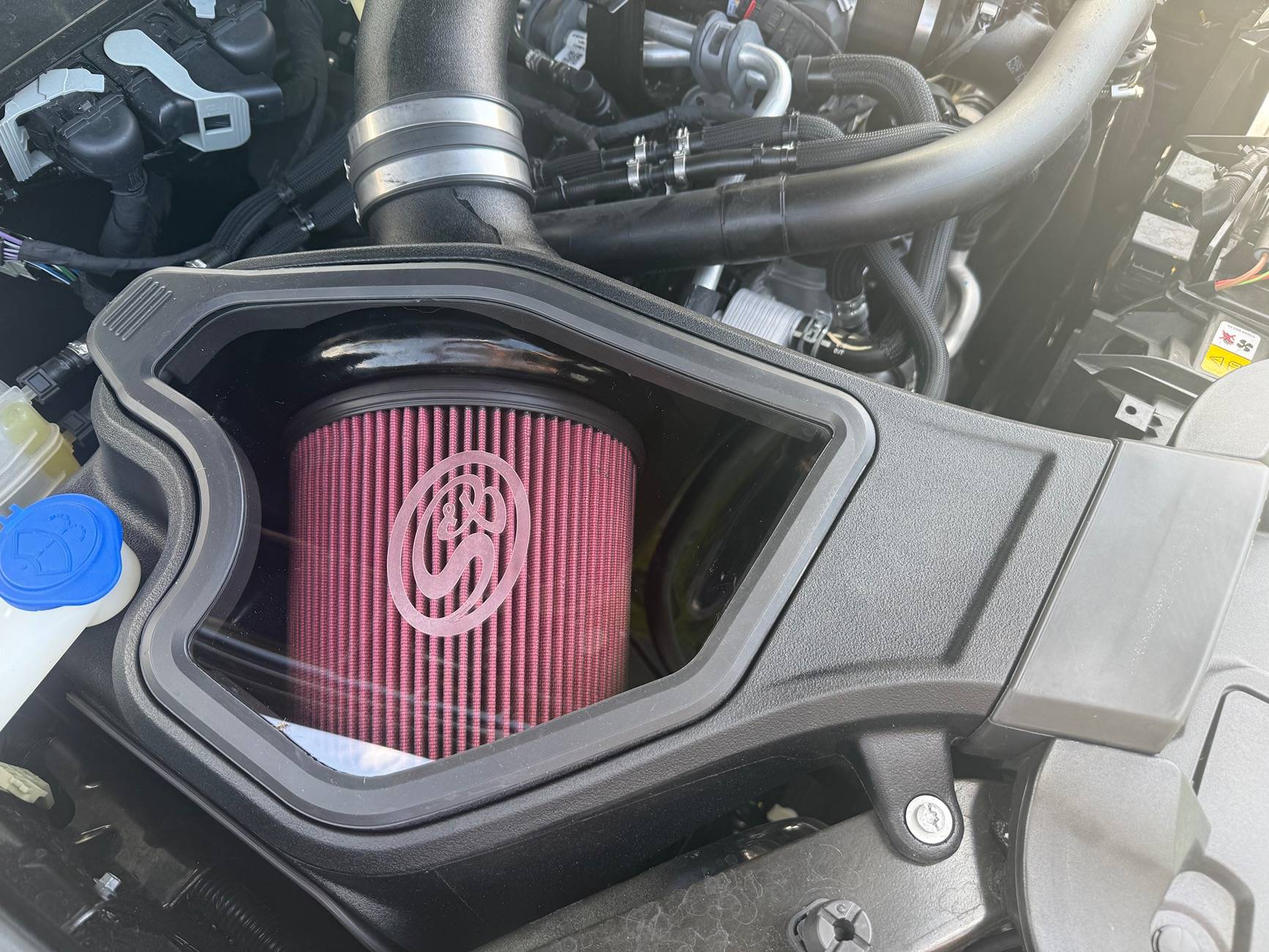

Just finished installing the S&B intake on the Ranger Raptor. Very Easy to install. Need a cool day to do some testing with the draggy. I’m looking to hit a 12.9 1/4 mile with the Procal tune installed too.

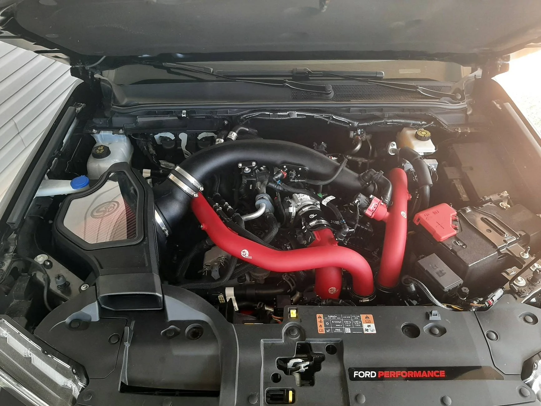

Added to the engine Bay today with AFE charge pipes in red. It was harder than anticipated. It took 3 hours and all the band-aids I own. Basically done with the truck at this point. I have 1.5 inch Bora wheel spacers, FP tune, cobb intercooler, S&B Cold air intake, and lastly AFE charge pipes. That said if prices come down on a new front bumper that could be in the cards.

Looks sharp, nice job! I was thinking of swapping out for the Cobb IC. How hard was that? Do the stock charge pipes have to be swapped out or more for looks?
Venice Raptor
Scott
Jul 13, 2024
59
Venice Florida
2024 Ford Range Raptor
The cobb intercooler installation was probably the easiest of all the components. No other changes required.

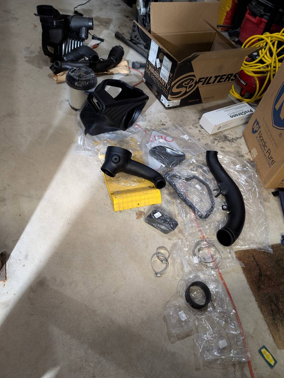

Well, I finally get around to trying to install the intake. I get everything out of the truck and start putting the new one together, only to realize the coupler for the turbo connection was not included in my box. Now I gotta put everything back to stock. Very annoying.
