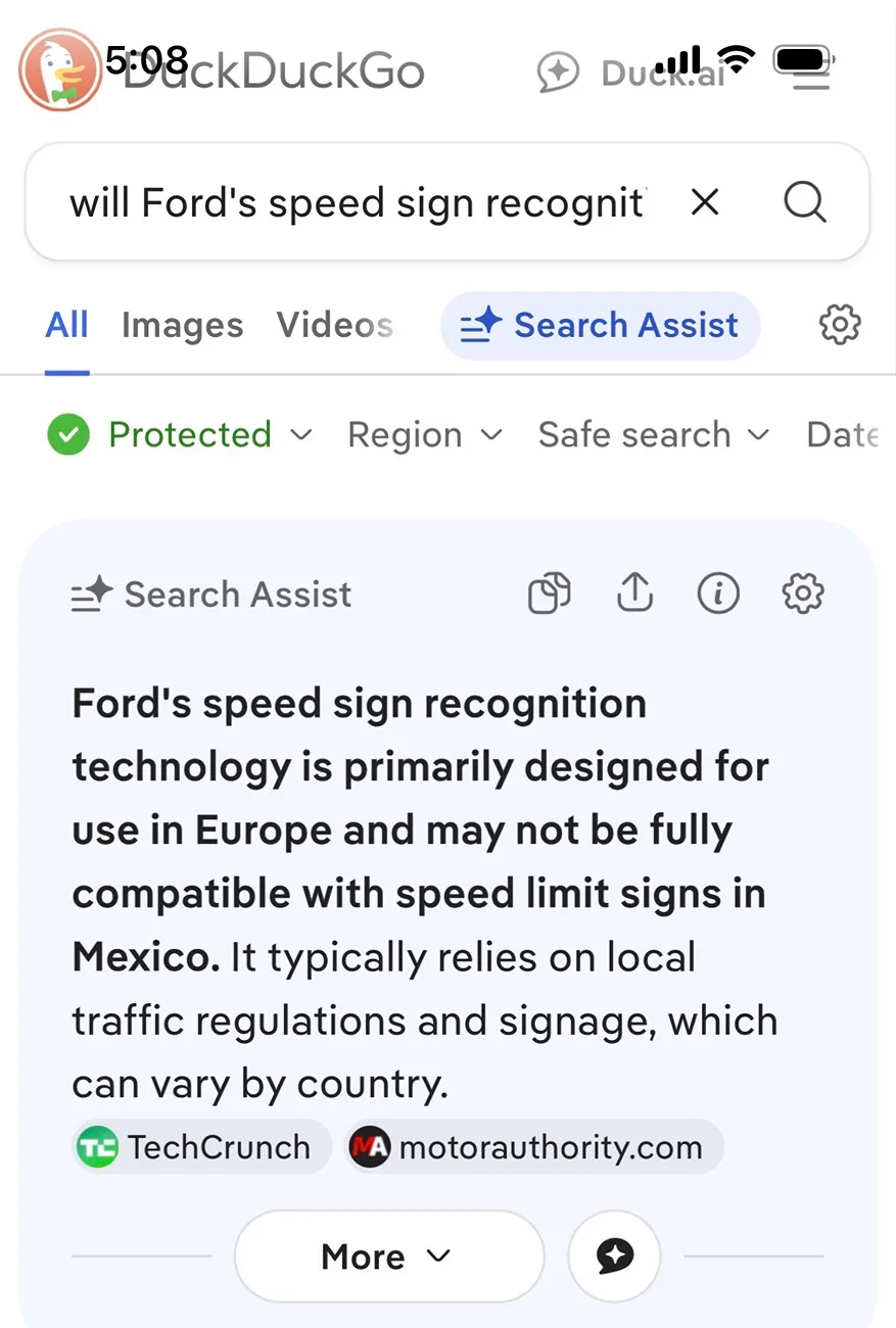

Here is the AI generated answer I got when I searched if the speed sign recognition would work in Mexico:

Looking at the MY2025 manual, the intelligent Speed Limiter section shows examples in both Imperial and Metric units so I assume it will work. You'll obviously need to switch to Metric as you've said. You could always test it out to be sure.
