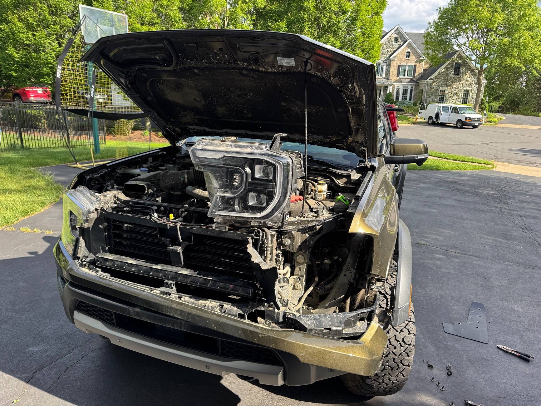

i know you are looking for Signature Lux to respond but i'll let you know that i am actually shutting down the computer to go out and try to figure out the best way to remove the headlights right now... if it turns out to be easier (less than 1.5 hours) i'll post a video because that would make this mod SO MUCH EASIER!!! Hope that helps a little bit.

It can be done but holy shit is it a lot of work!!!!!
Dang, looks like you basically have to tear apart the whole front end just to get the headlights off… Having tried both methods, which one felt less painful, removing the headlight or working in the tight space behind the fender liner?
now that i have it all back together and i'm in a calmer state of mind there are pros and cons to both... my quick answer to 95% of people is to do it through the fender by moving the liner out of the way and just deal with the tight spaces... that said, if you are confident in your ability to put everything back the way you found it, taking the whole light out is an option... now that i have done both, i think i could do it through the fender in about 2 hours for both sides start to finish... taking the front end apart (even now after having done it) would take at least that long but it would help avoid a lot of frustration of working in tight spaces.
The best answer i can give you is that if you came over to my house to do the amber light mod i would help you by going through the fender well unless you really wanted to see how to take the front end apart. Hope that helps. I did get a video of putting it all back together so you can see how all the clips work and where the bolts are that you need to get to, i'll post that as soon as my phone charges back up because in true Flaberdoopin fashion it dies at the very end haha.

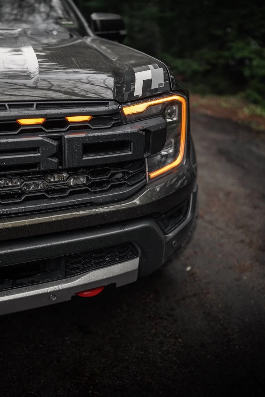

They look great! Was able to get a few photos this morning
those photos are so good! Like magazine quality! Nicely done
