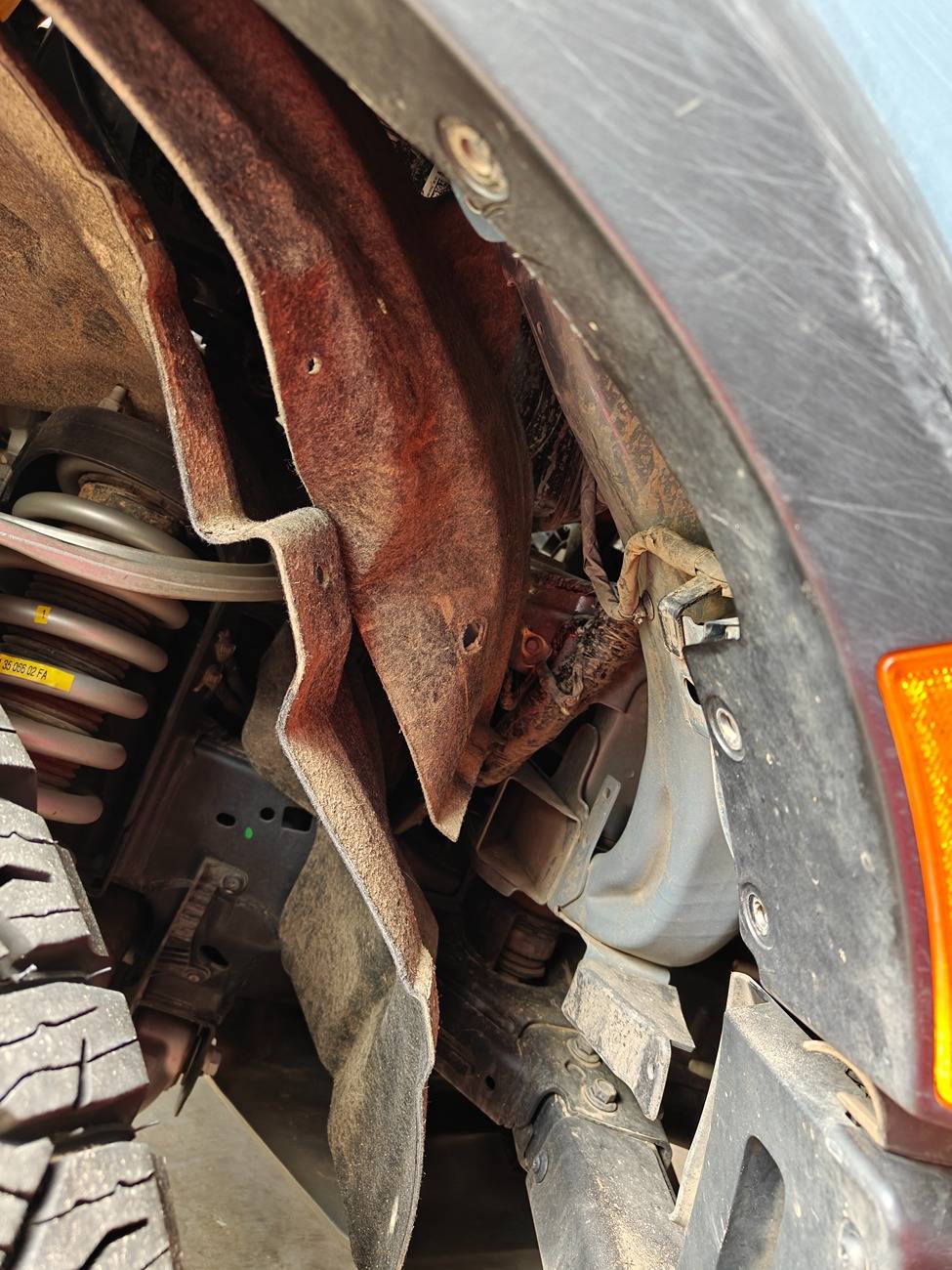

Not sure if I’ll have my video up by then but the best advise I can give is to get the flexible ratcheting bit driver they recommend. Also loosening the top of the fender is only 1 clip and 3 bolts, gives you about an inch or two of slack. That extra space is a game changer for getting your hands in to access the top two screws that hold the module as well as being able to safely remove the wiring clip!

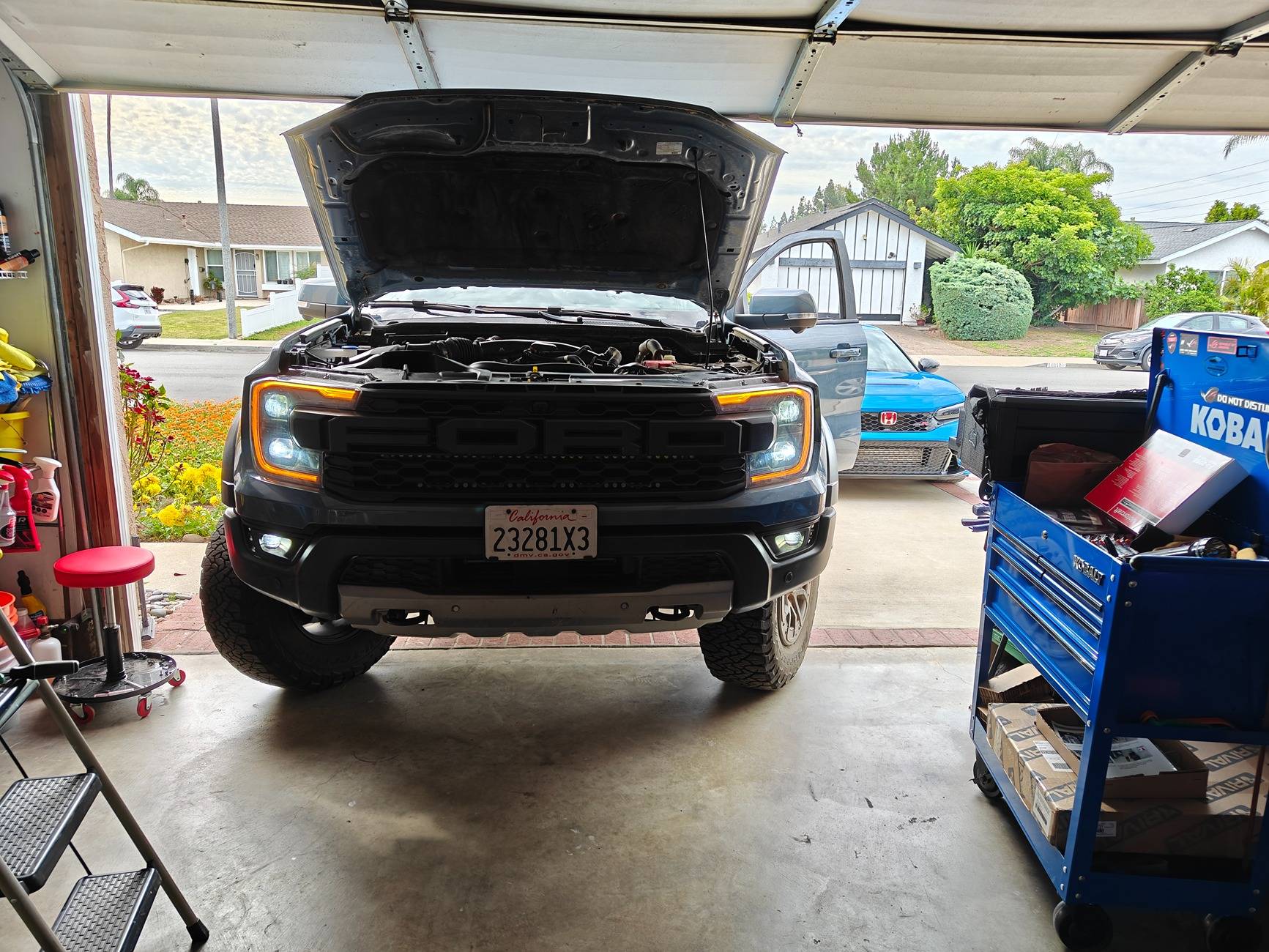

Honest review: Looks good. It works. Install was a BITCH for me solo. I still have the passenger side to do after 4 hours. Was it worth for the price and labor involved? For me it's a no but it looks nice.
