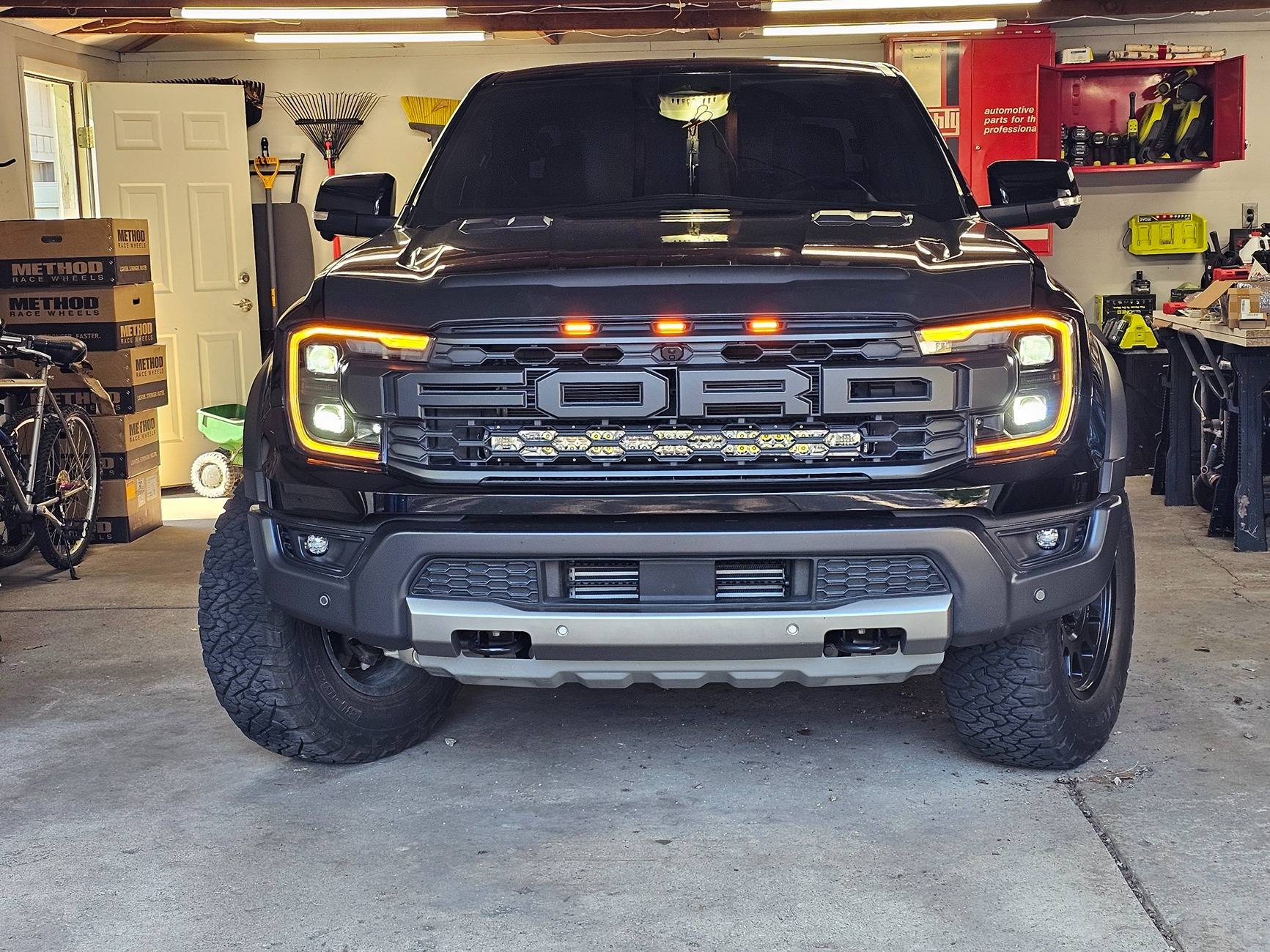

Just got mine done today. Driver side was easier for me at 30-45 mins. Went through the fender liner and loosened the top three fendor bolts.
As for the passenger side, I attempted to go through the fender liner as well, but as I'm missing part of my middle finger tip on the left, I couldn't get enough grasp on the bottom screw. I was able to go through the top fully by removing the coolant fill neck and airbox lid. I stuffed a towel in the turbo inlet pipe to make sure nothing fell in and used a flexible retreaval claw tool to hold the screw in place from the top while I used the flexible driver (the one linked from adrouin64) from over the airfilter with my other hand. It went in pretty quick that way in comparison to going through the fender liner. The pass side took me 2.5 hours.
Also, if you slightly twist the aluminum block to see the backside of the connector there is two little white tabs you can push in and up with an angled pick. My connectors came right out. Hardest part for me was the crappy plastic clips for the fender liners and the 2 bottom screws on each side.
Was 1000% worth it though.
