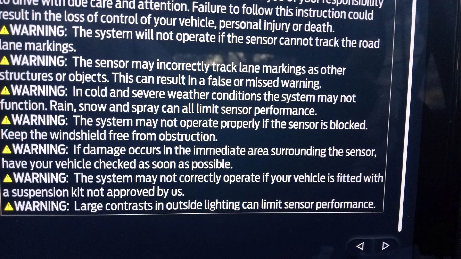

So what suspension kit does Ford approve of ?
3,743
3,535
The one they sell. My local ford dealer sells lifts for rangers, my father-in-law got one and had them install it.

Warning #6
Using forscan you can zero out the settings once you've completed the lift. You can also adjust tire circumference for correcting the speedometer. Works perfectly.
