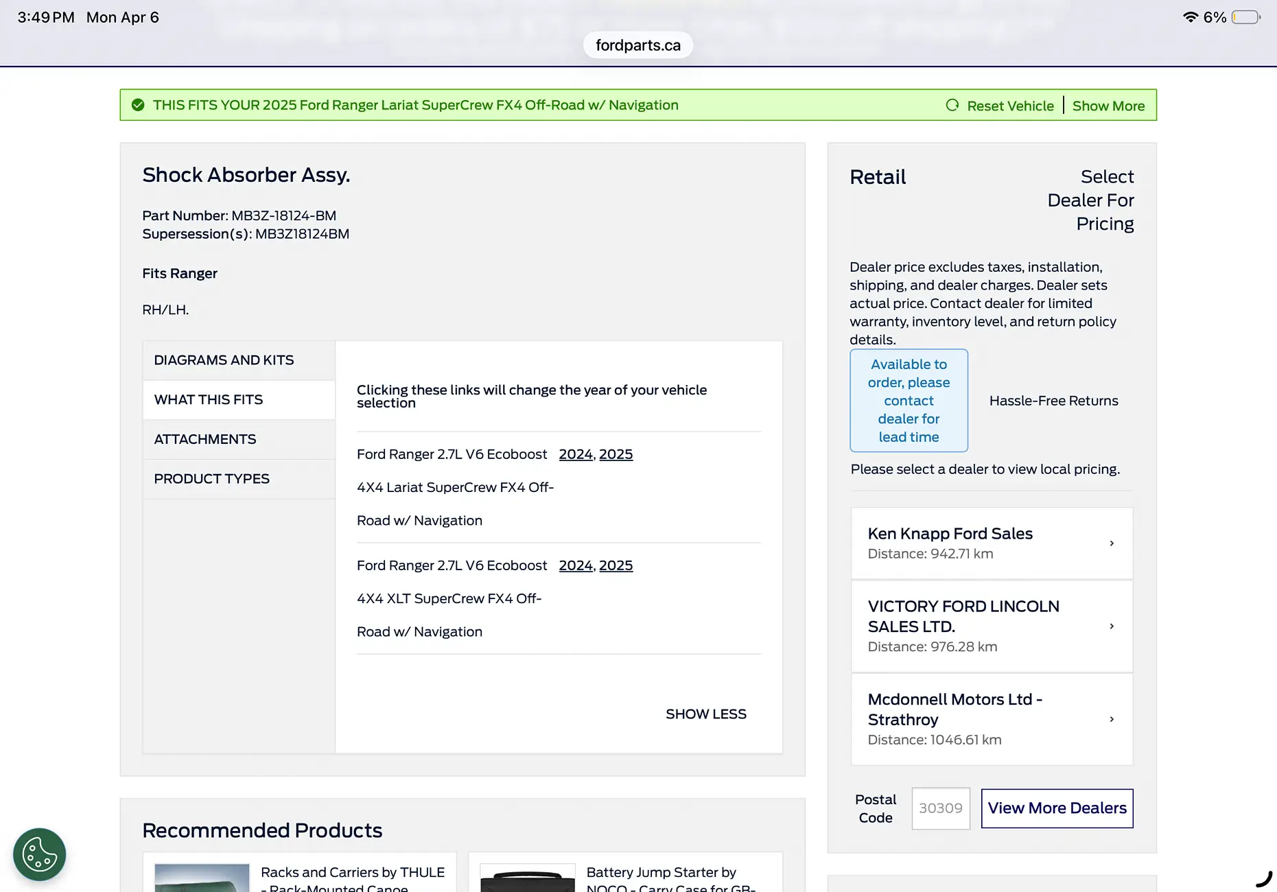

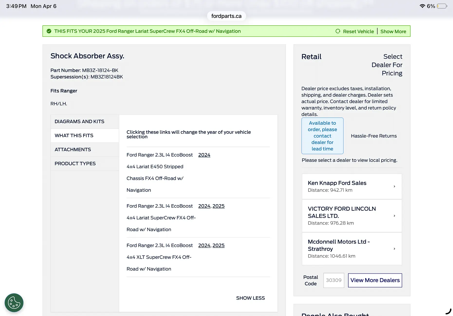

It’s interesting that ford Canada implies that the fx4 lariat 2.3 and 2.7 have different shocks vice the Xlt or xl fx4
Ford Ranger FX4 Suspension package.....what do you think? IMG_3759
Ford Ranger FX4 Suspension package.....what do you think? IMG_3758

I am just curious what the differences really are in the suspension. Devling into the vagaries of the ford parts databases it looks like the springs are the same. But the shocks are different.
