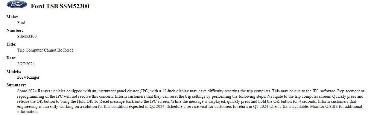

Trip 1 odometer won't reset. Shows miles and hours since it left the plant. I now know how to fix it after finding the solution on another site, but like the "problem" for now and use trip 2 for my other needs.

On your trip 1 reset issue - could you please provide a link to the solution. Mine eventually resets after multiple attempts - so hopefully your solution would fix my reset issue. Thanks.

There is a TSB for this issue. I happen to like that I can easily see the number of "hours", not just the odometer on Trip 1. It currently shows the number of hours the vehicle has been run since it left the assembly line. I know a service tech can look this up if service is being done, but I plan to keep the so-called problem for now.
