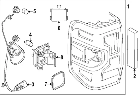

I have a 2024 Ranger XLT. My tail lamp housing was damaged recently and I've been looking into replacing it. Ford isn't selling just the lamp housing, but requiring you buy everything in the photo attached, including the blind spot sensor. I'm curious if anyone knows if the blind spot sensor can be removed from my current tail lamp and installed on a new lamp or, if not, does a new blind spot sensor require any recalibration or programing?

I'm guessing it probably won't. Harder step to remove the lamp unit is unsnapping while pulling back to remove it. It's secured by two bolts, take no more than 5 to 10 mins.
As far as calibration for the sensor, don't seem like a component that would require any specific or specialized measures after replacing it. But these days it's all about stealerships making money.

I had to replace my tail light in my lariat last year. Bought a "used" tail light from eBay, swapped my sensor and bulbs over. Took maybe 10 minutes. Saved a few grand. No programming necessary, works like new.

That's what I was hoping to do. Get a new housing and swap all the electrical components over. I'm glad to hear that you didn't have any issues.

I don't think there's calibration involved, but a BLISS unit from another truck wouldn't 'just work'.
IIRC, BLISS modules are programed to VIN.
You shouldn't have any problems if you are just swapping the module from your old assy to the new.

They both got replaced under warranty. They had to re-calibrate the new sensors and now they are a lot less sensitive, meaning vehicles are a lot closer and in my blind spot before I get a warning in the side mirrors. Before the swap, cars could be further back and technically out of my blind spot before the warning lights triggered. I preferred the original calibration, but they work as intended. Still worth not having water intrusion in the tail lights. Lots of car washes later and insides are dry.
