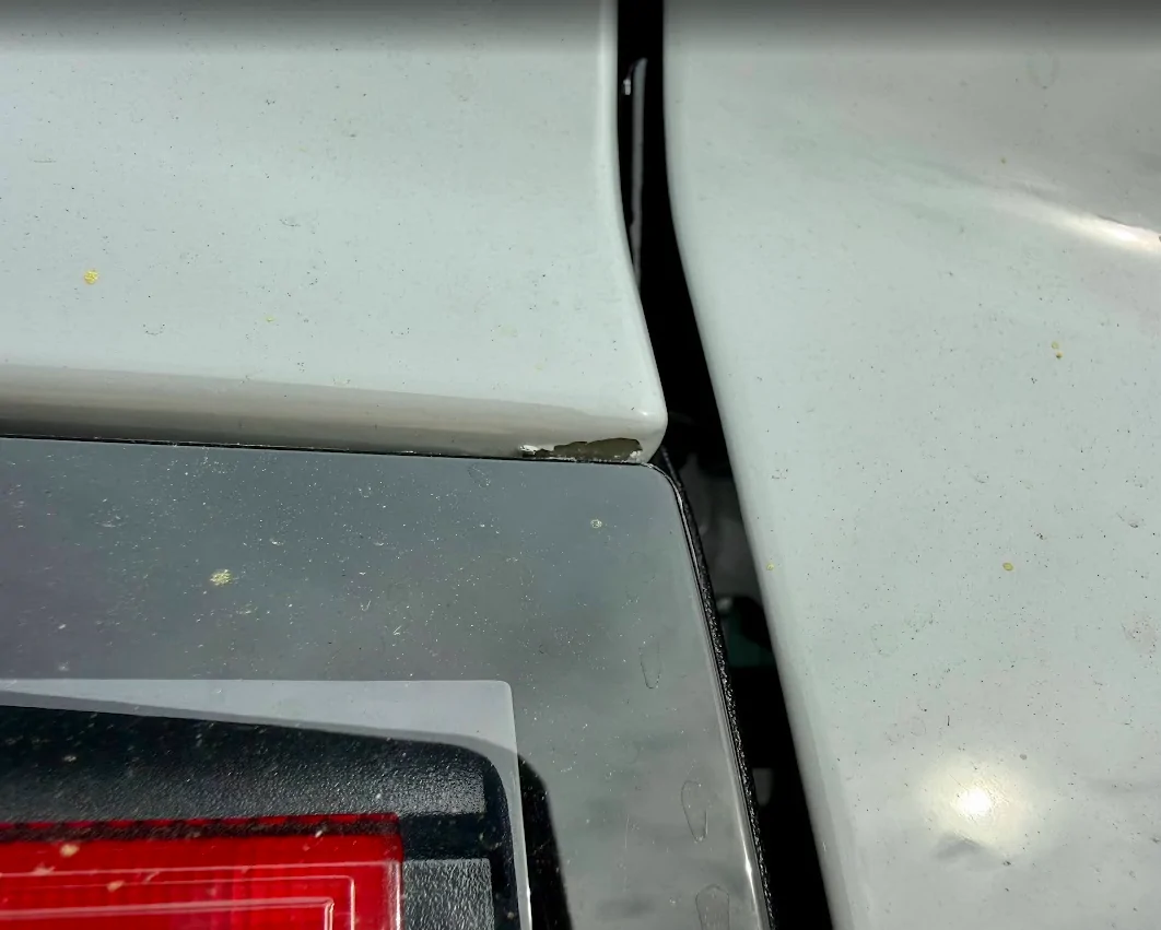

I looked at a couple of new Ranger Raptors on my dealers lot and here's the picture of them, no paint chip. I took mine in and had them look at it. They took some pictures and they're sending them to Ford to see what they're gonna do about it. We shall see....

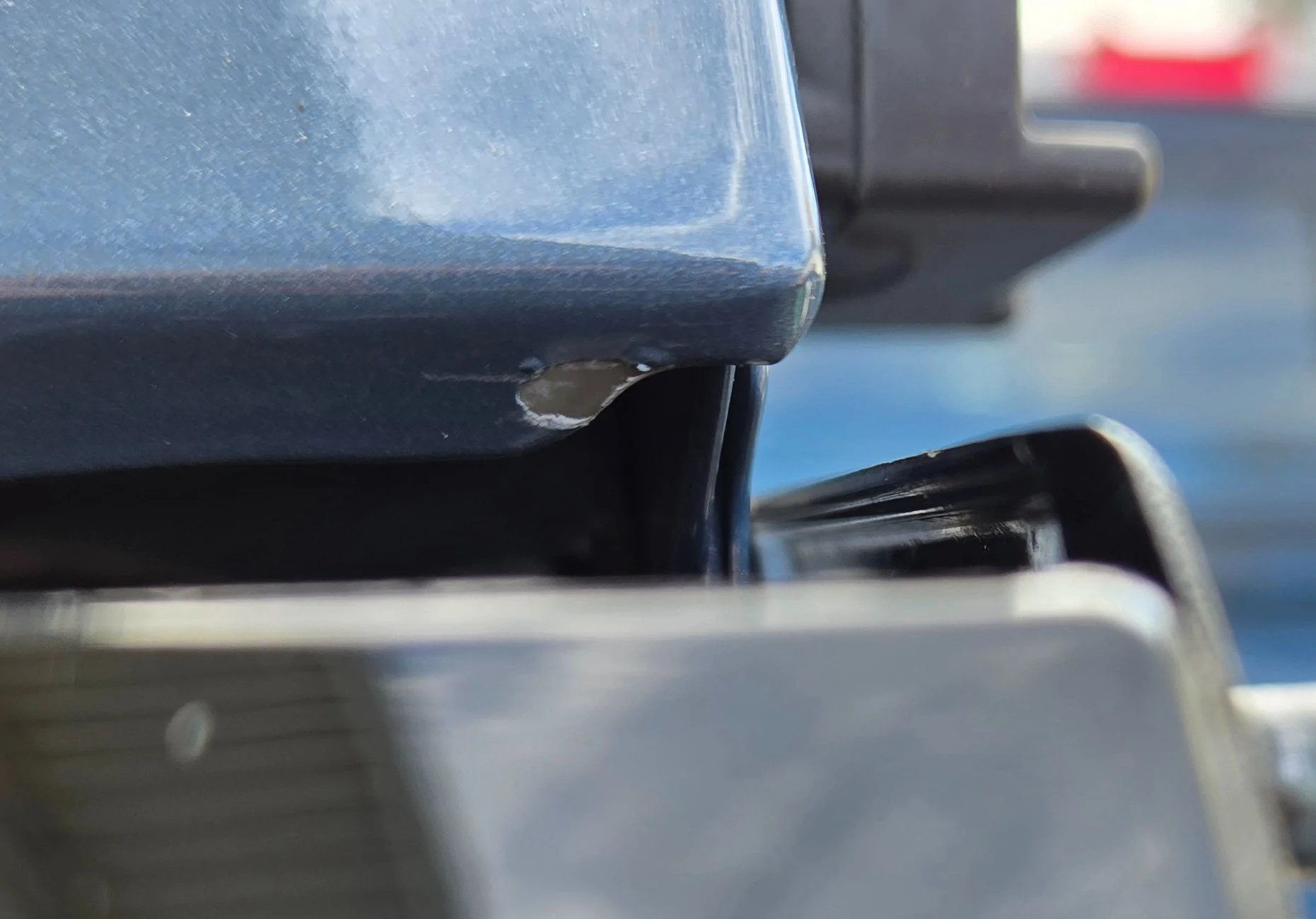

Just checked my 2026 (with less than 500 miles on it)... apparently Ford has done nothing to fix this issue :rolleyes:
Passenger side is fine

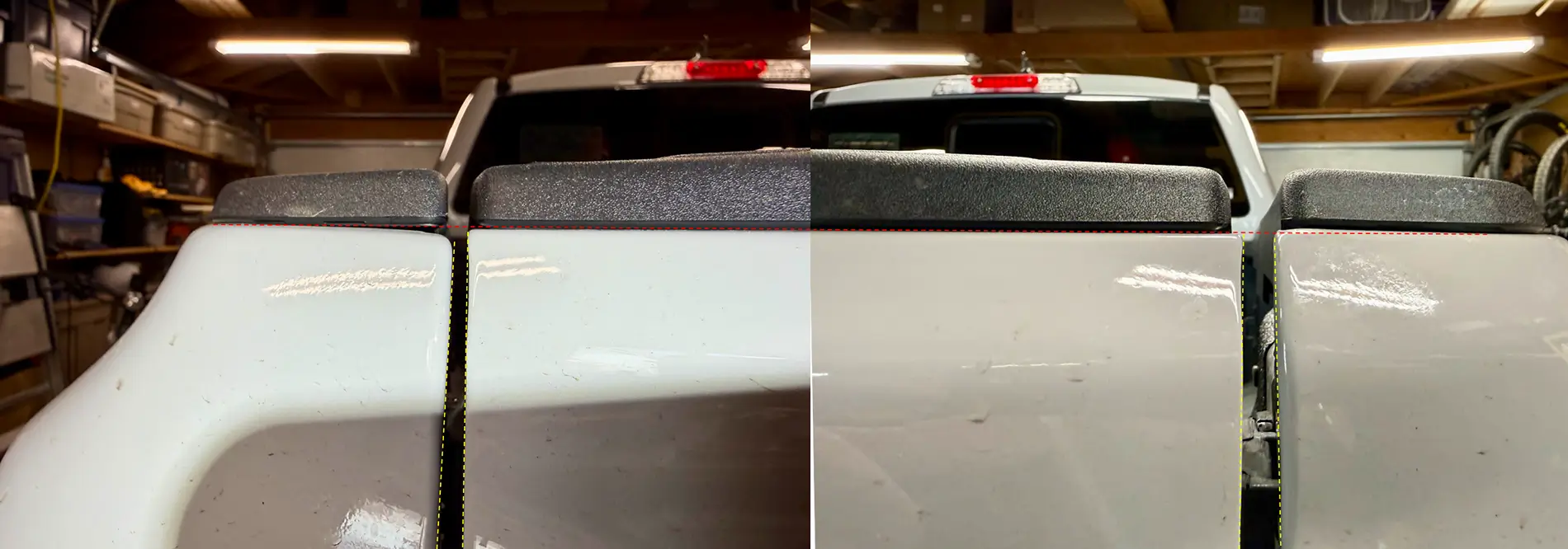

While doing my tailgate seal yesterday I noticed that the gaps with the tailgate were inconsistent, and the body panels on the driver and passenger side have different angles. Pretty piss-poor QC, and amazing that this has been going on for over 2 years and Ford hasn't fixed their manufacturing. Seems like a jig thing to me

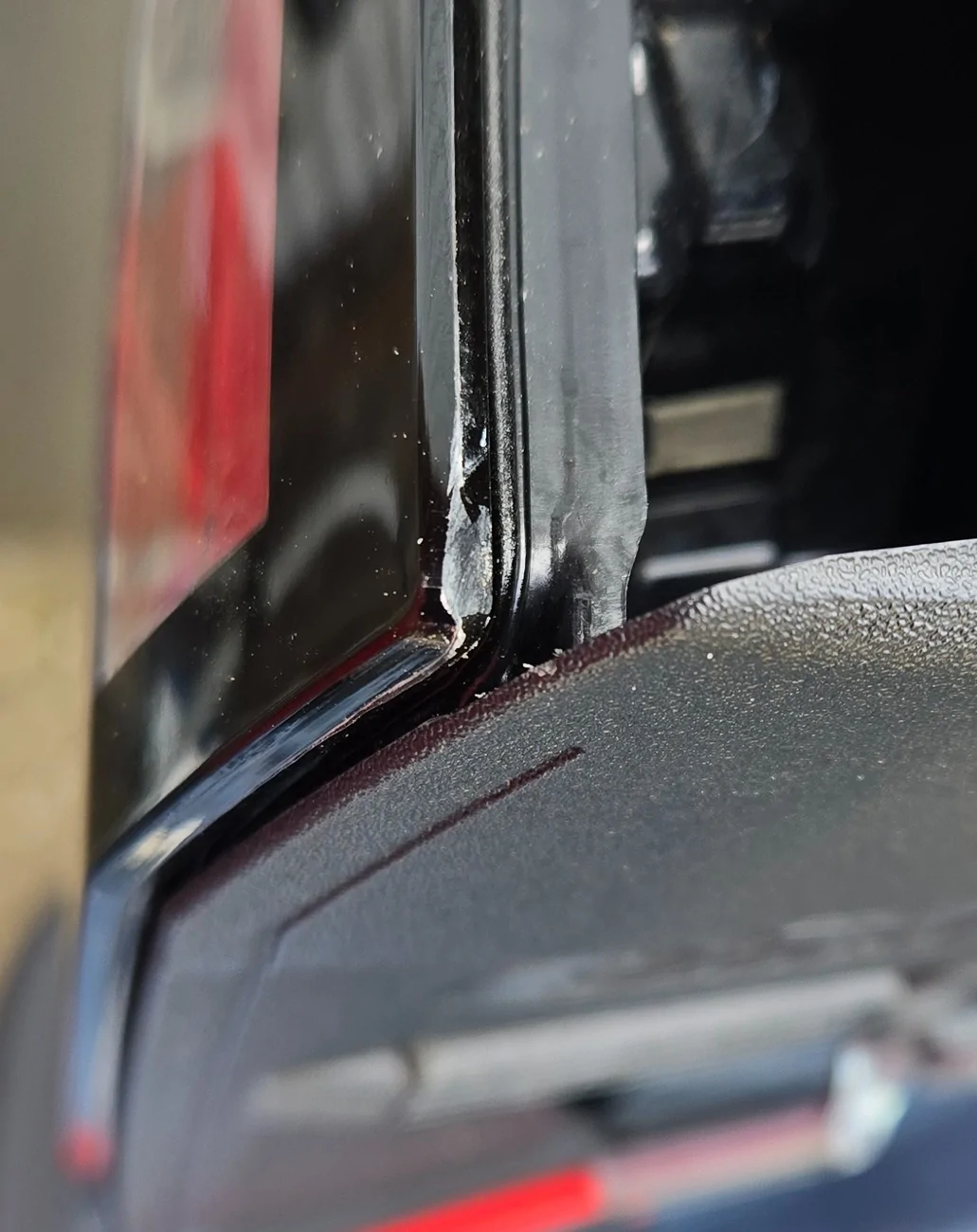

I didn't think I had the issue... But...Today I removed the taillights to remove the bed rails, there it is.
I took a sharp file and dressed the edges of both taillights so they don't rub.

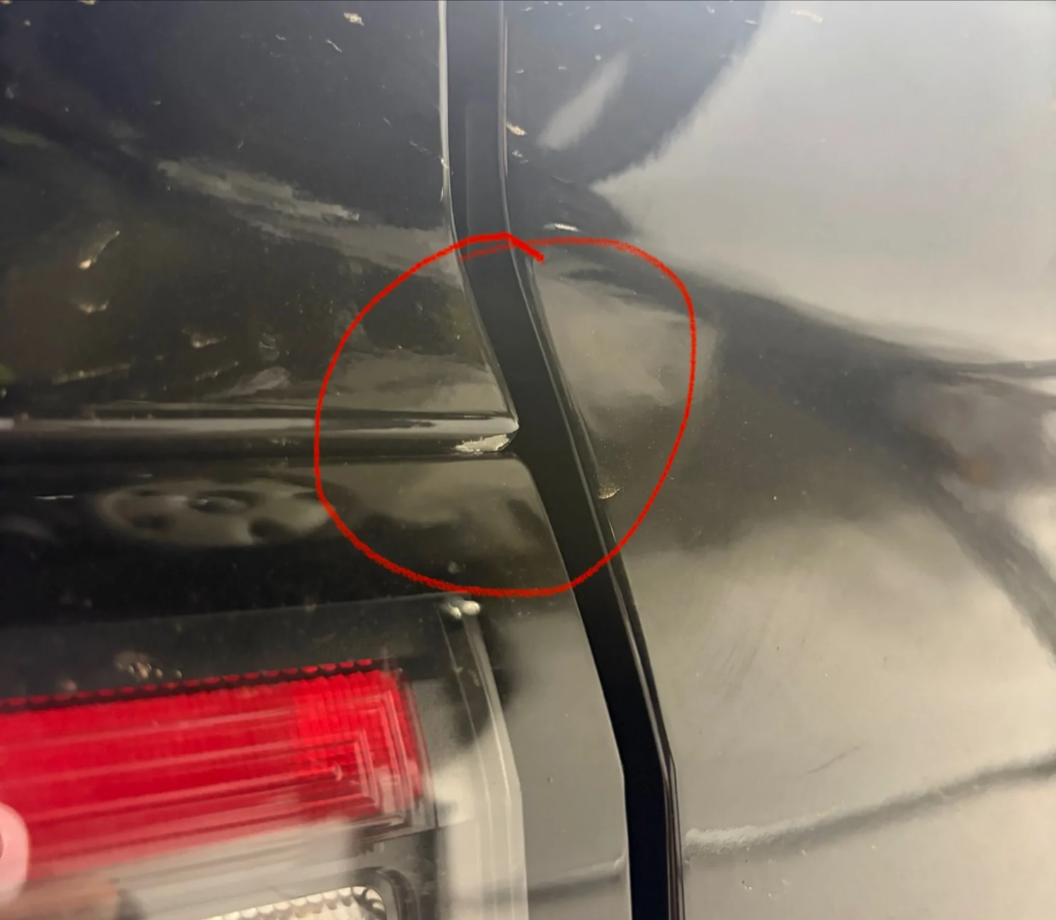

Drivers side and same chip. Knowing my local dealer there's not a chance they will cover this. I had to drive 1.5 hrs away just to find a dealership worth talking to and that's where I bought mine.

While I had my Ranger Raptor in for something else, I had them ask Ford about our paint chips (my wife's and mine RR,s both have it). This was like the third or fourth time we brought it up to our dealer when we had them in for service. So Ford did agree to fix the paint chips this time. The only problem is, Ford will send it to a body shop to fix it, and body shops do not fix paint chips. They will paint the whole Fender. I don't want that. I had my wife's ranger paint chip fixed at a coatings place where they put ceramic and PPG (or whatever it's called) coatings on vehicles. They know how to do touch up paint chips better than any paint shop. That's where Im taking mine to get it fixed.

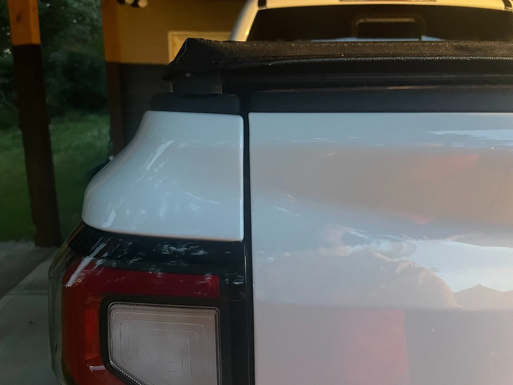

After reading about this issue here some time ago, I checked mine. Mine was touching but not chipped.
I filed off a little bit of the plastic to make clearance. Potential problem solved.
