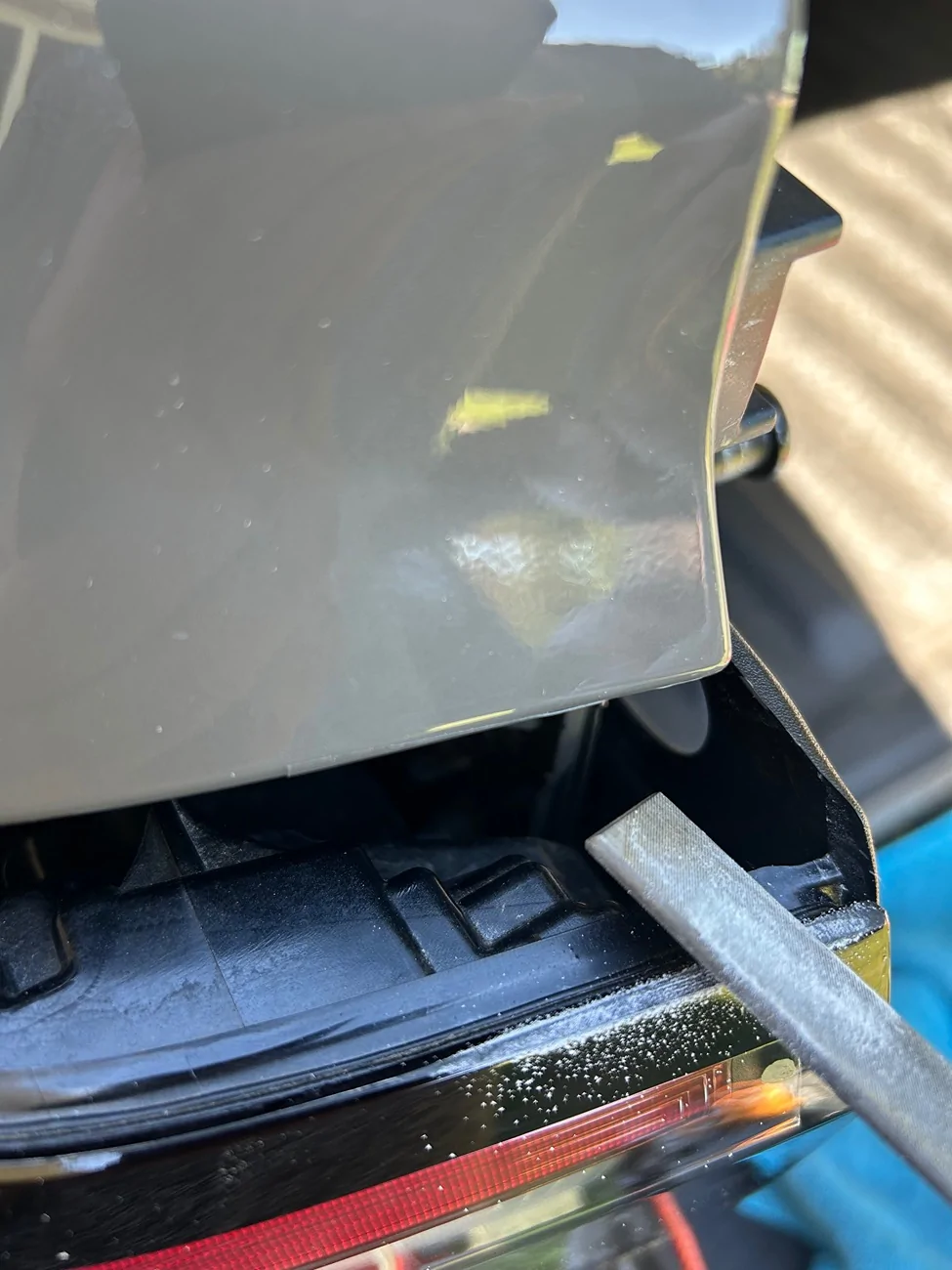

I finally checked mine today, yep, same paint wear. How do you loosen the tail light assembly to file down a little of the plastic?
I'd advise talking to the dealer first since you got a brand new one like me.
I think Ford should have a go or two at correcting this before I have to resort to filing down an expensive new tail light.

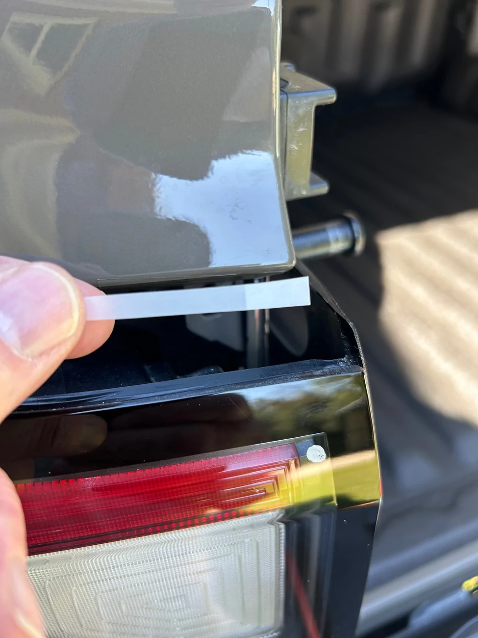

No chips, but I was not happy how close the TL tolerances were after checking both tail lights with a C/C for tolerance… too close! So like others, I removed the taillights and used a fine file to bring both top edges into specs I like. I took off about 1/16” on both. All good now. You can measure thickness with at C/C.Take your time and you will never see its been filed, the plastic light housing is robust. And after filing, It cleans right up. I billed myself 30 min labor.😎
I had some XPEL PPF in my shop and attached a small strip on the painted area where rubbing could be of concern. Probably not necessary, but it can‘t hurt.
This reminds me of why I had the entire truck covered with XPEL PPF. The paint on new vehicles is too dam thin thanks to the EPA.
