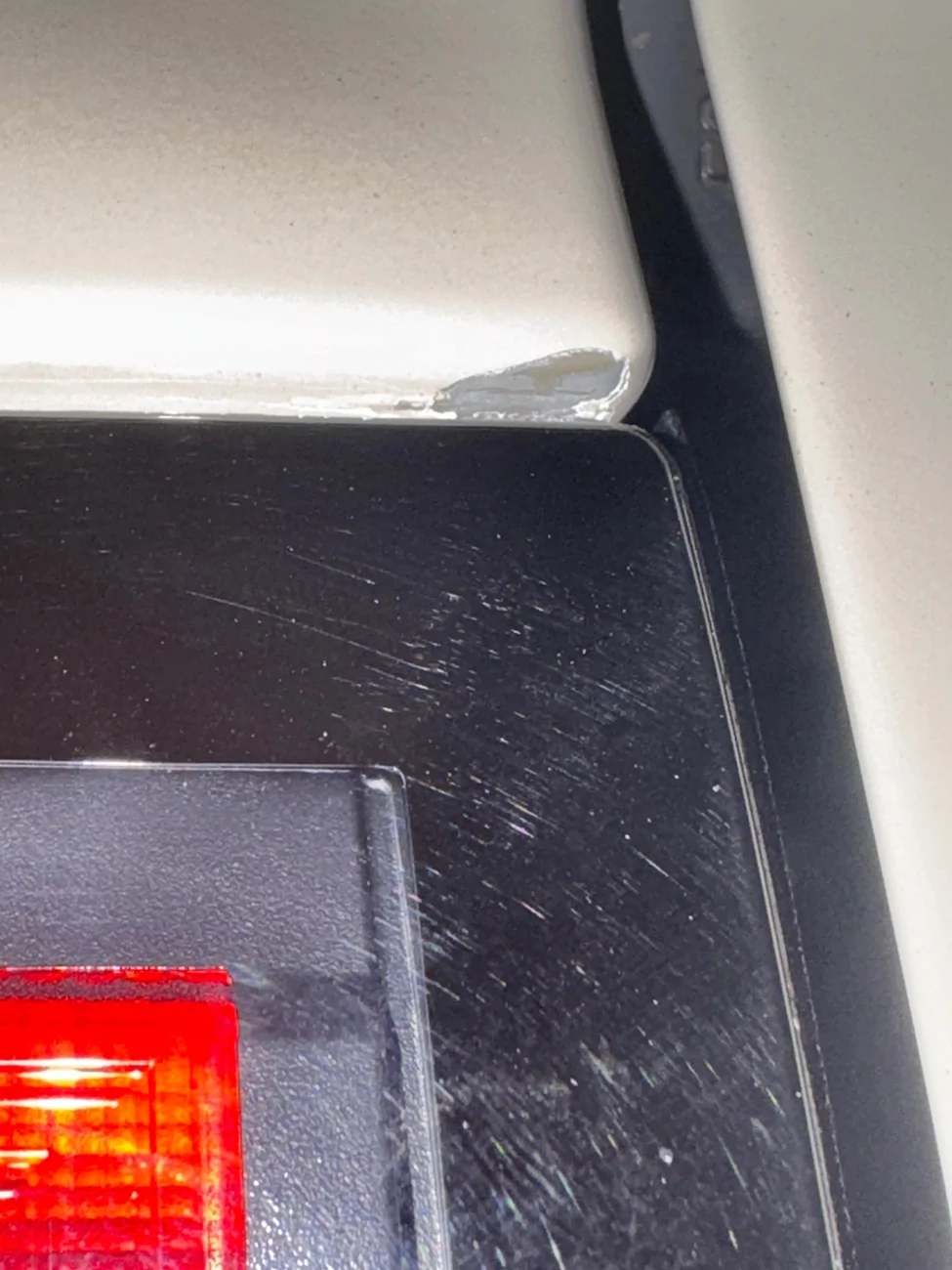

The Ford collision center had my truck for a week and made some sort of tweak and touched the paint up. It had a paper thin gap when I picked it up. It moved within a couple days and I figured out that they barely tightened the top bolt. They believe that my fender was manufactured improperly and said that if this didn't work they would have to replace the whole fender. I would rather not do that if I can. Mine is touching at the top inside corner and lower outside corner at the same time. I did find that you can pull it out a little and add plastic shims around then tighten. The shims prevent the tightening of the bolts from pulling it in or up (Then remove the shims once tight). I have 1/32-1/16 gap on top now and a paper thin one on bottom so I just slid a small piece of ppf at the rub point.

My 300 mile RR has the beginning of this problem as I can see primer in the location. So to stop this rubbing, I removed the tail light and removed some material from the contact location. Then, since I have shelter green, a flat black paint was used to hide the exposed primer. Reassembled and see there is a good clearance now.

How much plastic did you remove? I was afraid of damaging the light and Ford voiding the warranty. Those things are $1500 each! It looks like the tail light moves about 1/32" when the body flexes during driving.

It wasn't much. Maybe that 1/32nd. Also, only material from behind the facing, polished surface.
The picture does a good job of capturing the area, and looks less noticable looking down at it. Once I hit the area with some Chem Guys stuff, it won't be noticable at all

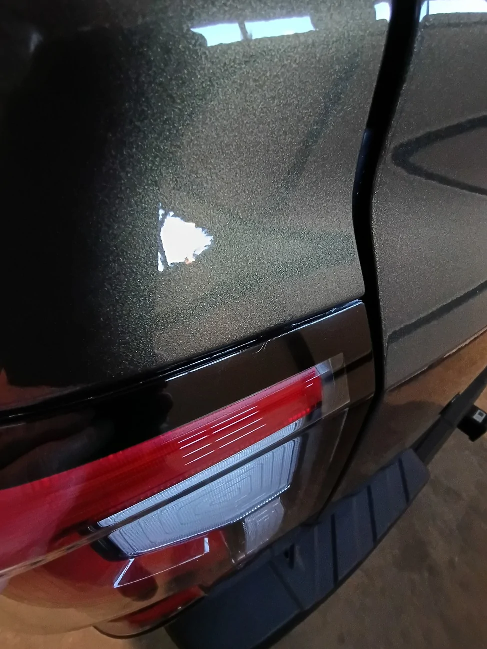

Ford Ranger Paint chipping above the tail light IMG_20251111_152940524
Maybe this picture looks better. The area has been hit with the Chem Guys quick detailer.

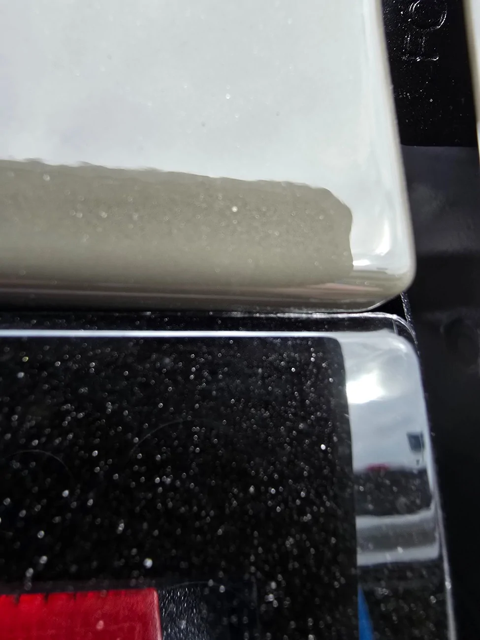

Ford Ranger Paint chipping above the tail light IMG_20251111_155956680

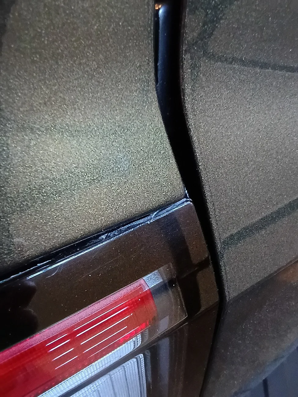

Exact same thing. 2025 with 170 miles. Same paint chip.
That’s rough! The dealer collision center halfway touched up my paint and remounted it after having it a whole week. It moved after a few days and I realized they didn’t even tighten the top bolt. Last weekend I took the light back out and applied 5 coats of paint and one of clearcoat and let it dry overnight. I made small plastic 1mm thick shims from abs plastic. I pushed the light back on and put the shims around the light especially where it was touching (for me it was top right and lower left). I slowly tightened the bolts and the shims prevented much movement. I am a week since the install and it is still good! I believe that the taillight pocket is too small on some of these trucks, but if you don’t push it in too far and prevent it from moving while tightening the bolts it’s good enough and shouldn’t touch.

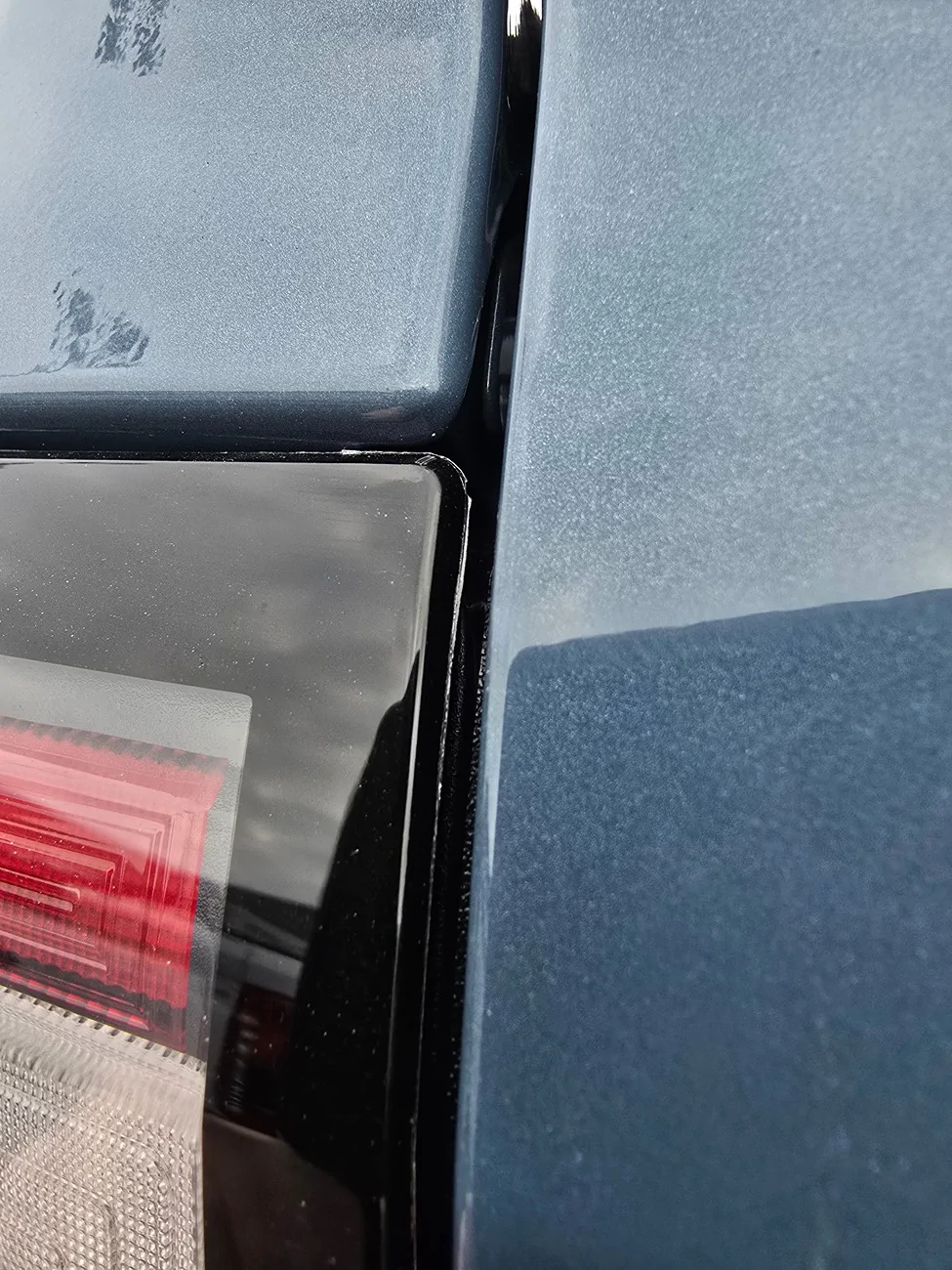

I looked at a couple of new Ranger Raptors on my dealers lot and here's the picture of them, no paint chip. I took mine in and had them look at it. They took some pictures and they're sending them to Ford to see what they're gonna do about it. We shall see....
Ford Ranger Paint chipping above the tail light 20251217_112251
Ford Ranger Paint chipping above the tail light 20251217_112309
