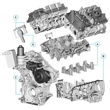

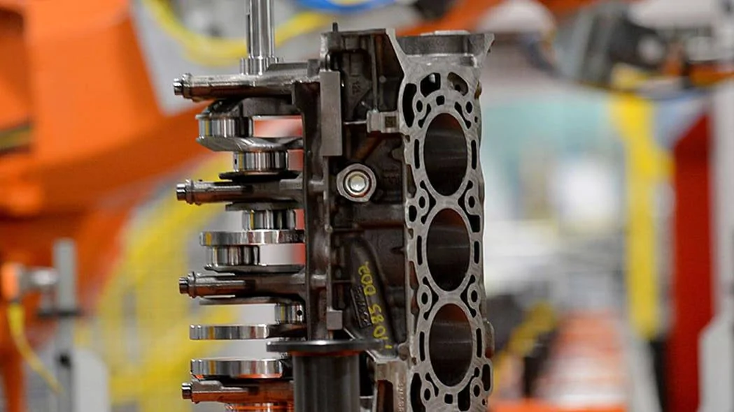

I made a mistake on the output. Looks like it will be 400 Hp for the 3.0L. The NA PHEV will be with the 2.3L Eco Boost.
We will have to see if the Ranger will be offered with the 2.7L like the Bronco.
Here's some info on the 2.7L. The 3.0L is a punched out 2.7. The motor does have a IFC, but the water pump mounts into it separately.
It has direct and port injection which will wash the valves reducing carbon build up on the valves.
