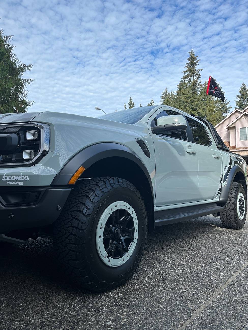

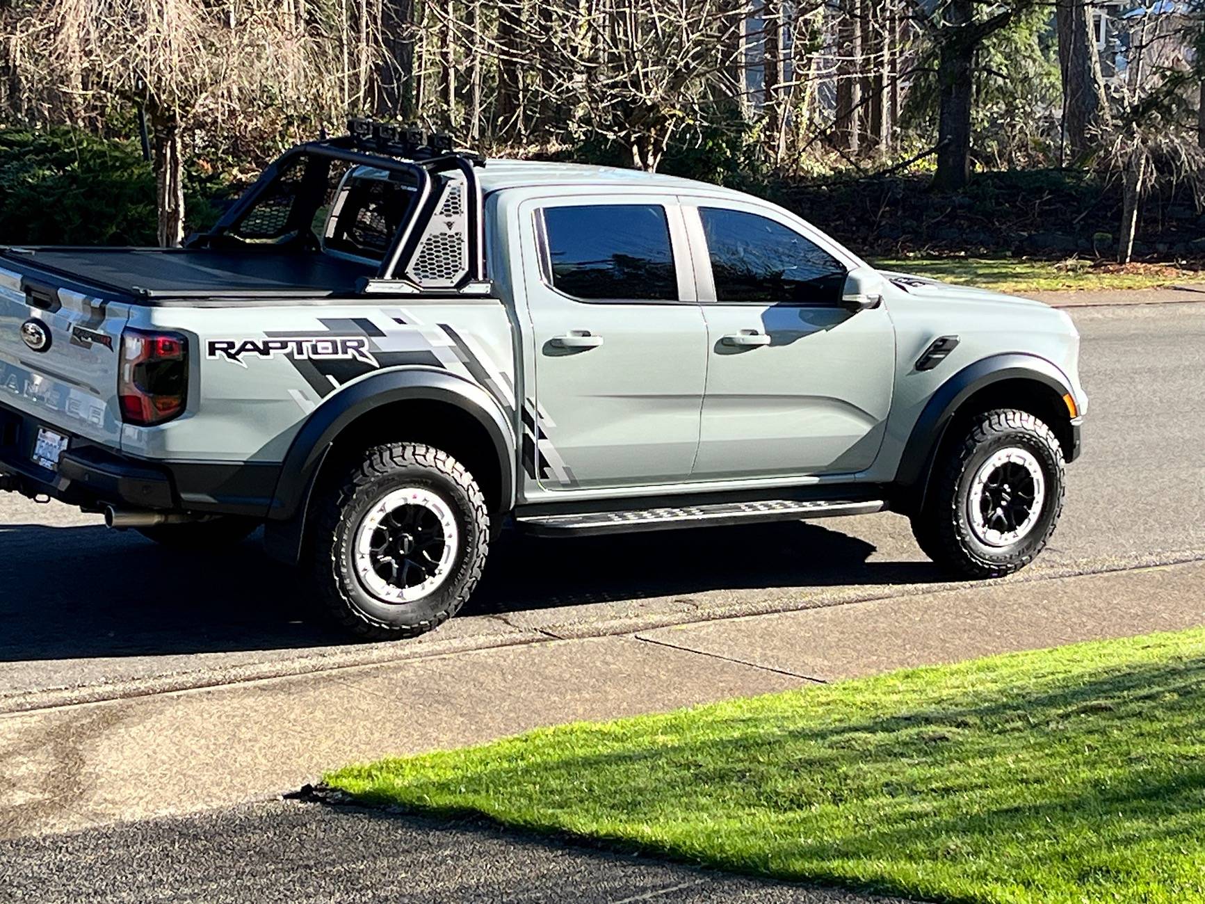

Not for all I’m sure! But what is? Ent to white rings for a change, little switch up and I can always go back to the cactus.

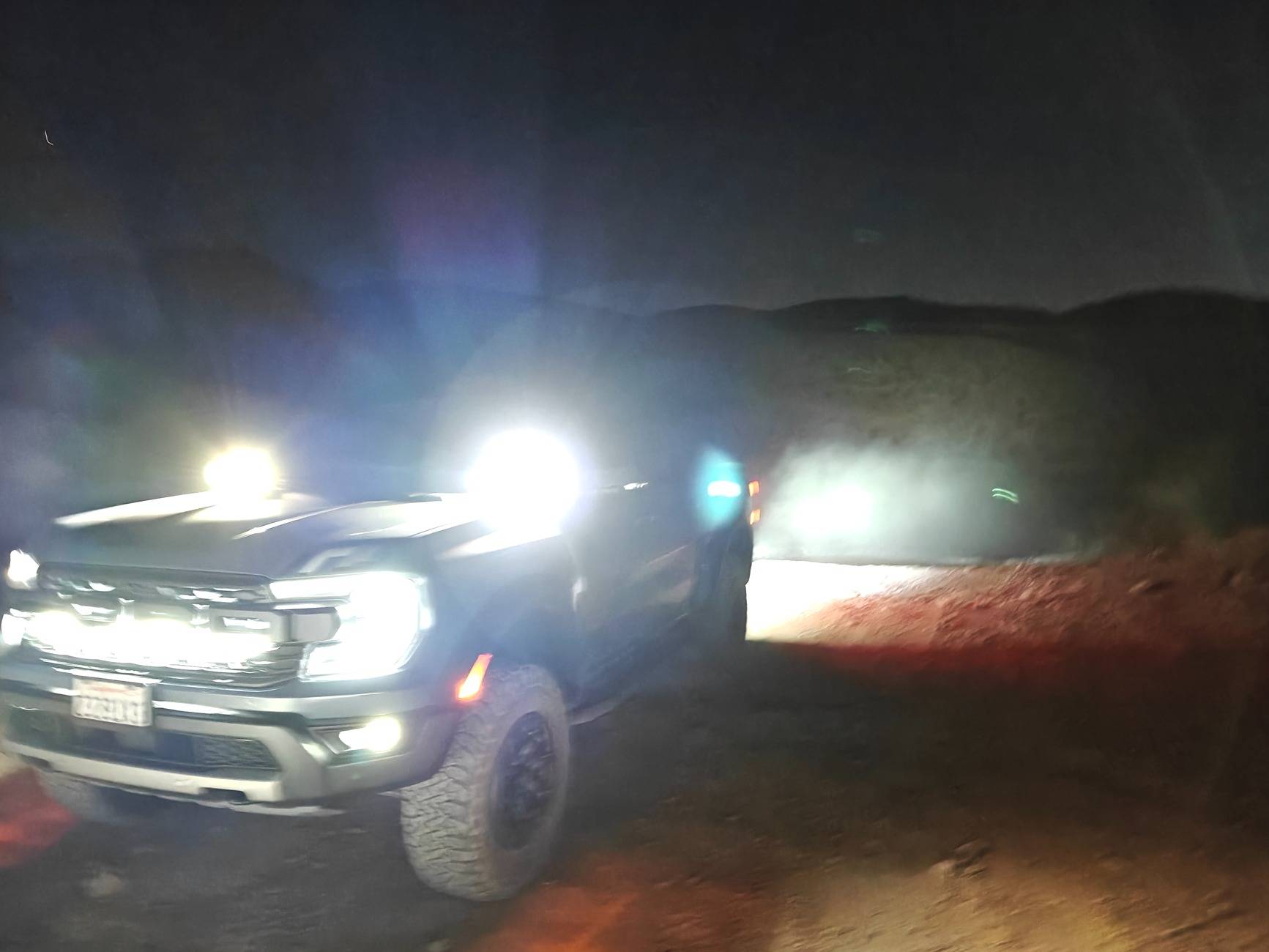

I installed a pair of Rigid D-SS Amber Spot Lights using the FSE Brackets. (Then of course had to go test it off road at night :D)
I like them a lot, gives off a lot of light but no glare so it'll be good in dust or fog- The Signature Lux fog lights just arrived last night so I'll be putting those on next/

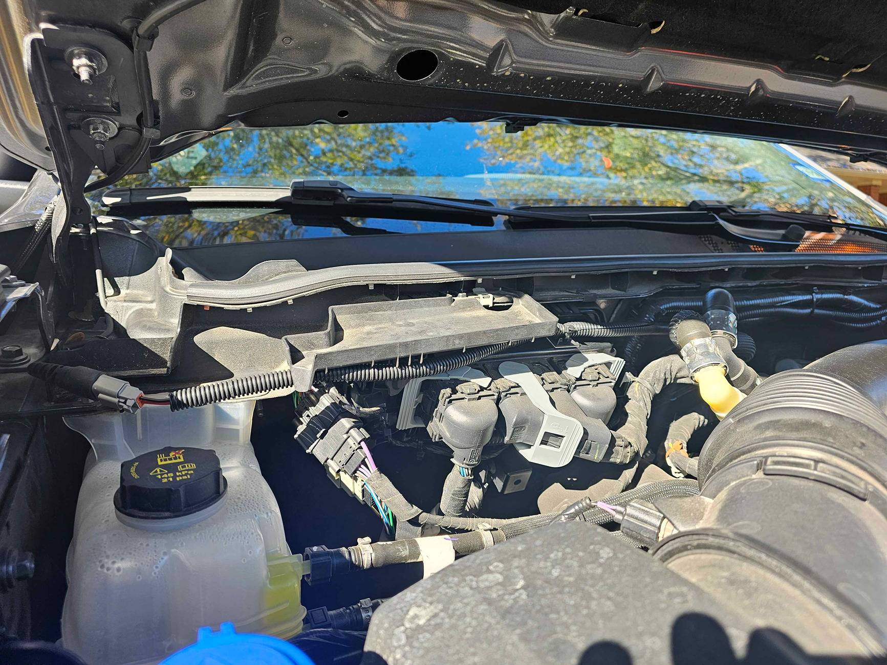

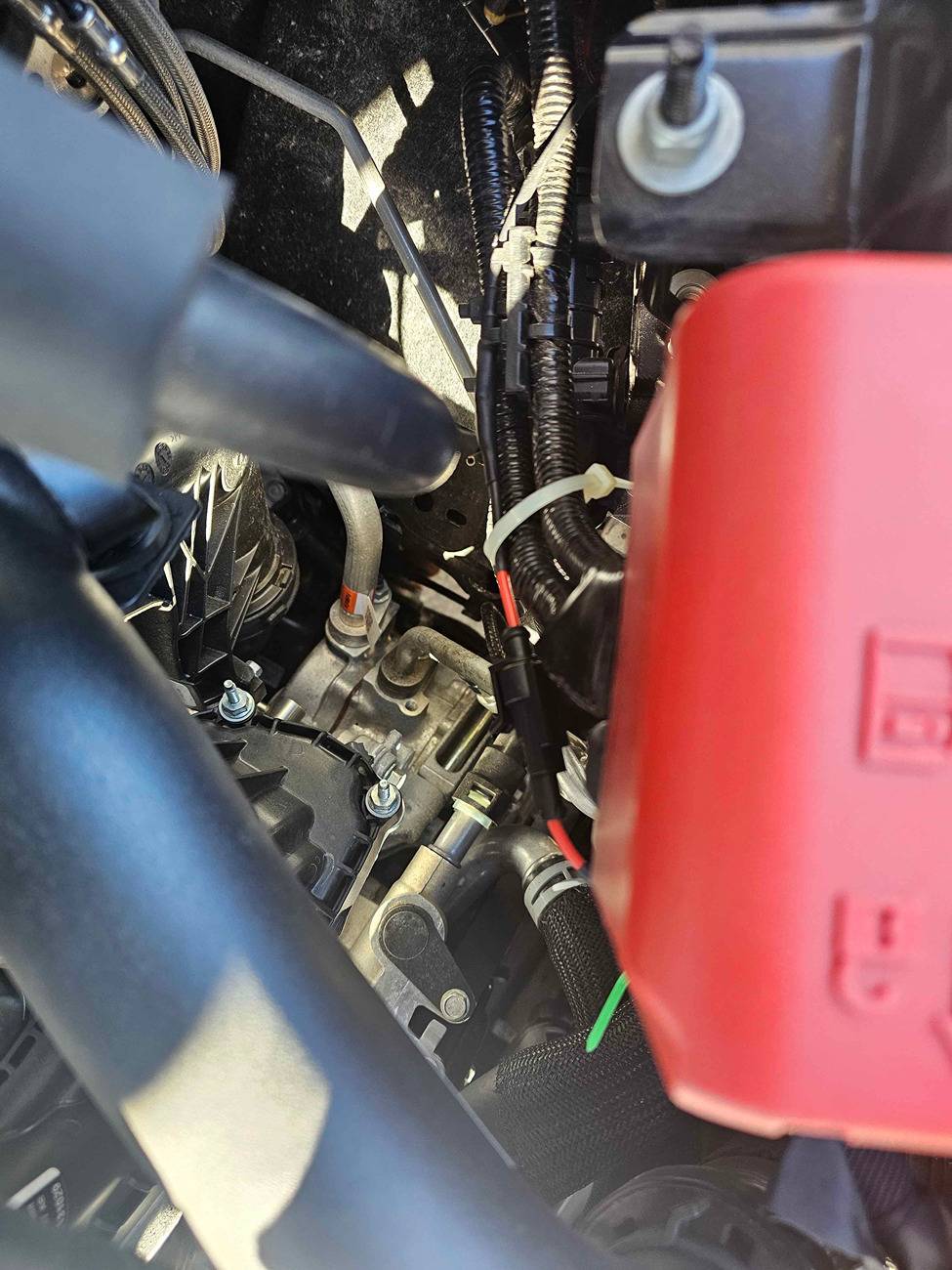

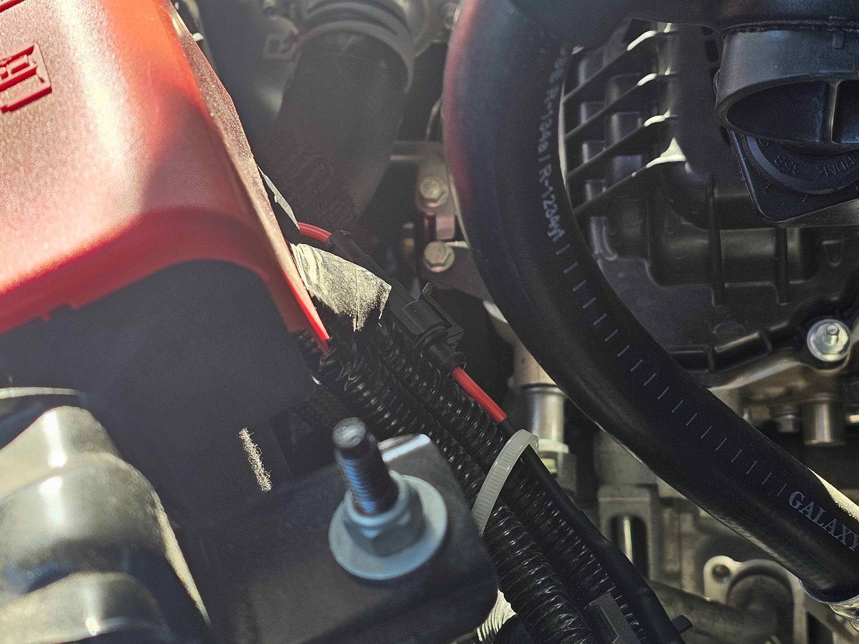

Sure thing- This might be a bit of a Photo Dump.

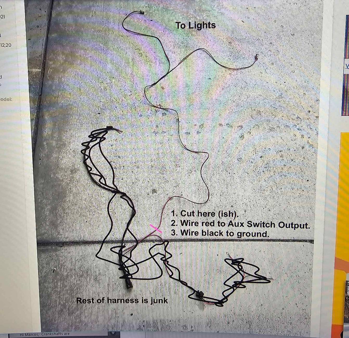

There's a few ways you can wire it up, Though I went with the way that requires you to slice the Wiring Harness- I didn't want to Hardwire these Lights to Aux Switch 2 so instead I bought these at O-Reilly's
https://www.oreillyauto.com/detail/...nnector/cti0/91440?q=Dorman+1+Terminal&pos=12
My thinking is, with a Plug Connection I can swap lights out a lot easier in the Future if I wish, at least on the Trucks side it's just a plug for future use.

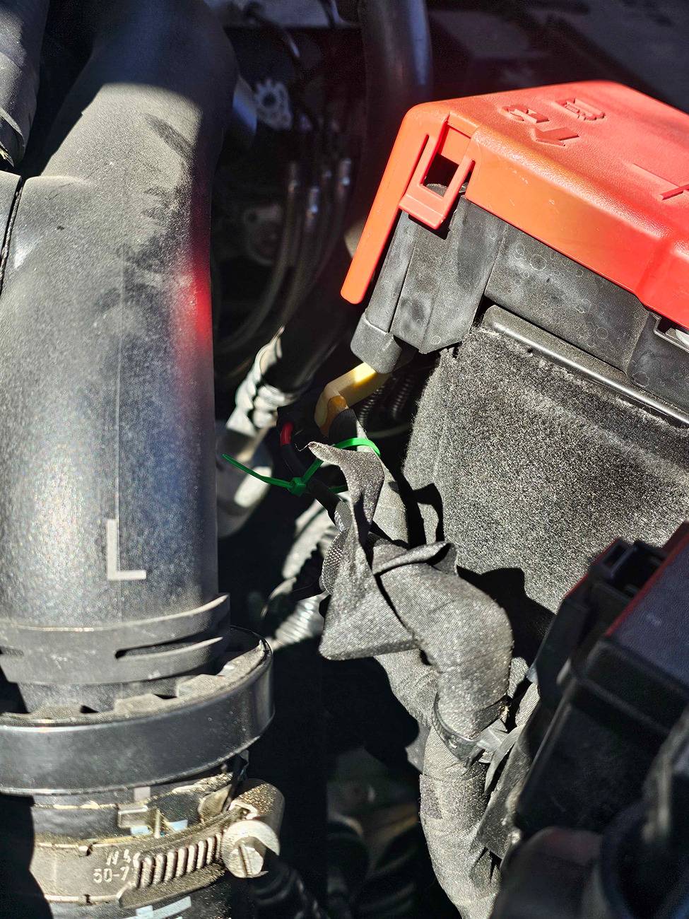

This isn't my picture as it's from another Forum but I made a similar cut on the Harness provided with the Lights.
Ford Ranger What did you DO TO your 6G Ranger today? 🧰 🛠️ ⚙️ 🧽 IMG_20250119_142413

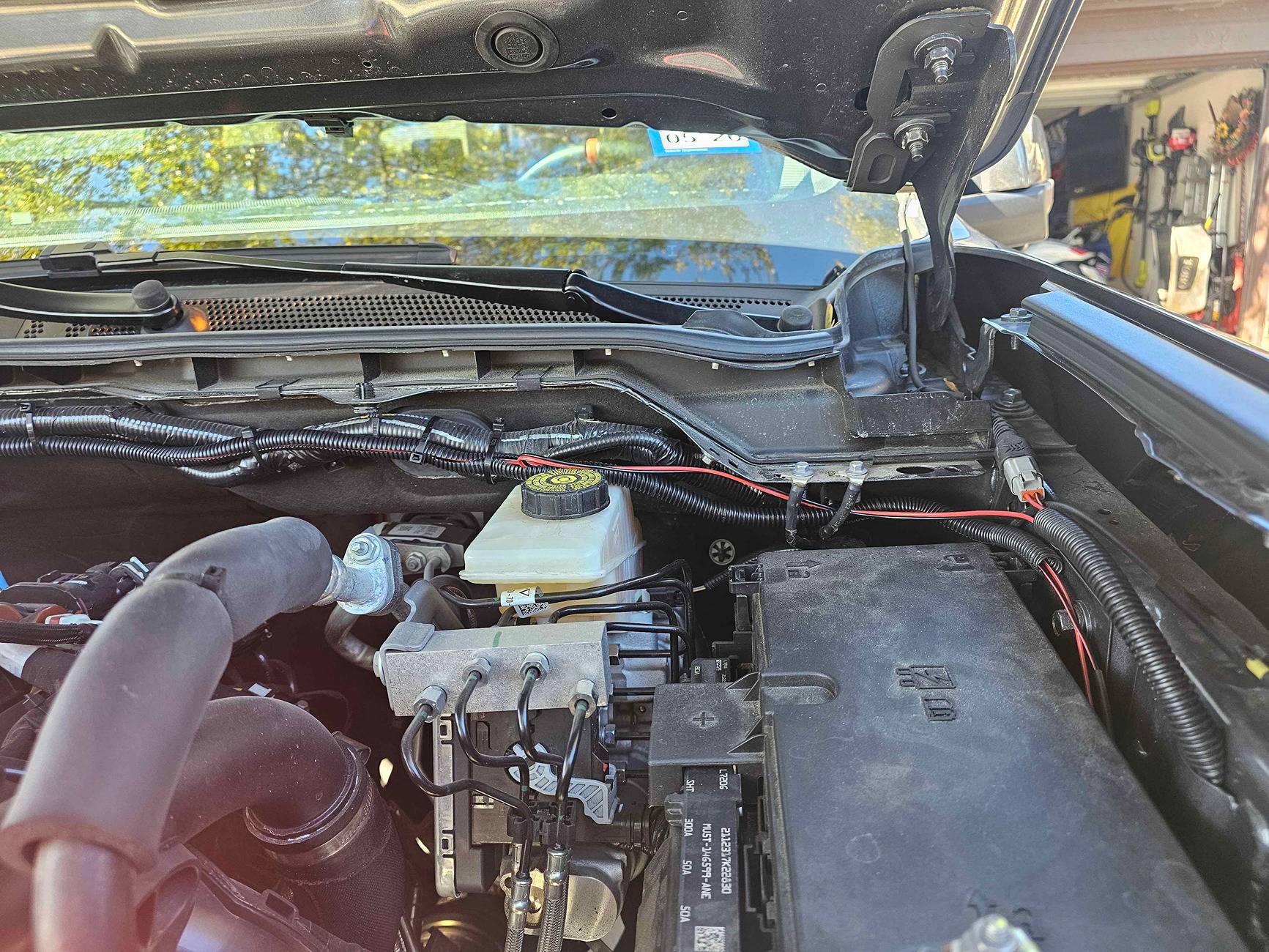

I left as possible and then trimmed after I had the wires ran, here's my under hood.
Ford Ranger What did you DO TO your 6G Ranger today? 🧰 🛠️ ⚙️ 🧽 20250119_142102
Ford Ranger What did you DO TO your 6G Ranger today? 🧰 🛠️ ⚙️ 🧽 20250119_142053
When we're not impending doom and gloom (Freezing weather in Texas) I need to go buy some more loom to clean it up a bit more, as you can see I just ran the wire from the passenger side and ziptied the Loom to the Trucks.
and here's a few pictures of the Plugs.

When I go to Clean up the Driver side some more I' need to get more black Zip Ties as well to clean that up.
I didn't get a picture but the Grounding Wire I just used a spot on the Battery Terminal with a Ring Terminal.
