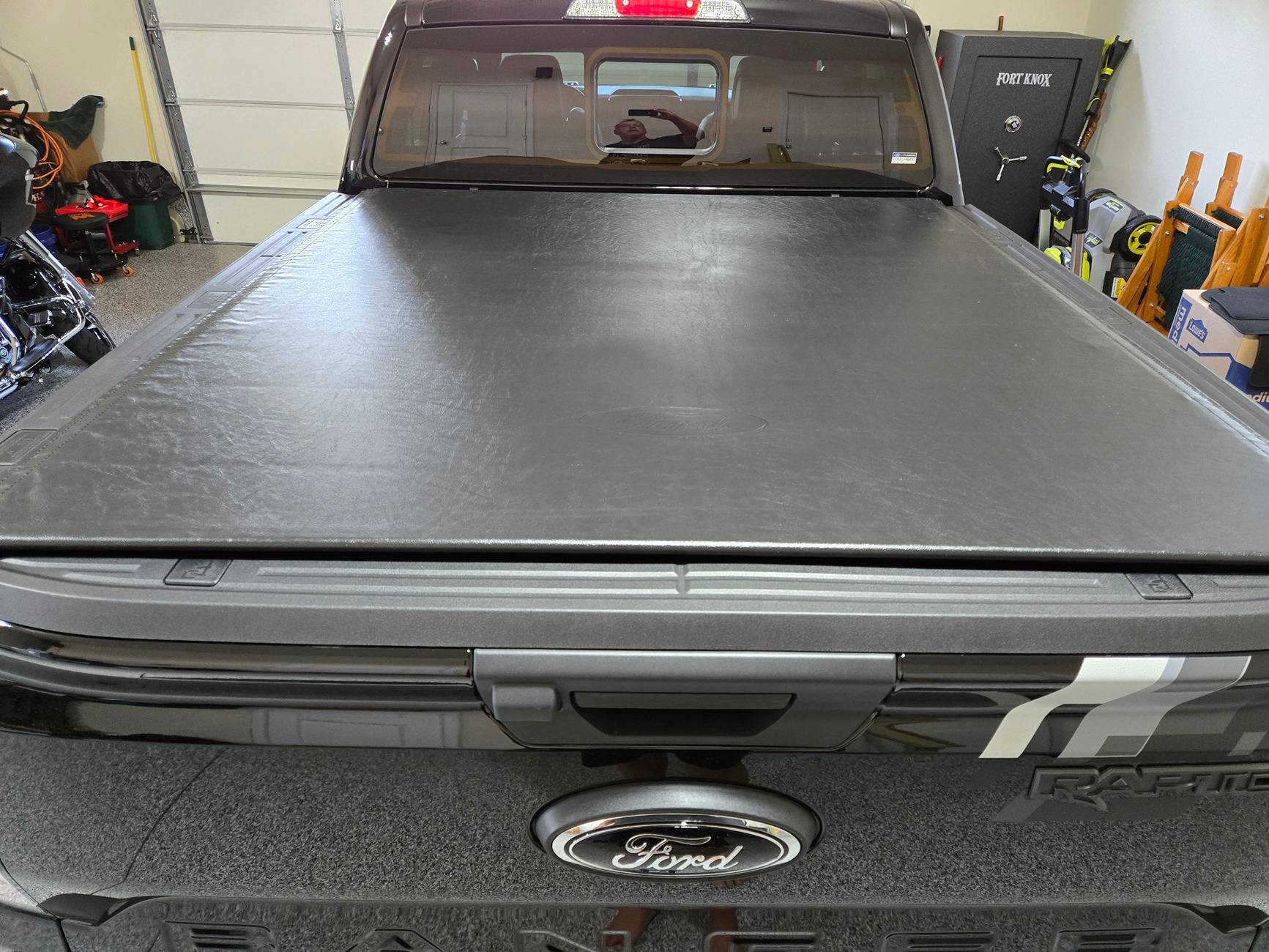

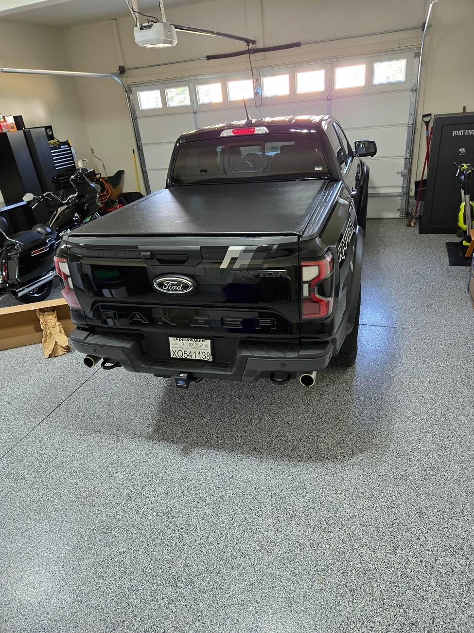

Installed the Ford branded Truxedo XLP tonneau cover.
https://accessories.ford.com/ranger...-roll-up-bed-cover-for-5ft-bed-vr1wz99501a42u
Ford Ranger What did you do to your Ranger Raptor Today? 20240716_093152
Ford Ranger What did you do to your Ranger Raptor Today? 20240716_093146
I've had hard folding covers on my last couple of trucks and decided to try a soft cover this time.
Install was really easy, about 40 minutes all together.
Fits well and appears to be sealed up well. It's very low profile. There is a Ford logo embossed in the cover, but it's not real visible.
I didn't expect to be buying a Raptor, so my timing was odd. I was only home for a few days in the 2 weeks after buying the truck and didn't want a big box sitting around outside while I was gone. When Ford did the 25% off code it made the price very competitive and they have free shipping if you pick up at a dealer.
A brief rant:
Ford doesn't update the status of your order until it arrives at the dealer. It looked like they never did anything to fulfill my order. After a week I called to cancel, figuring I could get it quicker elsewhere. It's not possible to cancel. You can change or cancel for 1 hour after placing the order, that's it. The dealer can do a return, but the tonneau and bed mat I ordered are marked as not returnable. The shipper they use doesn't provide tracking, so Ford doesn't know where the parts are. Welcome to 1980.

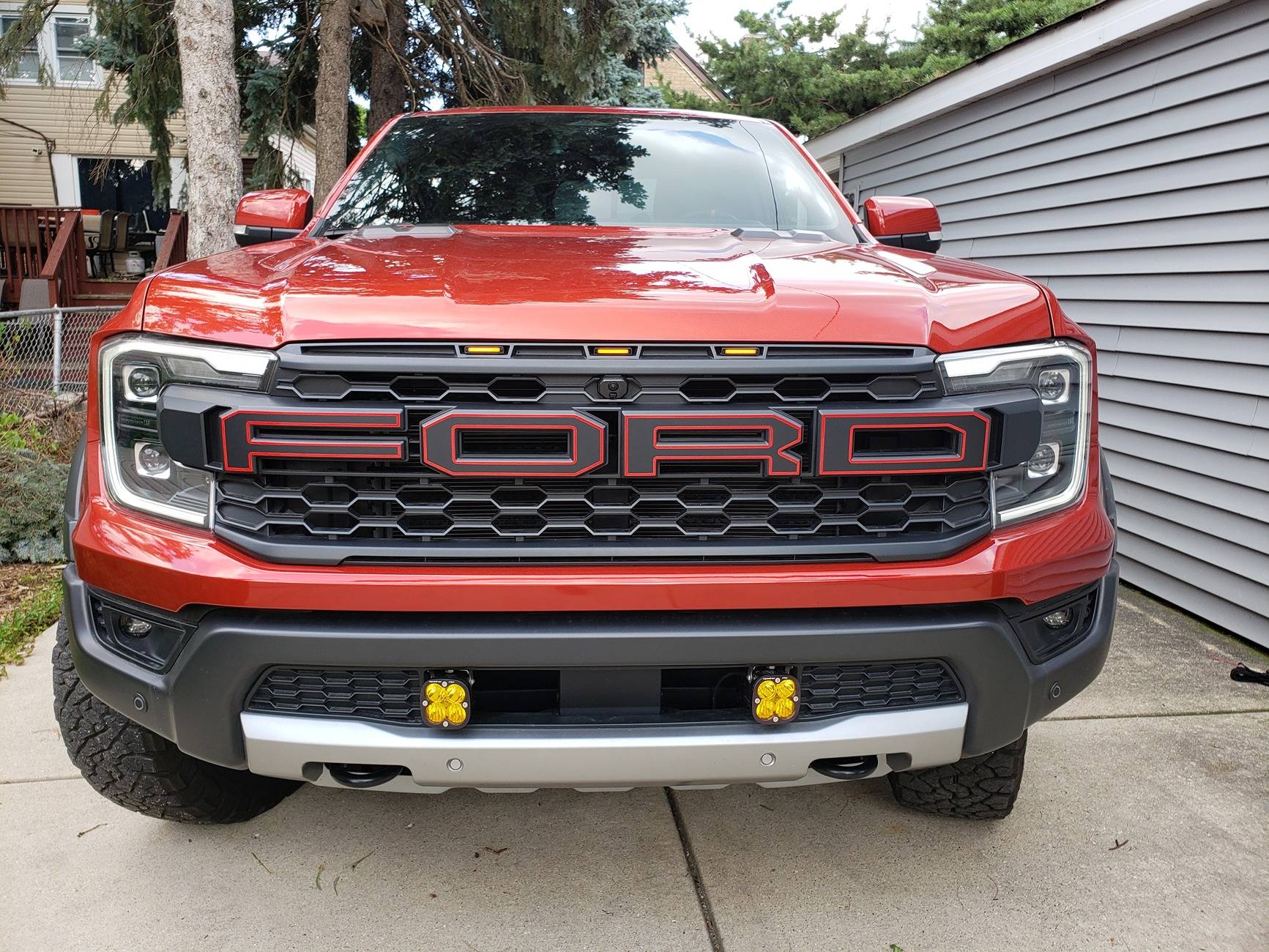

Added grill lights from f150 leds. Tied it into the violet and white stripe wire on passenger side head light. Comes on only with driving lights.

Looks great!

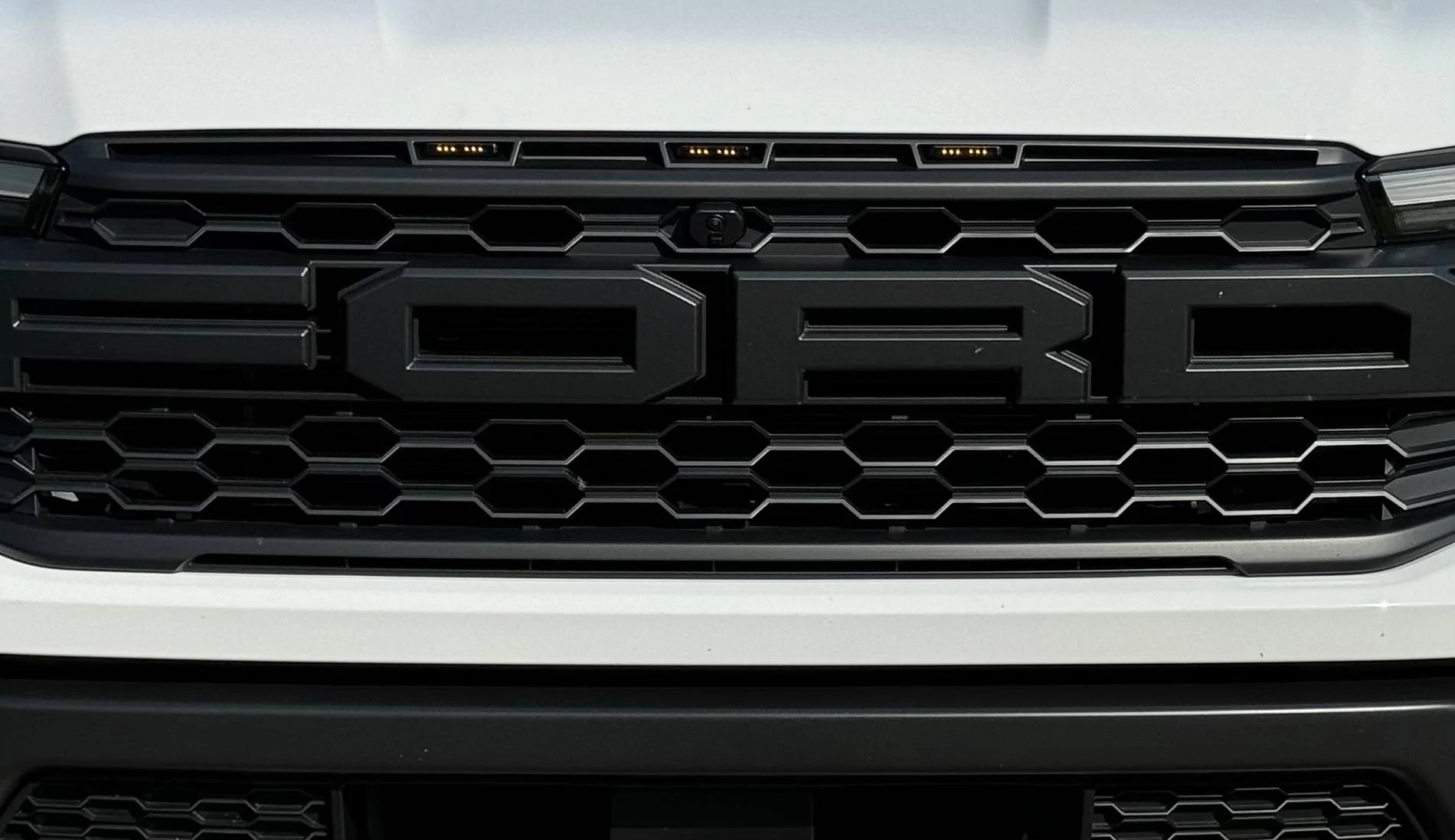

I really like your grill lights better then mine, with mine it was all I could find at the time but I sort of hate the weak light output, and hate that I can see all the little led dots.

Can we get some more picks of your grill lights different angles and maybe a link to the exact ones you bought?

I'm not sure how to post a link but I got the ones for a 21-23 f150 from f150 leds.com
Thanks for the pics and info.
Looks like they fit really nice and I really like the look better than mine.
I am going to try and get some ordered this week.

Is that the Gen2 or Gen3? Is there much of a difference? Gen2s are on sale for $89 while the Gen3s are $109.

I ordered the gen 3 kit.

Great looking truck. I also installed gen 3 and very happy with them. A bit snug, but will probably stay in place as a result…
I’m curious, on your install, did you keep the plugs or ditch them? I didn’t want to drill big holes, so I clipped off all of the plugs and spliced the wires. I also knotted the wires on the back side of the grill to prevent lights from popping out if glue strip failed.

I cut the back of plugs off and drilled a 1/4" hole. I followed the instructions on f150 leds website and wire tapped to the violet and white wire on passenger side head light and grounded to a bolt where the horn is.

Based on what you guys are saying.
This is what I need to order to get my lights to look like the ones Machduty put on his truck.

I am wired into Aux 1 and I leave my switch on all the time.
It's not a hot switch, meaning once the ignition is turned off my grill lights go off as well.
