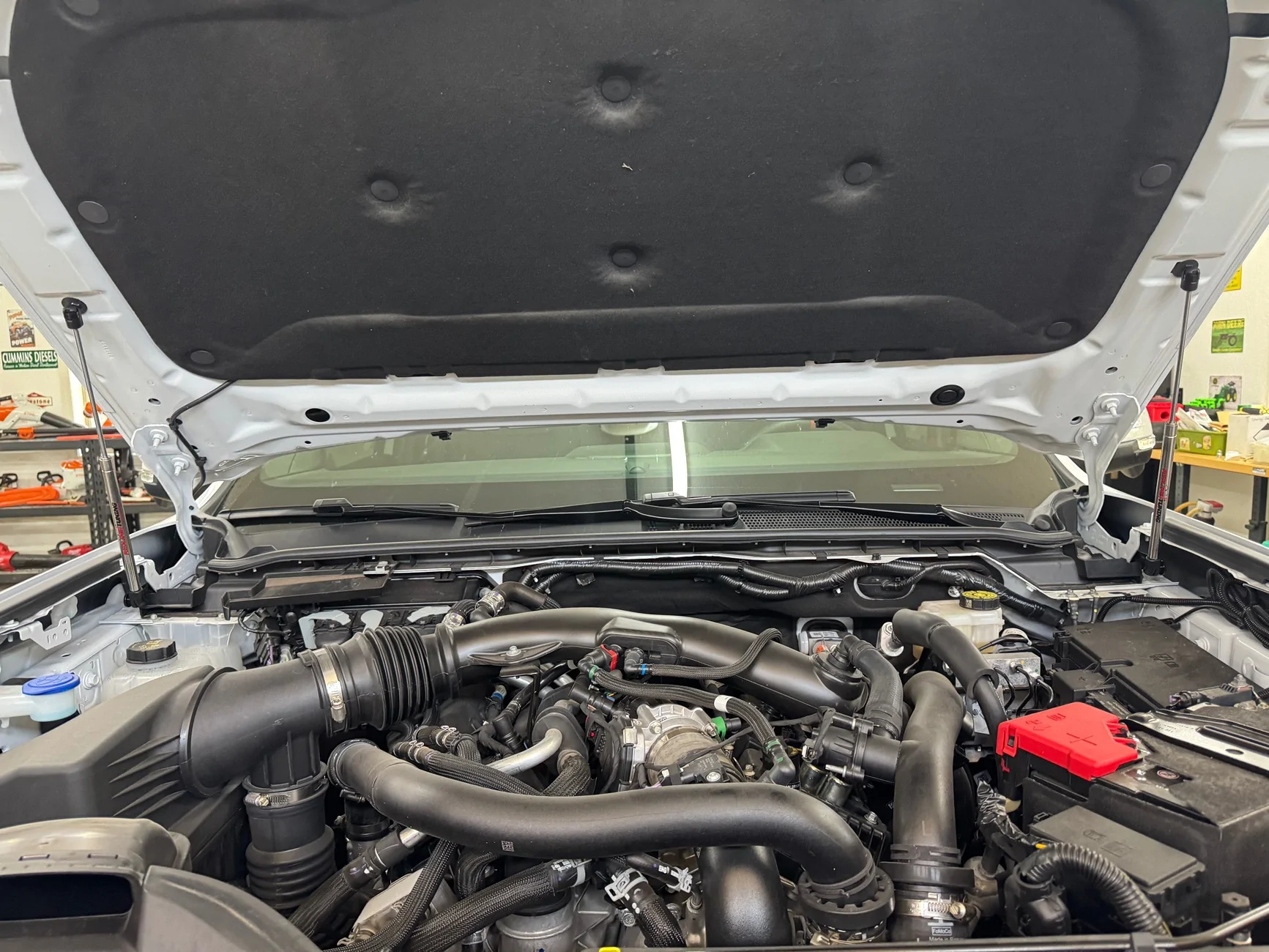

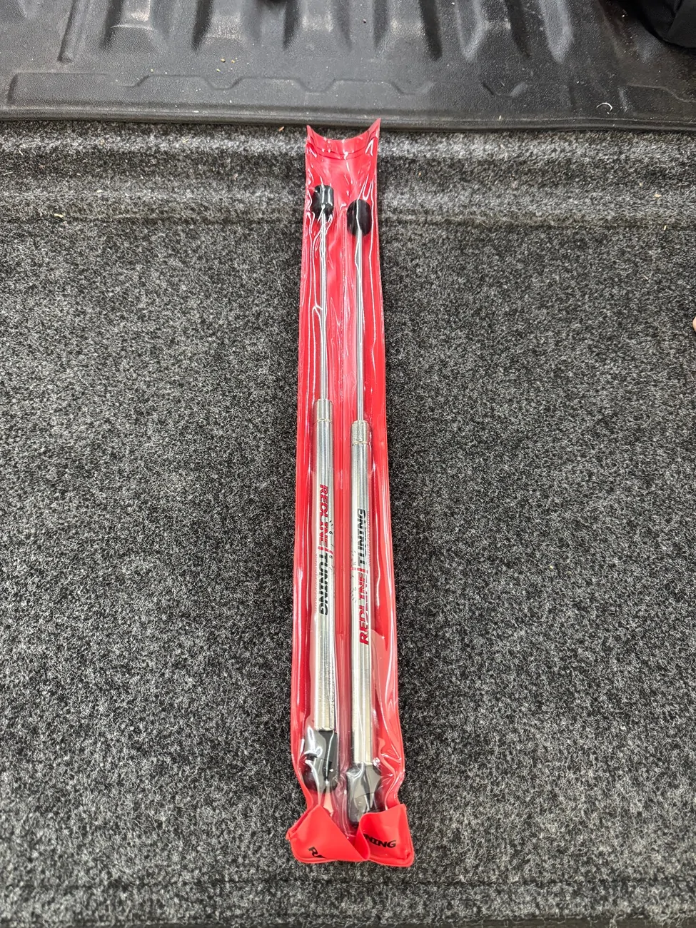

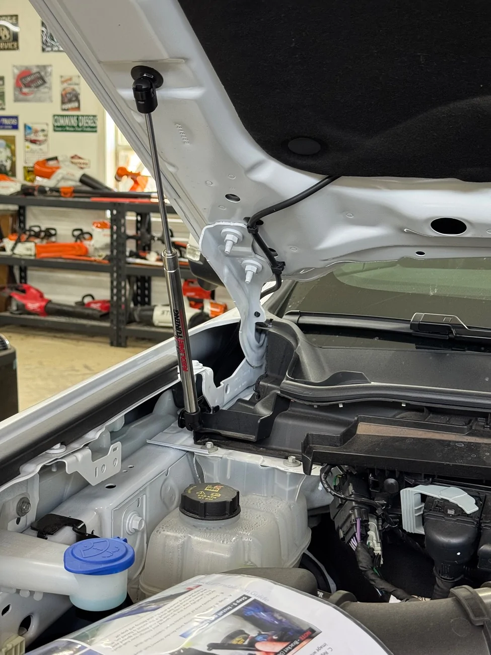

Installed some Redline hood struts on one of my RRs yesterday.
‘Curious if the added structure will help or improve my hood flutter that I have on this one.

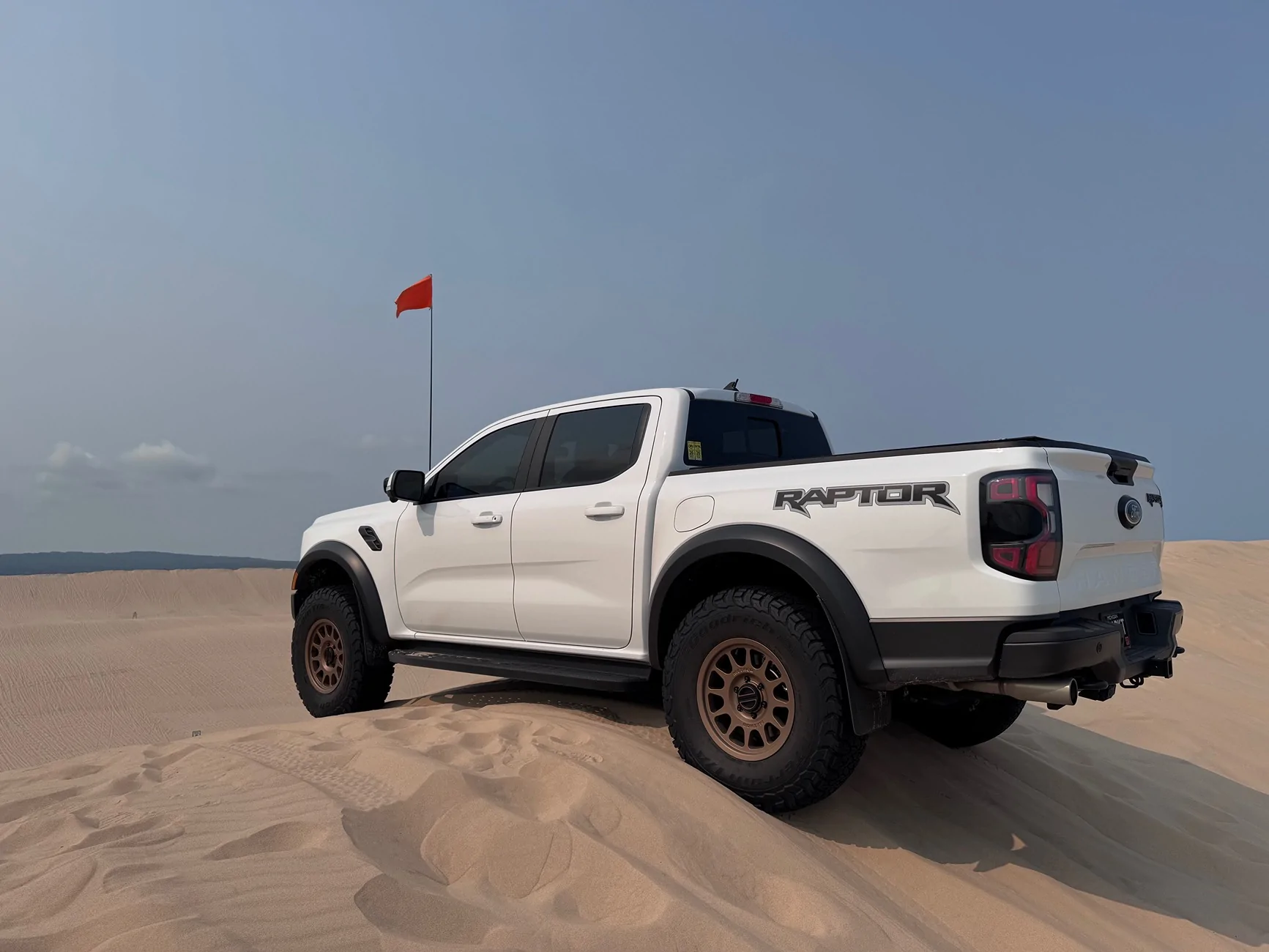

From high speed or rough road? I did not notice anything at 130km/h (80mph)
My 24 RR is solid no hood shake , my white 25 is the one with the hood flutter, and no matter how I adjust the rubber hood stoppers I can’t seem to get it to fit like my 24.
I drove my black 25 also recently and not seen any hood flutter in that one either.But that truck only has around 300 miles on it. Jury is still a little out on that one.
Issue seems very hit and miss with these trucks.
Would love to know if anyone with the flutter ever found a way to stop it.
‘Was in that truck with flutter today for 3 hours out on the interstate running 80-90 mph, the hood struts made no difference at all, still flutters in the wind. Especially bounces around when passing semi trucks when you get in that dirty air .
