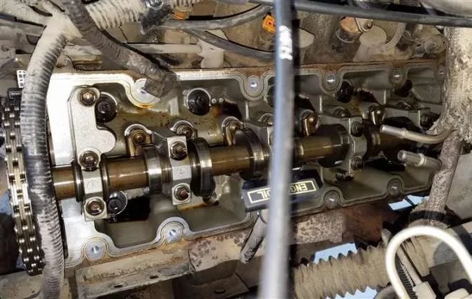

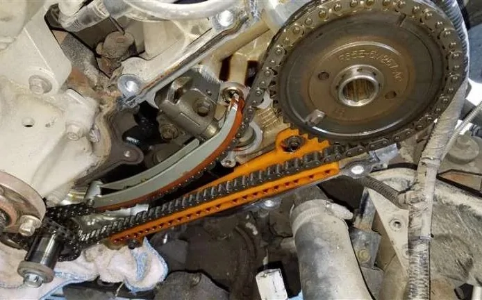

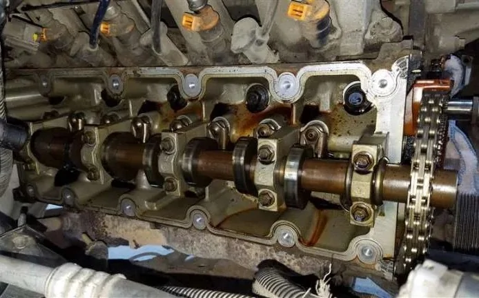

I had a 98 F-150 I bought new with the 4.6L V8. I always changed the oil at around 5K intervals with M1 5w-30. At over 100K miles I started using SuperTech Synthetic oil. At close to 250K miles I changed the timing chain and guides. I was pleased how the engine looked under the cam covers. That truck is pushing close to 300K miles with the new owner. Oil change intervals do matter.
