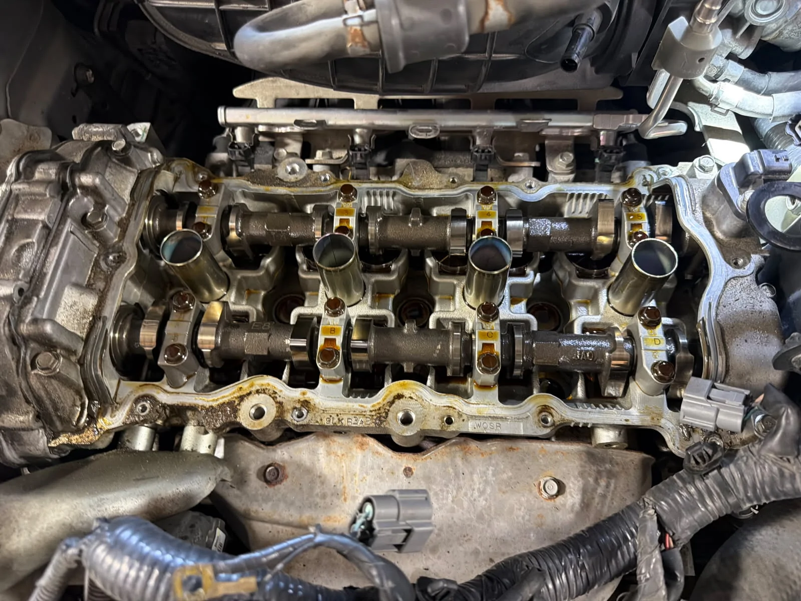

I just wanted to post/pass this this on so others can actually see proof that your oil change intervals matter. These are 2.5l engines, not Fords but just personnel picture proof of the difference. The clean engine is after 126,000 miles. I personally took care of that cars maintenance for 10 years and then it was sold by the owner to my granddaughter. The car had three oil changes by the original dealer then I took over. I changed to synthetic at that time. I won't mention the brand because I'm not trying to sell anyone on an oil or filter. I will say it's available even at Walmart for 25-35 a 5 quart bottle these days. The oil/filter was always changed before the 5000 mile mark except once, we went over a tad. My Son in law noticed the valve cover starting to seep so waited for the cars oil change to do the valve cover gasket. He sent me the picture because he was amazed at how clean the motor was inside, he's been inside many now and said it was the cleanest he'd ever seen especially for the miles on it.
This is what I consider a properly maintained oil/filter change engine. Oil has 4723 miles on it and at it's change time. Note the oil is starting to get a caramel color to, indicative of time to change.

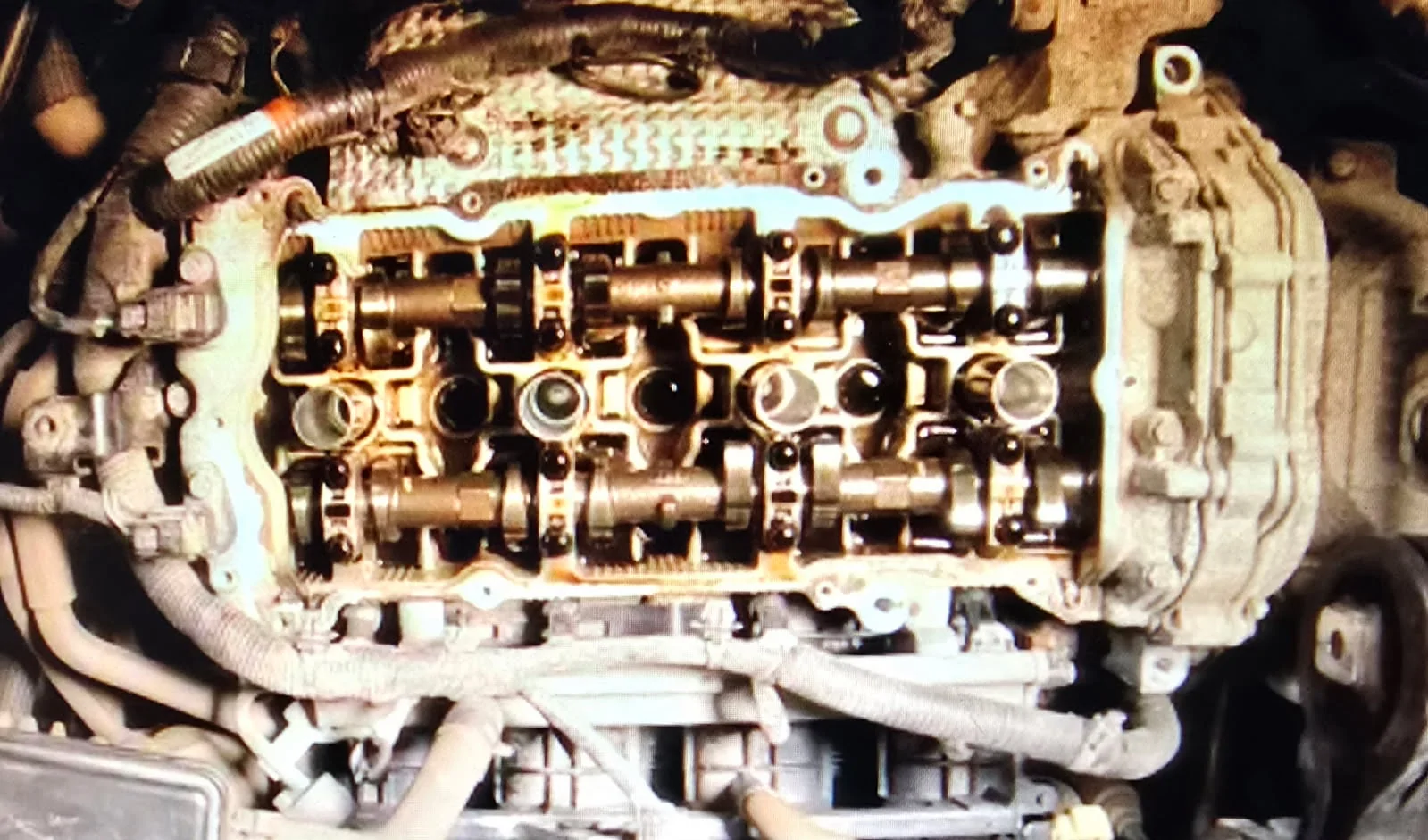

This is what most refer to as a varnished up engine. This happens when the oil is breaking down, not being changed often enough and the additives in the oil are no longer working. It is a hard layer of varnish caused by oxidation/heat and it gets cooked on. No amount of super oil changes will remove it, only manual cleaning.

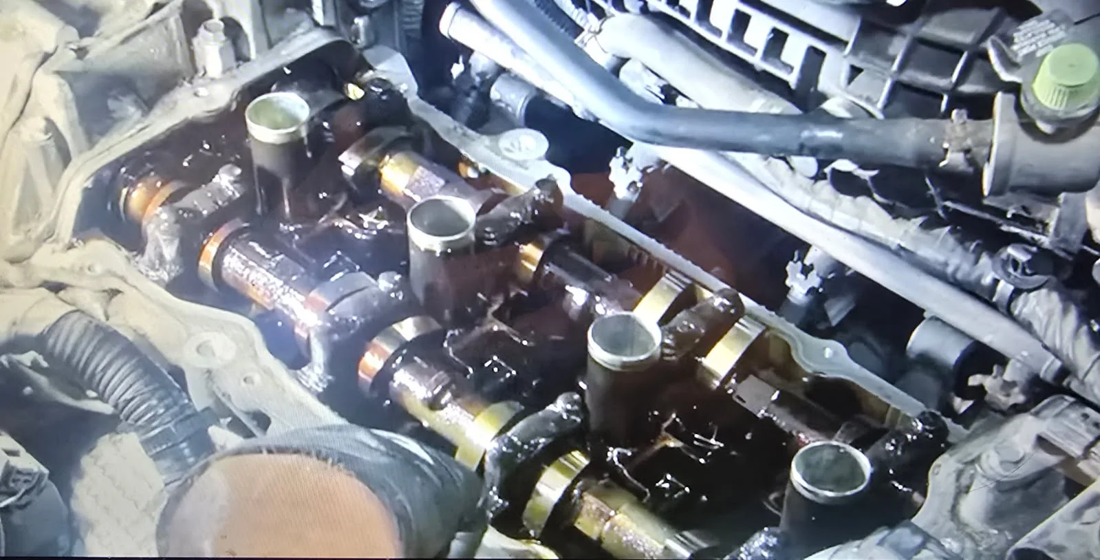

This poor engine is nasty and has sludge and varnish but not as much varnish as the varnished up engine. This point is you can have a varnished up engine or a sludged up engine on their on/separately and sometimes together. You don't want this!
Use your best judgement but if you run oil too long no matter if conventional or synthetic the additives breakdown before the oil ever does! Synthetics do last longer but no oil is exempt from the additives getting used up! Ranger On! :like:
Absolutely đź’Ż %...!!! Every 5,000 miles. I've been using synthetic since it first came out (so you know the brand) and my engines were the same. My vehicles fall apart and my engines are still that clean and running strong with great compresssion when everything else is gone.
