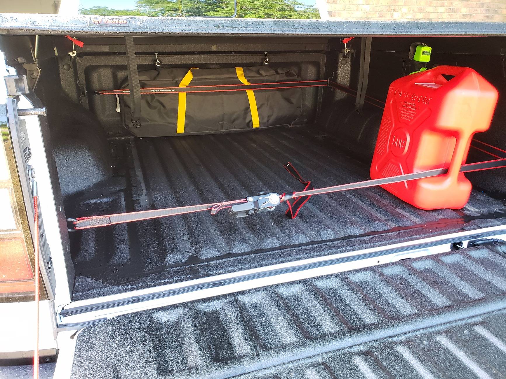

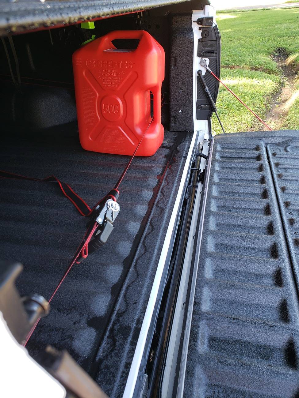

Bed is about as watertight as it's gonna get right now. Here's the water intrusion after the thunderstorms we had last night. I put MD auto-grade weatherstrip (Lowes) along the trailing edge of the bed and along the taillights to just below the latches, and another along the bottom of the bed. Also shoved some pipe insulation (aka pool noodle into the holes in the upper front corners of the bed. Gaffer (gorilla) tape on the bulkhead holes, and a MaxMate ($150 amazon) soft tri-fold tonneau. I don't recommend the cover as the clamps are at an angle and you have to cut the bed rail caps to clamp it to bed, but it works for occasional use.
