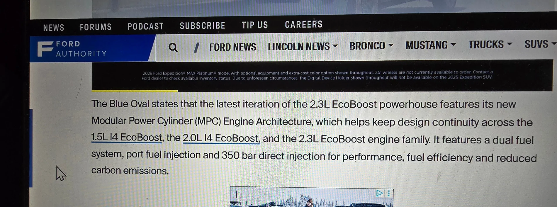

There are probably door or code build dates in 2024 with the MPC engines depends on Ford when they started the swap into what they classified as 24 or 25 year and they seem to vary it over the years to some degree. That's why I said the info the aluminum valve cover as a give away. :thumbsup:
No worries, I was just basing my info off of forum experiences. I've not seen any MY 24 examples, but did see users taking shots of their new MY 25s which arrived with MPC :)
