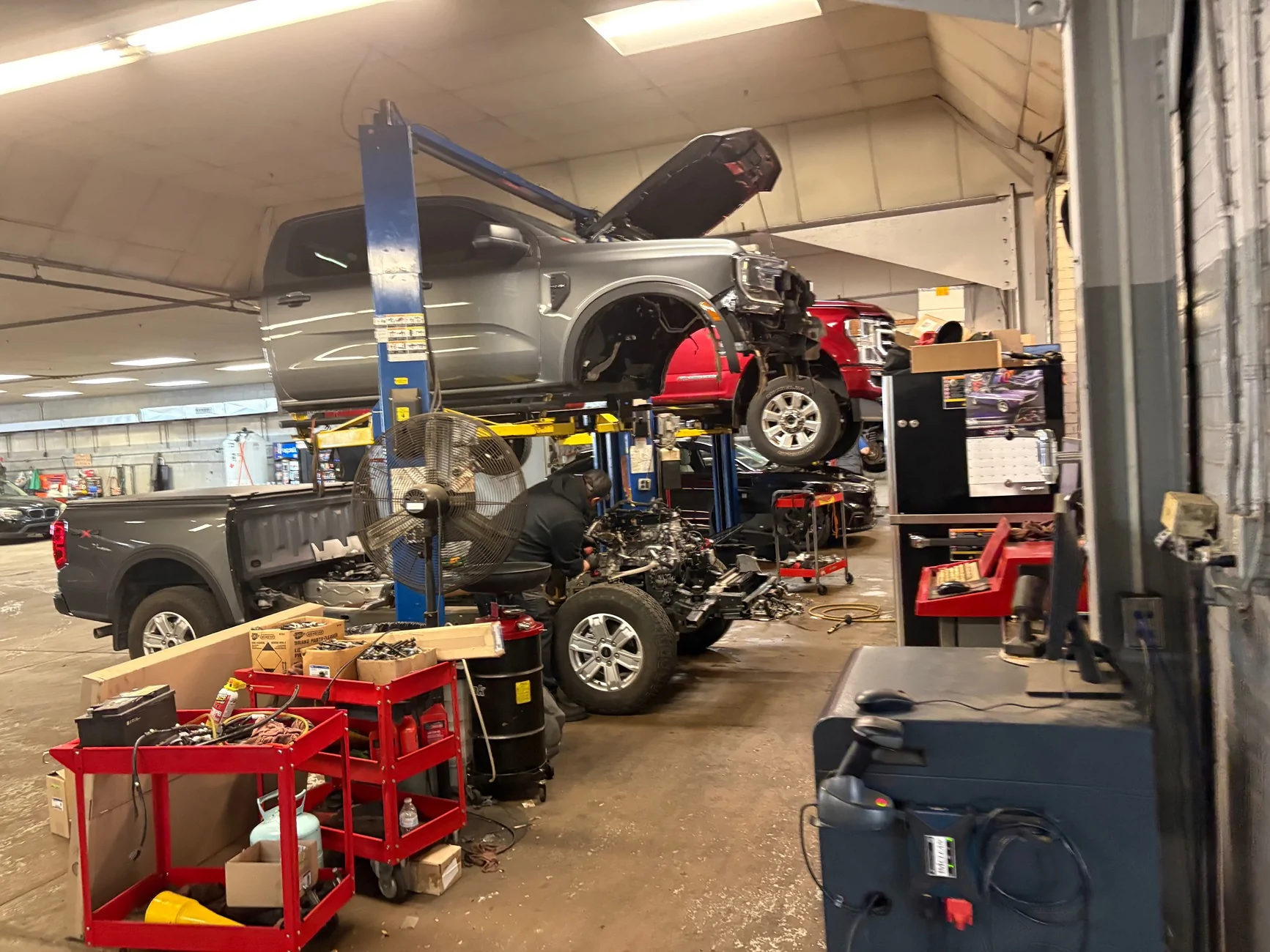

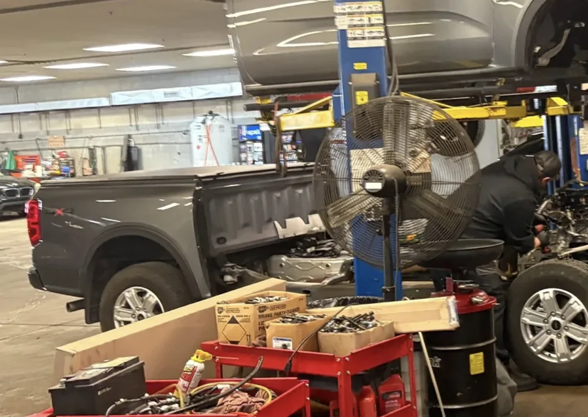

Not unusual. I remember they had to do that on Super Duty with diesel engines but did know about Ranger.
4,075
3,960
i thought they were going to do my old nissan like that for the motor replacement. they ended up going through the engine bay to pull the engine and trans.
my truck looked like an exploded view diagram laid out in person when i went one time to check on it. it looked awesome and scary at the same time, ha ha ha

Honestly this looks superior from a mechanic perspective. I'd rather see a setup that favors ease for those guys. Besides, it's probably just a reverse of how it's put together in the first place.
For sure. It looks extreme, but for the mechanic it’s a great setup. Everything is likely to get put back together correctly, too. It’s a lot easier to torque everything just right, make sure hoses are attached properly, etc.
100%

look at how clean that truck is. so nice
