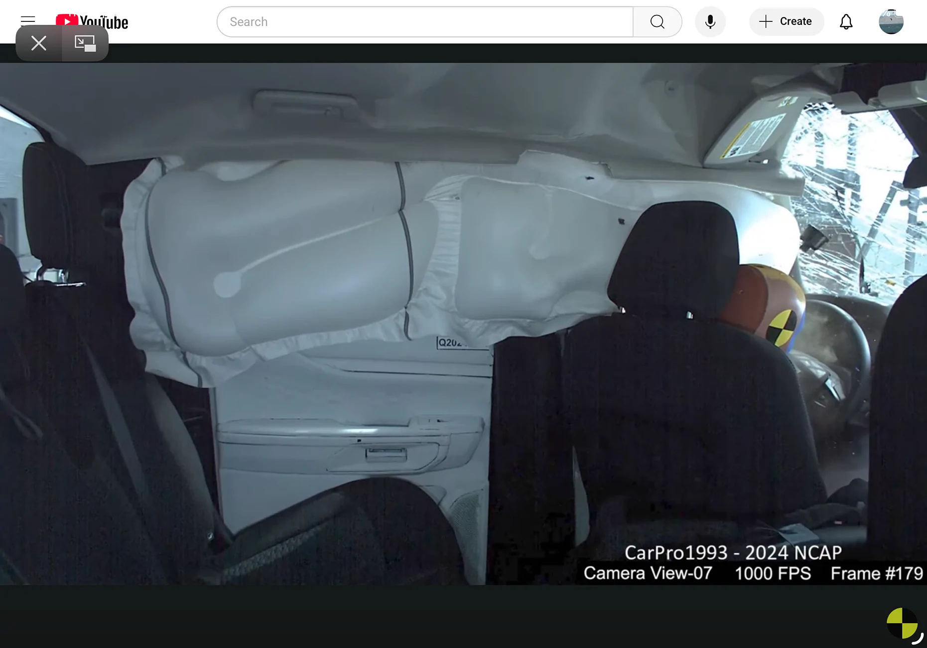

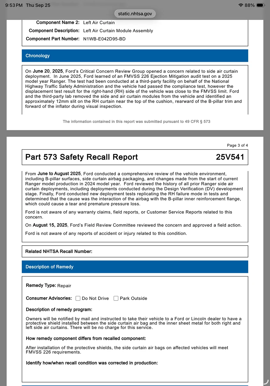

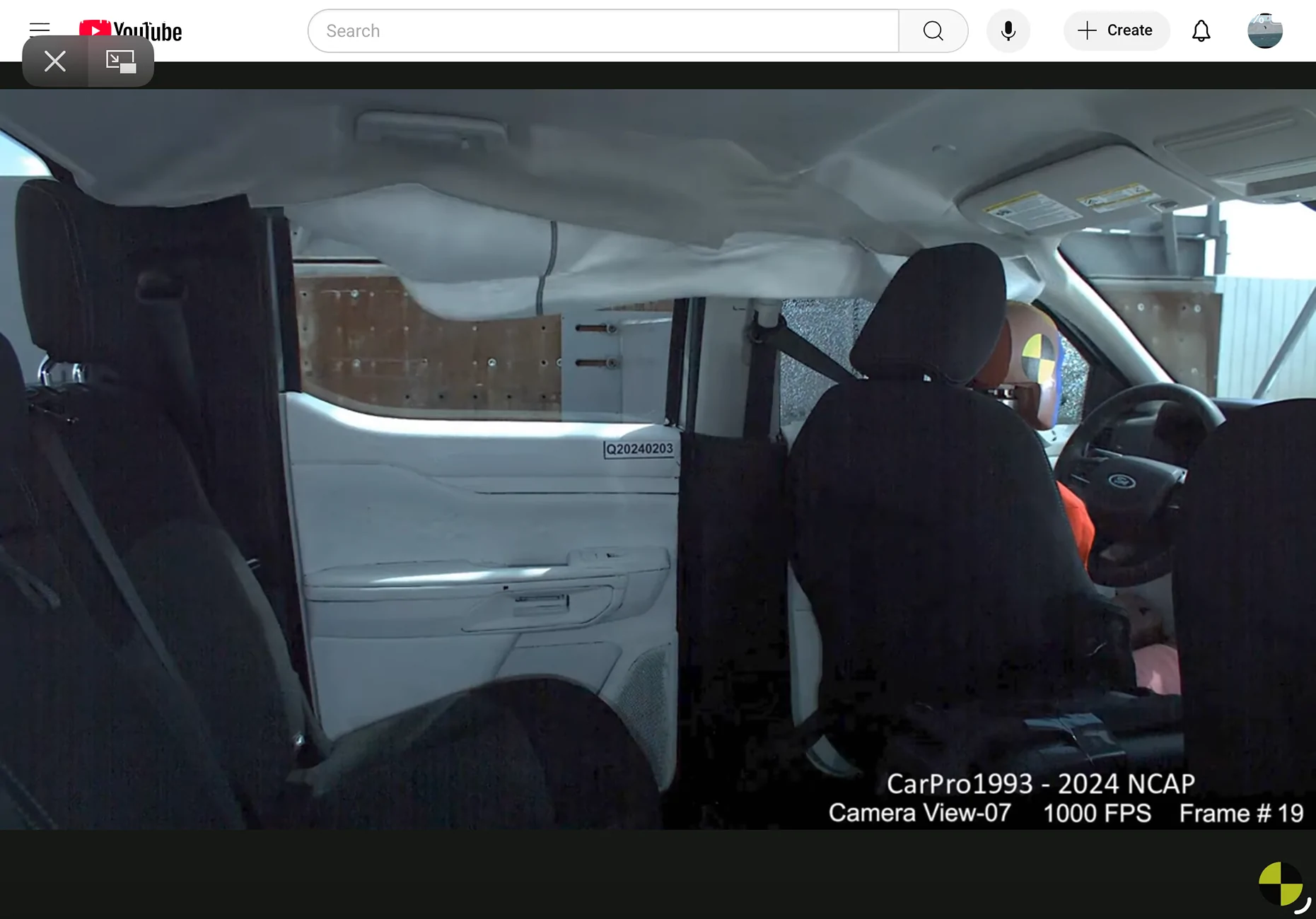

purdyd
Apr 28, 2025
1,090
1,535
california
2025 Ford Ranger Lariat
So, the recall was an issue where if the side airbag had to deploy, it would get ripped open. The shielding they are adding is used in the deployment of the airbag, to protect it from getting ripped. I don’t think it’s an actual metal shield, if that makes any sense, as they are trying to protect it from other potentially metal objects around it.
it seems a metal sheild is added between the airbag and Sheet metal Behind it.
if be curious if it is just in the b pillar area or the entire length.
https://static.nhtsa.gov/odi/rcl/2025/RCLRPT-25V541-7747.pdf
