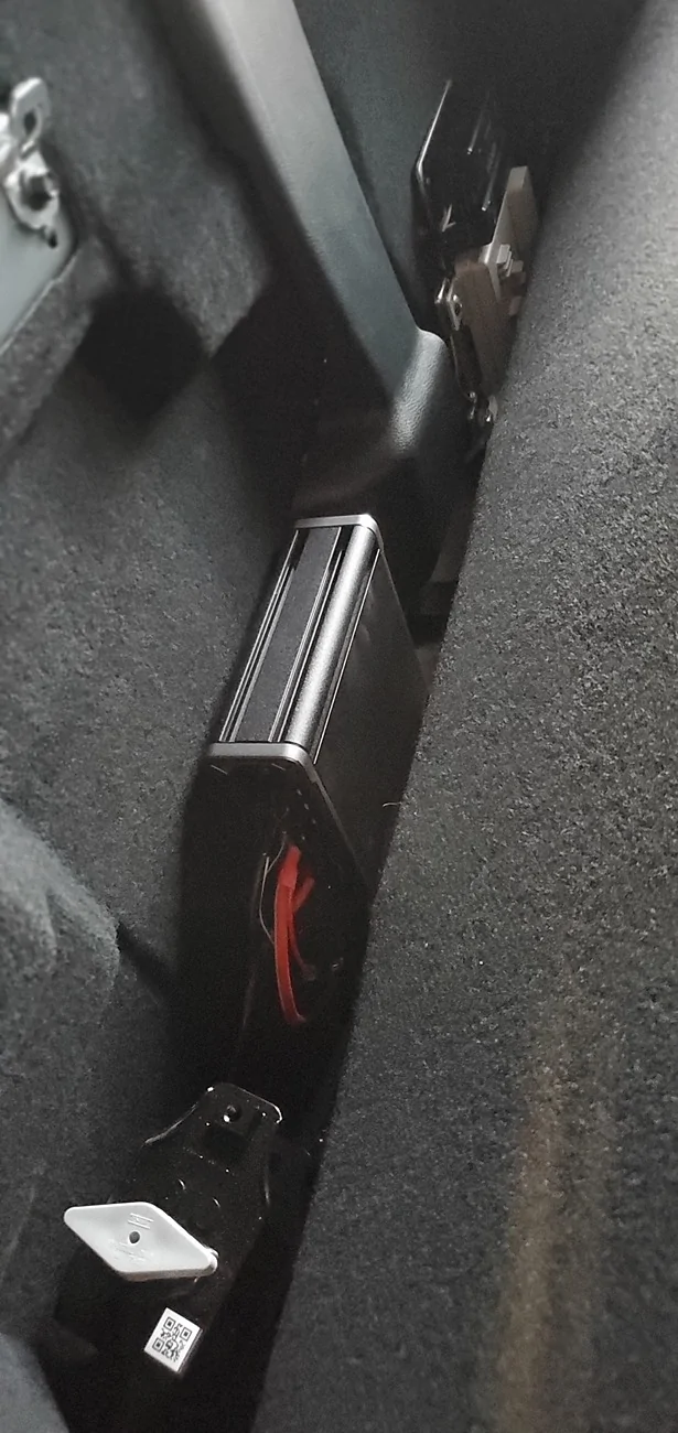

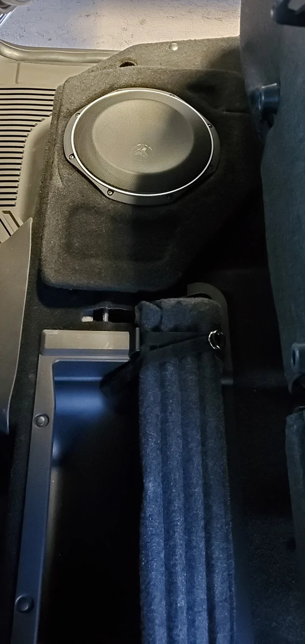

Tight fit! I think I got about as much bass as you can without modifying the interior or having a box sitting on your back seat.

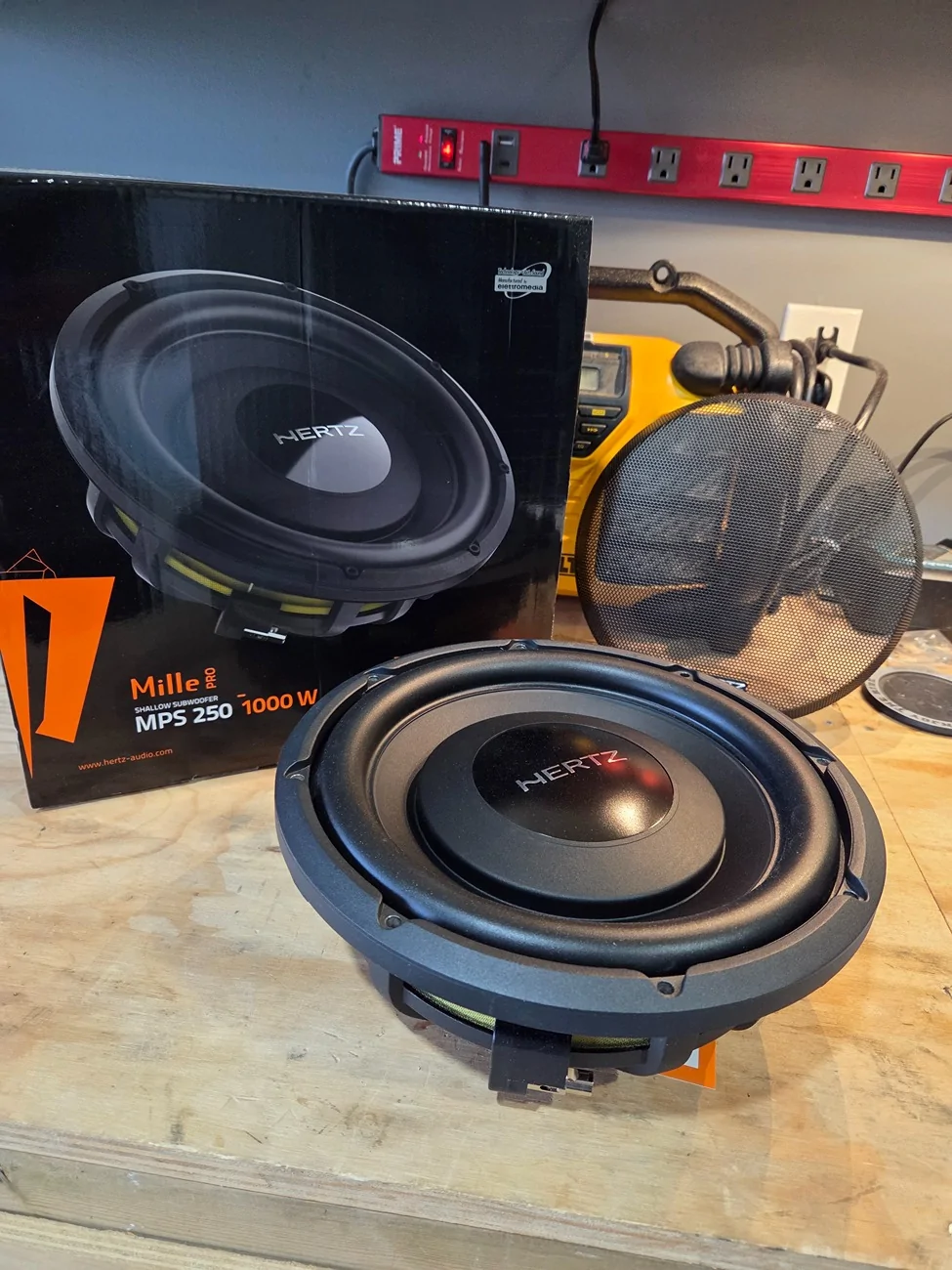

Tight to the seat but the deep grille provides the space for the impressive excursion on this thing. After mounting the sub to the box, I was really skeptical about it fitting, but, it does with 0 playroom. Hertz mps250. Would recommend! Songs with tight bass make this thing hit like a roundhouse kick from Chuck Norris 🤔
Powered by fosgate prime r2-500x1 👌

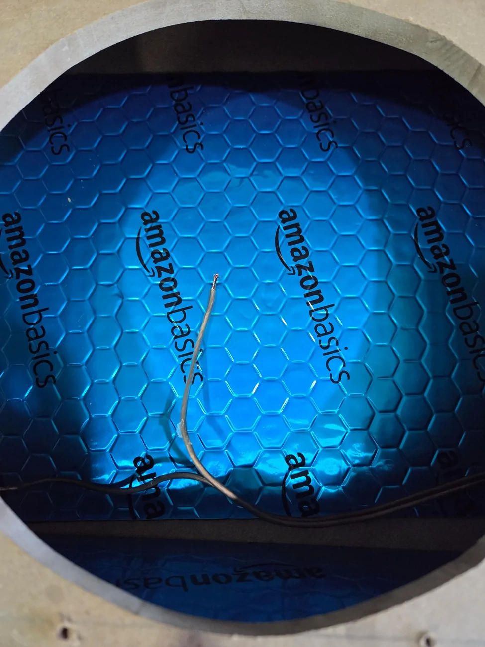

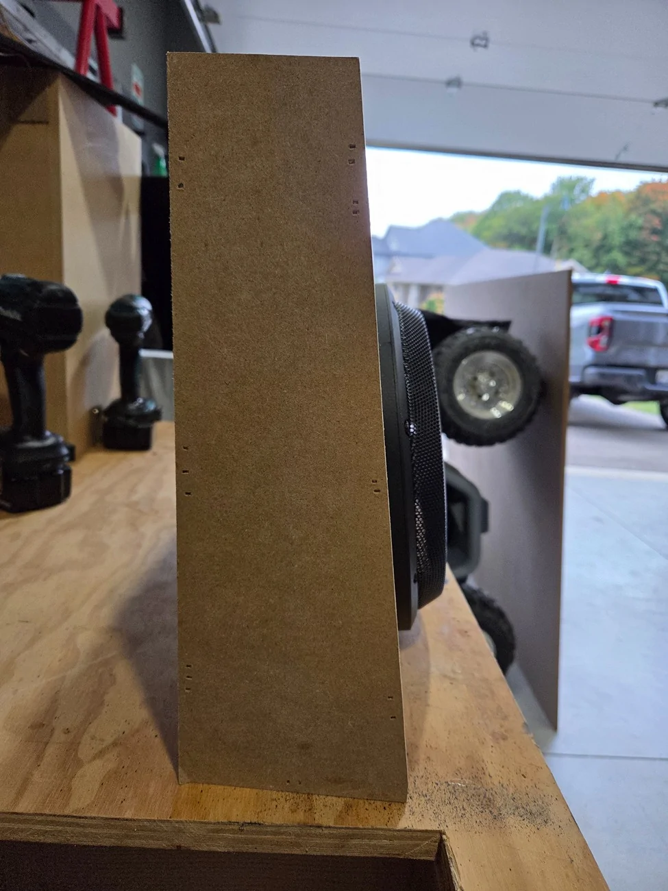

Box detail: outer dimensions 25"long. 5" bottom/3" top. 14" high. 1/2 mdf with a brace inside. Don't think the magnet will clear inside with 3/4 so I played it safe. Subwoofer has to be offset as theres some metal in the seat that would interfere. Also mounted as low as possible so the magnet clears the back.
I hit my target volume with this box of .5cu ft. More space than the cubby under the seat.
Ordered some front pioneer component 6x9 + tweeters for install in the coming days.
Hope this helps anyone wanting a rear seat sub setup!

For my setup I have a AudioControl LC2i line converter that gets the signal to my Kicker HS10. I have the LC2i connected via a harness I bought from PlugandPlayKits.com. I have the NON-B&O stereo. Harness requires disassembly of the interior in order to get behind the 12" screen to install the harness. I didn't want to splice into the factory harness so it had to be done.

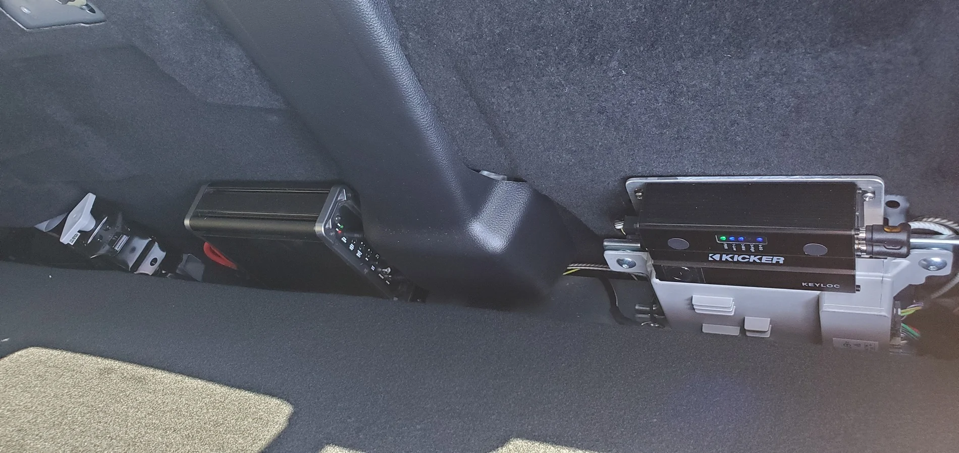

Sounds Good Stereo sells a pre-programmed Kicker Line Out Converter that is truly plug and play for the Ranger with a B&O system. It plugs right into the factory amp harness behind the seat. All the set up and programming is already done for you. No cutting of wires. It provides a flat bass signal for your mono amp. Otherwise your stuck with the Ford factory bass roll-off which will make your sub sound terrible. It's worth every penny.

Located under front door sill, I tapped into rear speaker wire.
And my amp has a wired remote bass control, which I mounted up front so I can adjust bass on the fly.
