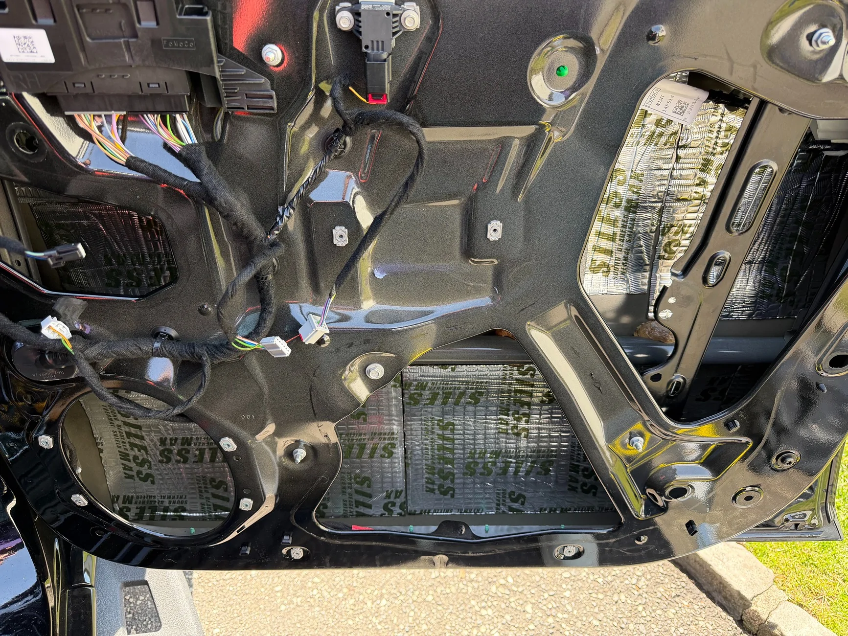

LAST UPDATE: Super happy with how this turned out! There is a slight rattle on the rear window in heavy bass, but I've realized that with the rear seat folded down that goes away and sounds MUCH better anyway. Happy to answer any questions.
Just installed sound deadening in all 4 doors and swapped speakers while I was in there. Shout out to flaberdoopin for the videos of the disassembly. The first one took a bit longer than anticipated as the trim brackets Crutchfield sent were a wonky fit (ended up using the packaged screws but also Gorilla Glue to be sure). I mounted the speakers to the trim plates first, then installed the plate+speaker into factory holes. That said, I finished all four doors - sound material and speakers - in about 3.5 hours. The last door took maybe 30 minutes bc I was a pro by then.
The JL speakers definitely sound better than stock, but the sound deadener its absolutely worth the time invested. Check the video below and you'll see how much of a difference it made.
Next week I plan to install a Kicker hideaway 10 with the Sounds Good KEYLOC.
In case anyone's interested, here's the parts list I used [updated to include all parts and tools]:
Siless, first layer (see pic)
Siless, second layer - This one is probably twice the thickness and clearly made the biggest difference.
I only used half of each box to complete all 4 doors, so plan for leftover material unless you can find a smaller box / maybe pick up on marketplace. Honestly, the difference in sound and 'feel' of the doors opening/closing are substantial enough that I plan to do the headliner next week. Its a PIA to take down but with leftover material and seeing the difference it makes, its a no brainer for me.
REAR DOOR WITHOUT SOUND MATERIAL, FRONT FULLY INSTALLED. WOW.
In case anyone's interested, here's the parts list I used:
