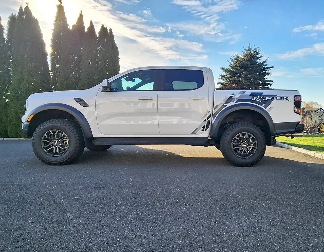

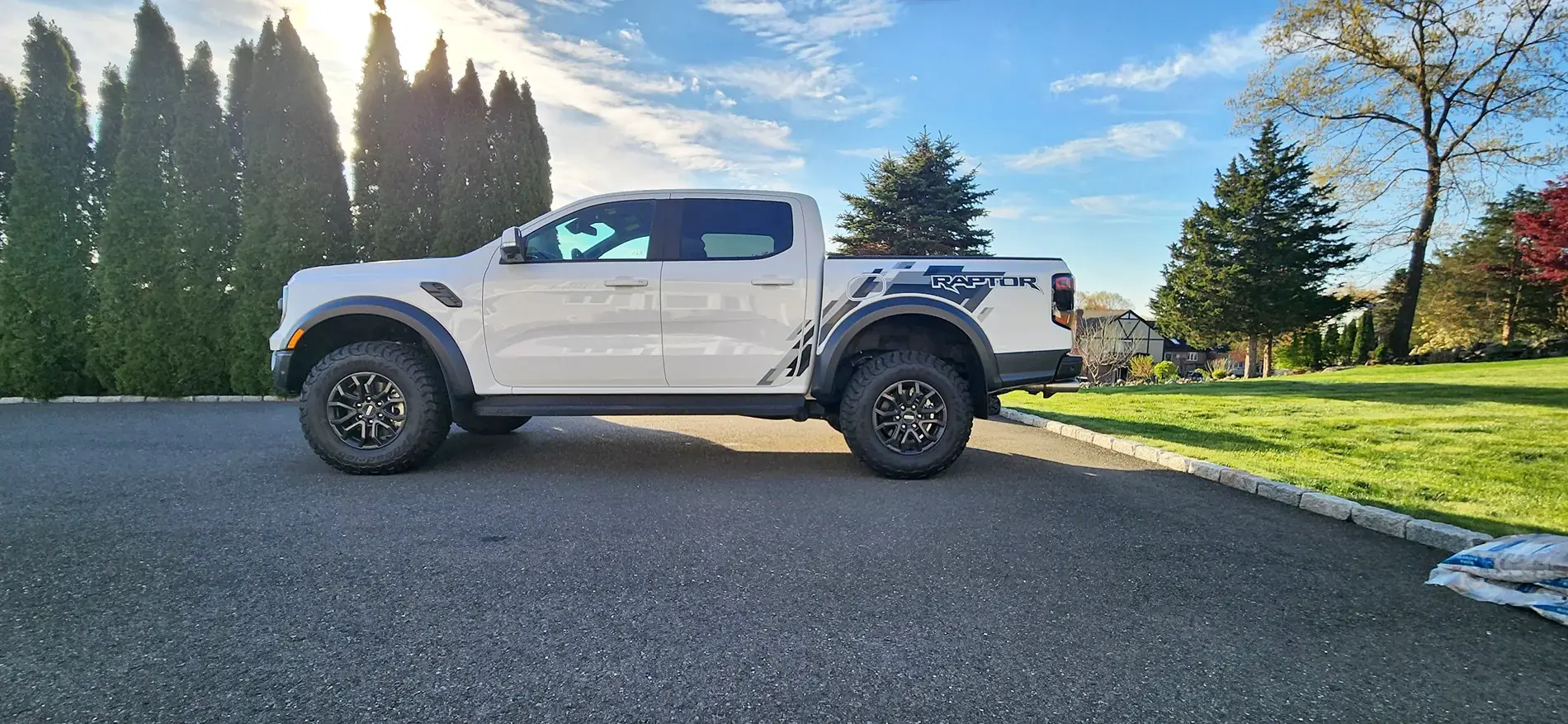

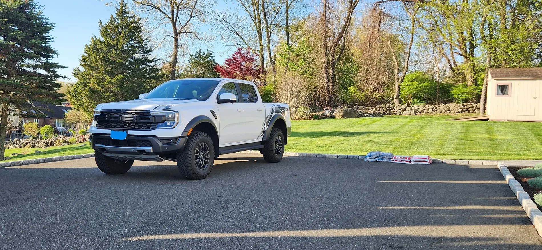

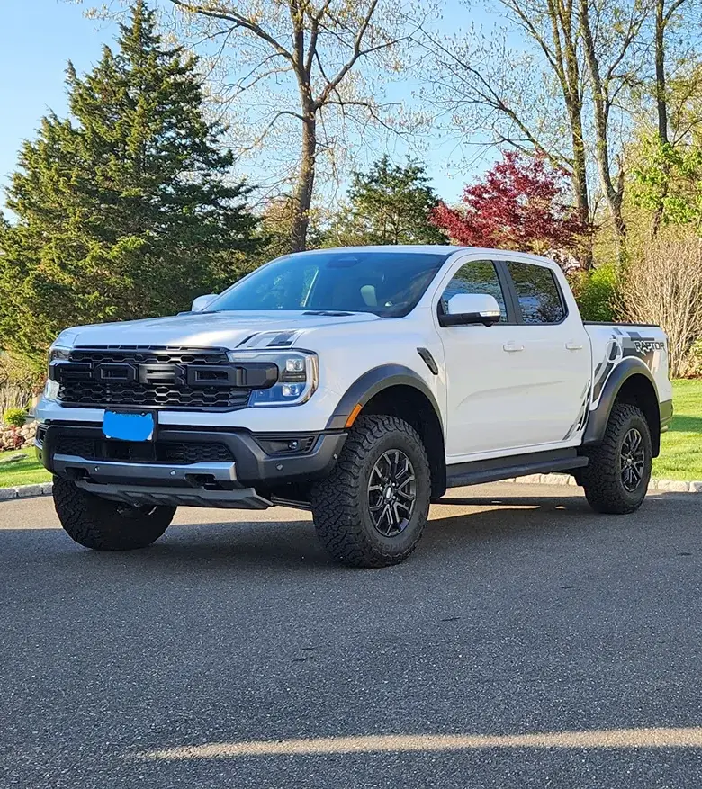

Did the install yesterday and some members asked for pics, I went with the 1.5" spacer in the front and the 1.5" spacer in the rear instead of the 1.0" Rear lift that come with GOAT's recommended packages. Rake is exactly like stock just with a higher ride height which I'm totally fine with. I wanted handling to stay to same and wanted some more clearance for slightly bigger tires, I have Falken Wildpeak at4w 285/75/17 (34.1") waiting to get mounted to a set of 17x9 +30 RTR Evo 6's. Even with stock wheels the increased ride height makes the truck look better in person.

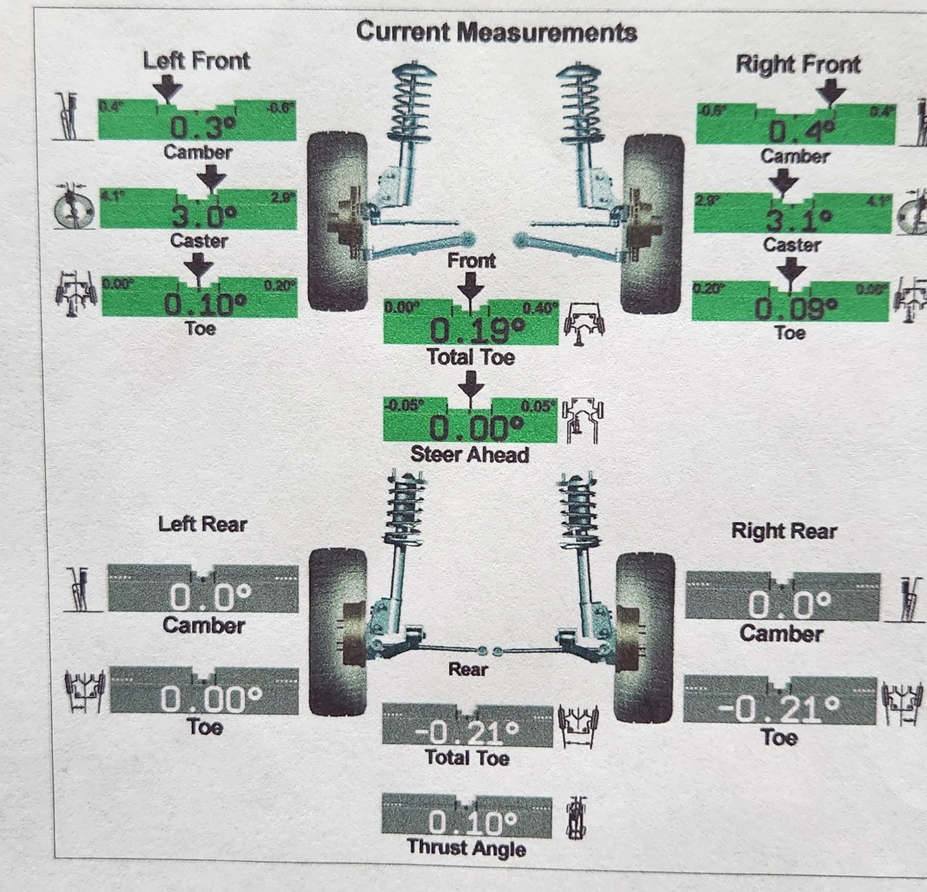

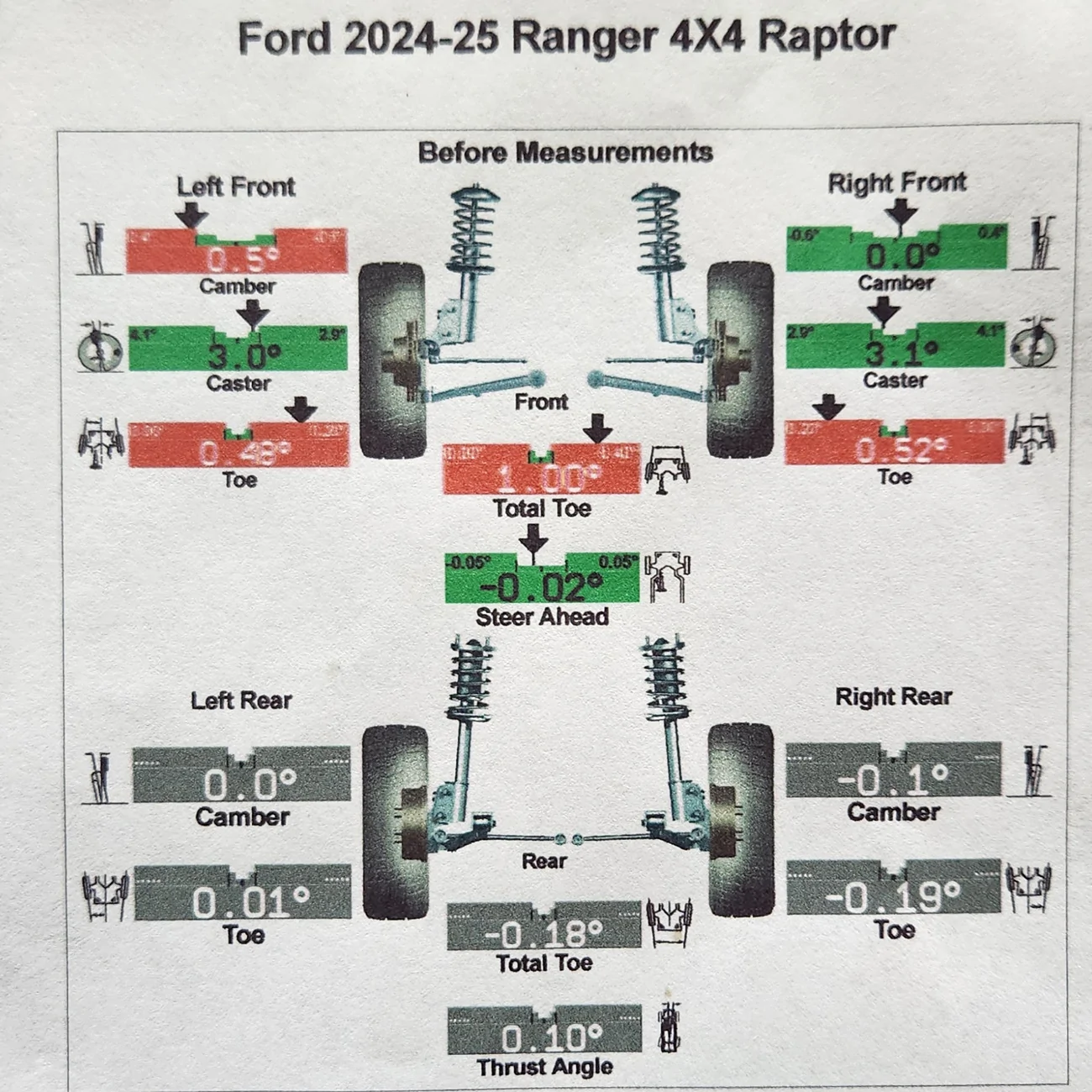

This is after the ride height calibration, but before going out for alignment. I was surprised at how many tire shops want nothing to do with you when they hear "lift kit" for an alignment. I had to call around to a few shops.....

Looks good as I'm a fan of the factory rake. For the alignment, was there more than toe adjusted?

Looks good, and I like your approach to the lift. Share some pics after the new wheels/tires installed. Thinking that 285/75 might be a good size, and not too many pics of them on here.
