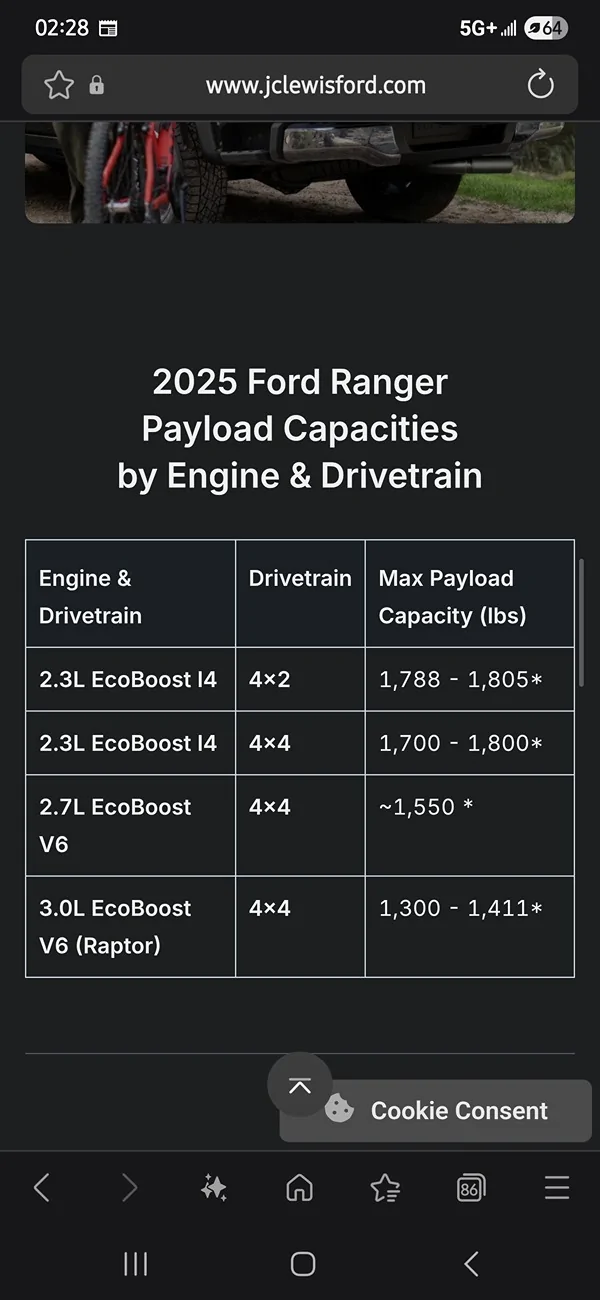

They're rated the same due to chassis limitations.
The engines all outperform the limitations of the chassis, which boils down to the tongue weight. It's why the raptor has a ~5000 lbs towing capacity. Not because cooling, braking, or engine limitations. Simply because the switch from leaf springs to coil overs in the back limits the tongue weight.
AND the 3.0 bring heavier. its also why a base 2.3 Ranger has more payload then a fully optioned 2 7 lariat every option
adds weight, decreases payload, then the extra weight of the engine
Ford Ranger Is the 2.3L engine enough for towing a small travel trailer? Screenshot_20260217_022824_Samsung Internet
