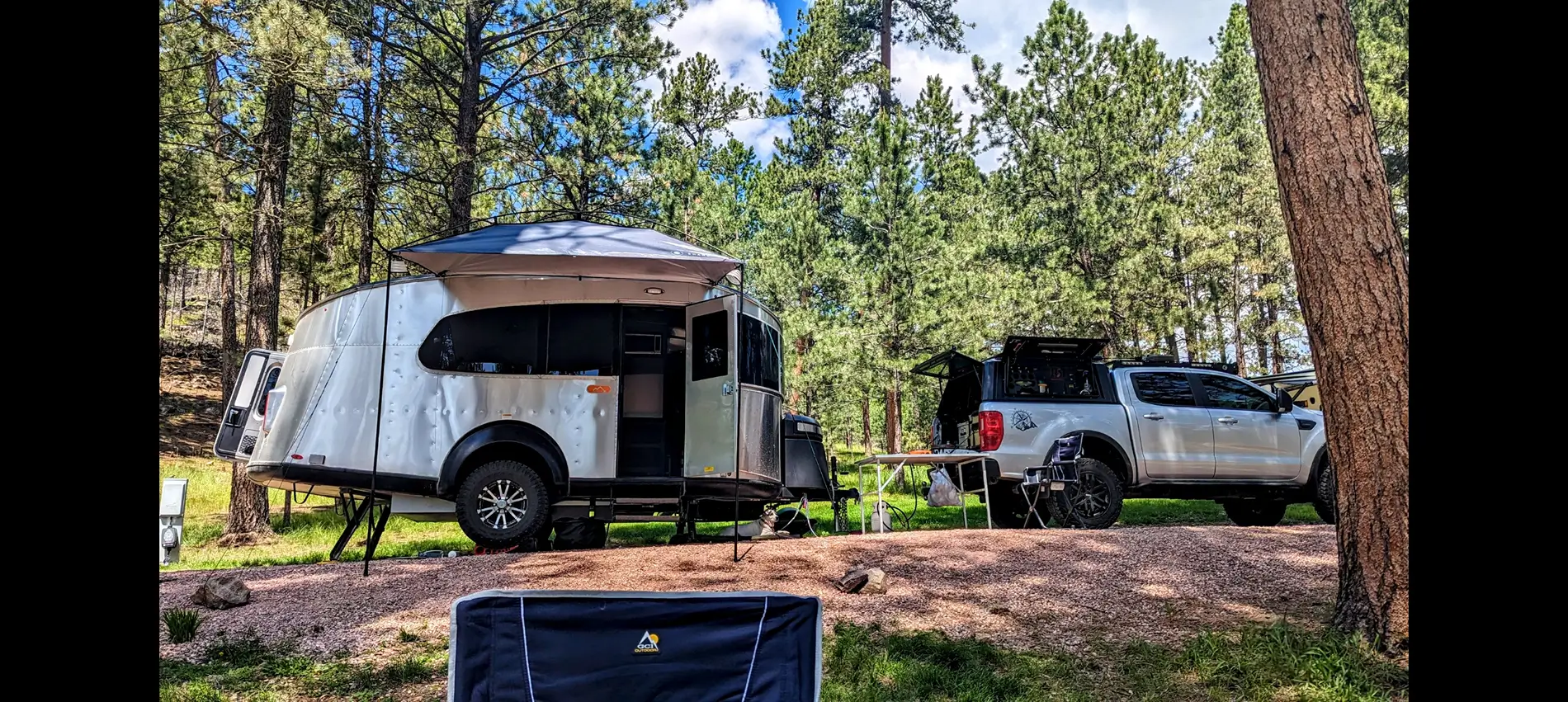

Super nice trailer and a good match for the Ranger. Have you ever weighed it? Sources claim from 3,700-4,500 lbs which is a crazy range when trying to figure weights.
I had a 16' Scamp that was supposed to be "1,750lbs" but weighed ~2,300lbs on a scale!
I haven't weighed it but I should. I really like it. For a smaller camper it sleeps a lot of people.
