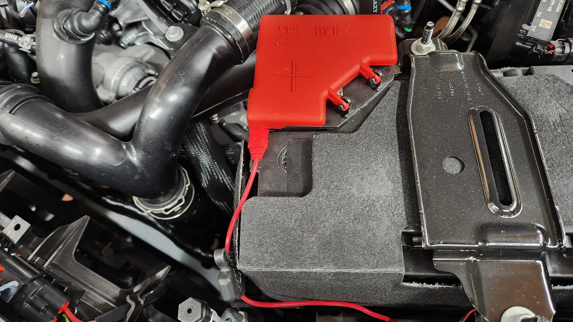

The Noco charger I purchased is to be mounted on the vehicle. I'm trying to figure out a place to mount it out of the way and reach the plug in easily.
Is it the NOCO 2D? If so I can give you a step by step, I put one on my 2025 XLT as soon as I brought her home.
Yes sir! That's exactly what I bought. I just need to look deeper into where I can mount it. Any suggestions?

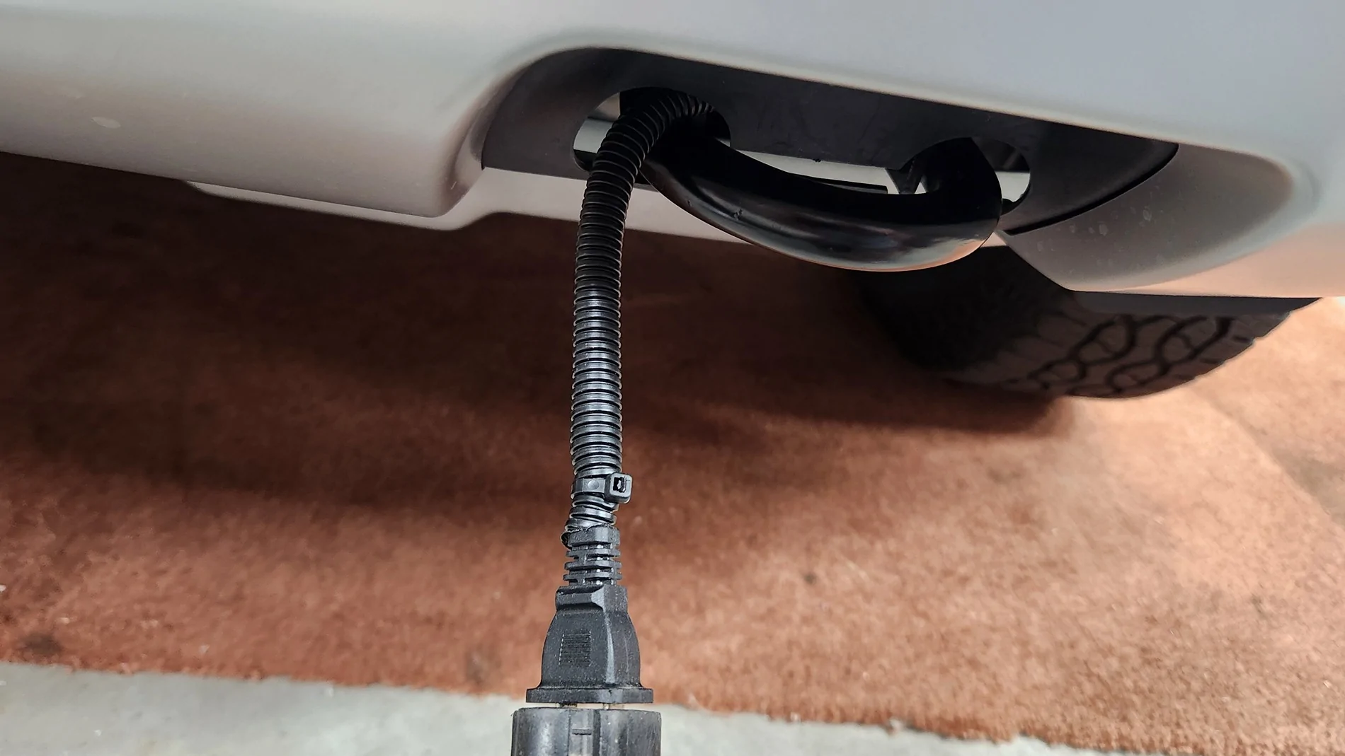

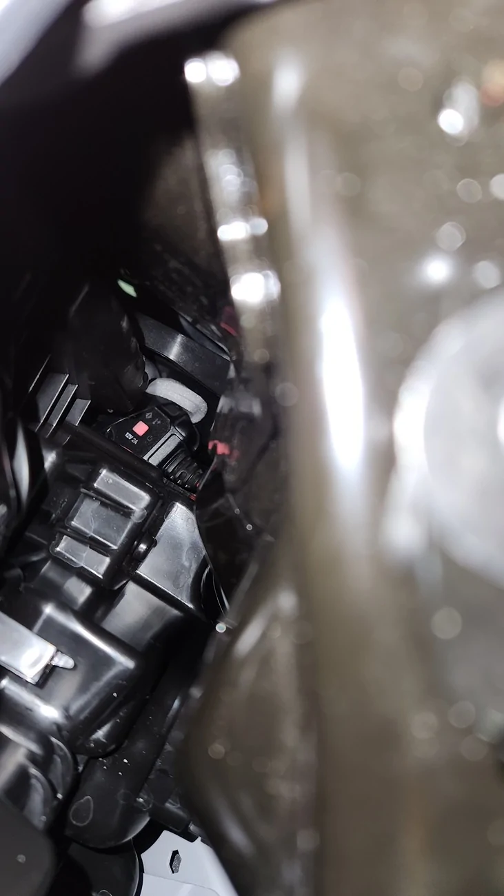

Yes, I put mine down along the radiator support by the left headlight. There is a fat wire harness down there you can zip tie it to. That puts it at the right level so the cord can stick out at the tow hook about 6" and there is just enough charge cable to neatly reach the battery. When not in use the cord rests nicely in the tow hook. (I covered it in 3/8" plastic corrugated conduit) I connected the negative to an unpainted bolt right in front of the battery, you don't want it on the battery post as it will bypass your BMS.
It's tight working in there especially if you have big hands. Remove the skid plate for better access.
I put a little piece of foam padding on the bottom of it before I zipped it to that harness facing upwards. It's hard to see but when you look down there you can see the red and green lights when it's plugged in.

Thank you very much! I was trying to put the put plug in up higher and the shutters for the radiator wouldn't let me. I like the way you mounted yours. That looks clean and neat! I'll get that installed this coming weekend. Thanks again!
