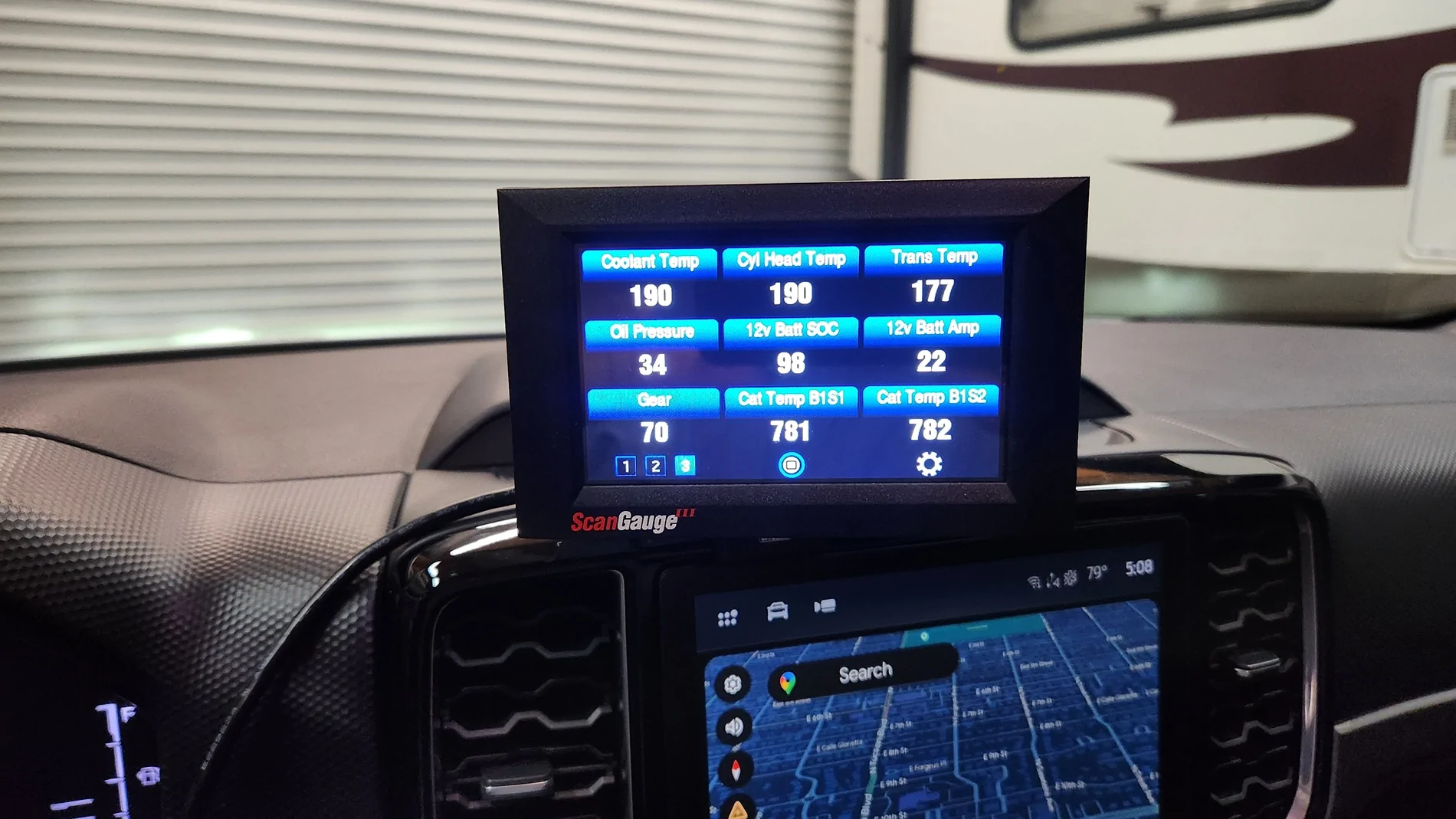

stemplar
Sep 7, 2023
813
1,185
Pennsylvania
2025 Ranger Lariat 2.7
Scangauge?
Yep! Scan gauge 3, to be specific. There’s a lot of info exposed, but what caught my eye was that after scanning in the xgauge section for Ford’s I saw there are not 4 but 6 tire monitors exposed by the obd interface, so I’m looking forward to seeing if I can monitor either my spare or two trailer wheels along with my primary 4 wheels.

The optima is a type of AGM battery, so no worries about incompatibility. Optima claims it has both cranking and deep cycle characteristics...and that has been my experience.
bigb
Aug 6, 2025
62
816
1,000
Tucson
2025 Ranger 2.7
Using SG3 as well, at least for now.
