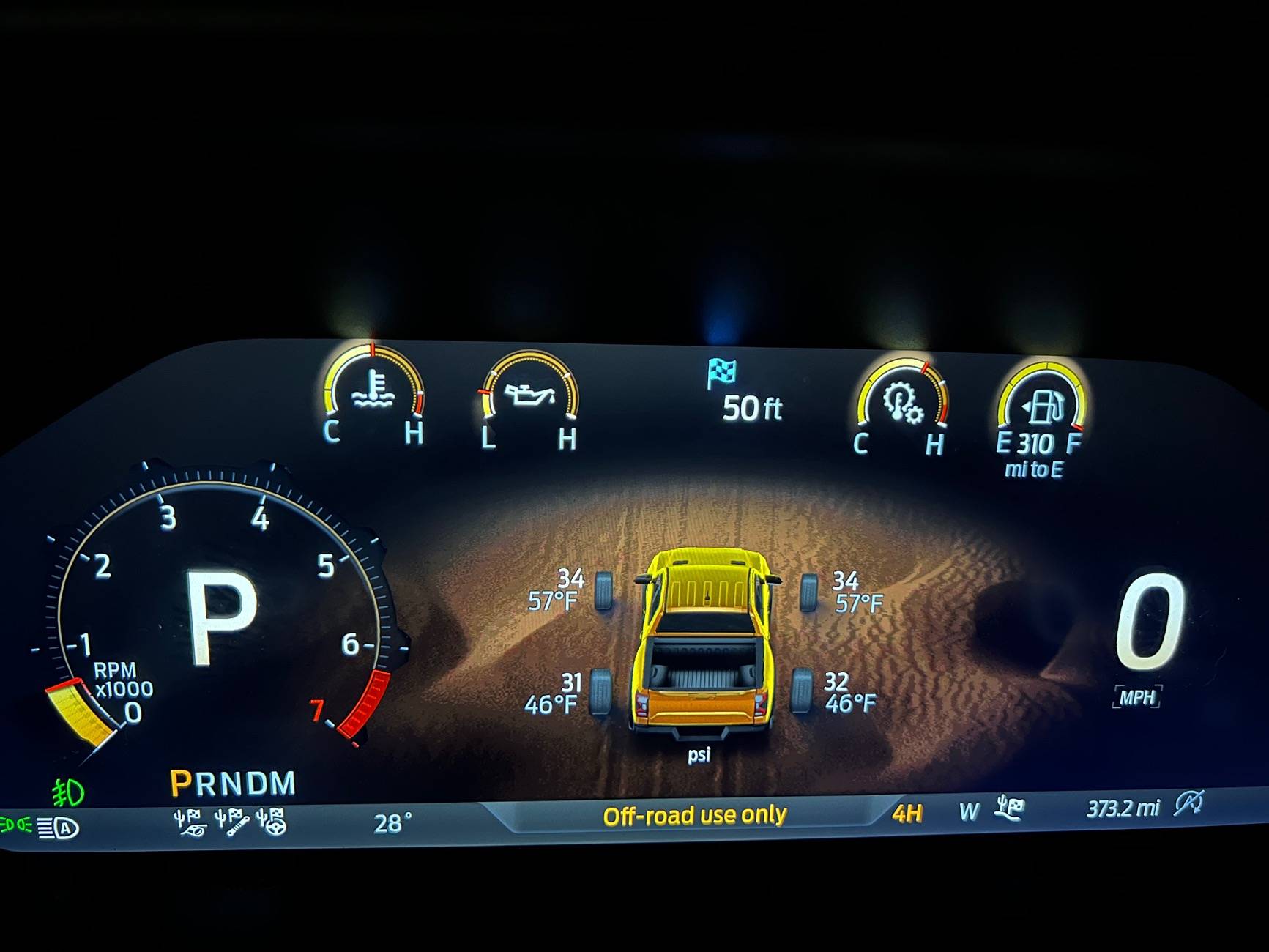

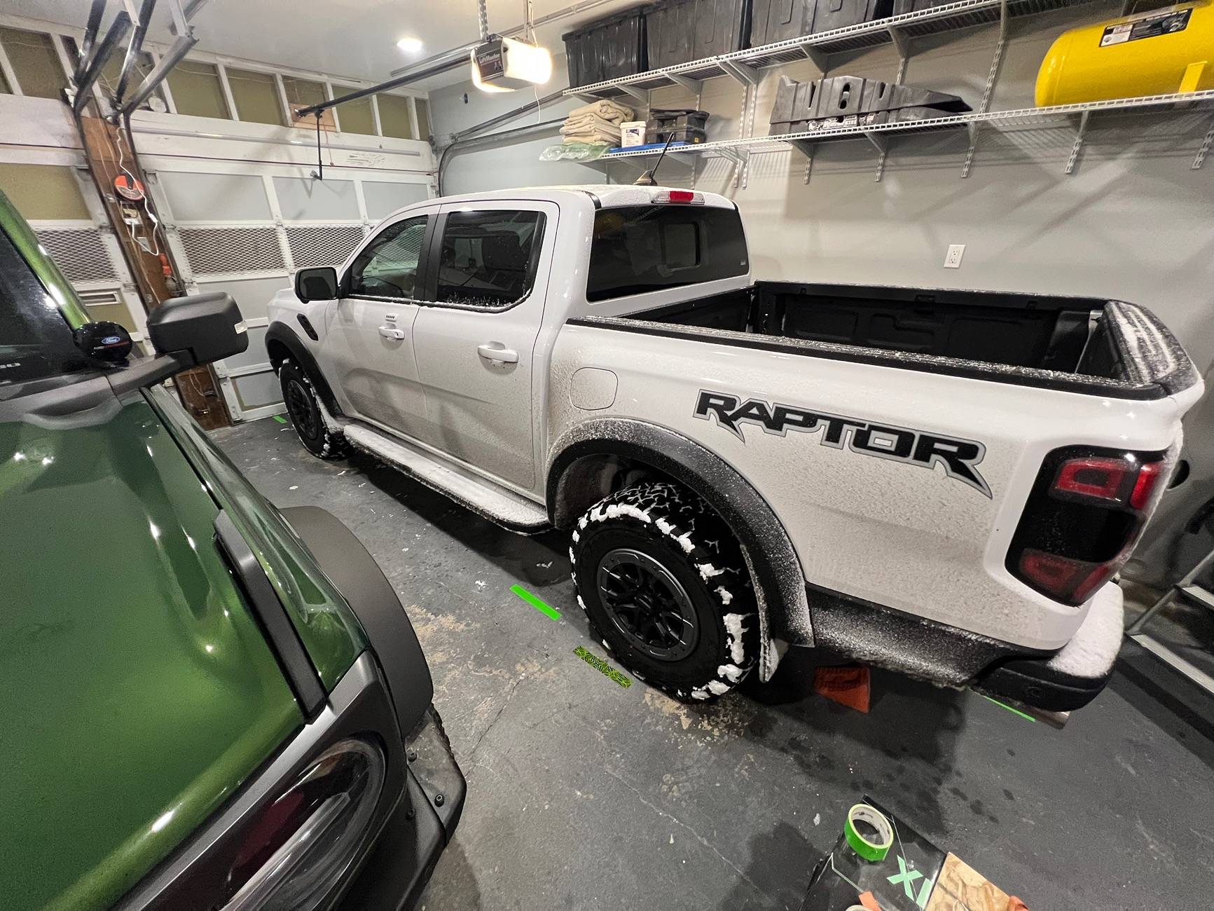

I just went out testing in the snow and tried different pressures. I am in Colorado Front range area. There are tons of different terrains to play on.
I did all these combos in Baja Mode 4H to limit nanny features spoiling the fun. No traction control for testing or as much as Ford will allow us to turn off. My wife came along and gives me her review.
First attempt was 36 Front 34 rear. Tire temps never went above 65F front and 55 rear. I had ok forward drive up hills and good forward acceleration and stopping in straight lines. There was very little lateral grip especially in the fronts. Understeer was present a little off power around corners and massive when on power. At these pressures it was best to rotate the vehicle with throttle slide then accelerate in a straight line when the RR settled. Not a good combo kinda scary. My wife was NOT happy with the lack of traction.
I then set the tire pressures to 34 front and 33 rear. Tire temps came up a touch and I was able to push the vehicle harder. Little more front grip but still lots of understeer. Straight line acceleration and deceleration we marginally better. The front tires were able to pull the truck through corners a little more. The tires were staying pretty cool and never got any hotter than previous tests. The wife was still unsettled by the front slide and unstable feelings. The wife was again not happy with traction levels time for a reset.
I lowered pressure to 33 front and 31 rear. This setup was much better. Great forward drive out of corners. A fun and manageable amount of understeer with low to moderate throttle in corners. I was able to get on the throttle hard and really pull the front end through the corners if needed. Once I got the truck rotated and pointed the correct direction it would shoot forward. Tire temps did get into the 70s. At this point I was able to get my wife to grab the arm rest and brace while she let out a whoooo in a fun way. She was less scared and leaning more towards thrilled. I couldn’t get her to take a video sorry no free hands. She is used to me testing all our vehicles like this and finding the hard limits. She will definitely hoon our Bronco but the RR is a different animal. It’s time to take her to RR Assault School.
At this point the plows were out and I’m sure all the neighbors were confused by a RR in Baja mode singing at 4-5k around the area.
First impressions about the KO3 with pressures too high Mehhh… I didn’t like the low lateral grip in the snow. The tire will go from traction to no traction more suddenly than other tires. The KO3 was unforgiving in a turn. But it has great forward bite and goes like a rocket in a straight line in the snow. Once I sorted out pressures driving was much more fun. The lateral slide was a feature not a flaw. If you rotate the vehicle with throttle then straighten the wheel and squeeze on the throttle a grin will be plastered on your face.
I will try the 33 front 31 rear on a warmer day and see what temperatures I’m getting.
In comparison to other tires.
But my odometer only has 373 miles on it and at least one of those miles is now wheel spin!! When I get more dirt and sand miles I can report back. These tires might be the key to great fun slinging dirt and going fast.
