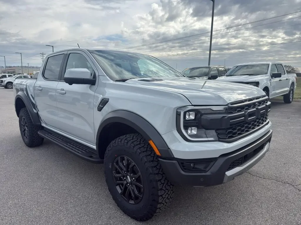

Wow I had not noticed that until now!
Your absolutely correct.
They gone!
This is another 26 model I pulled random pics off of cars.com sale listing.

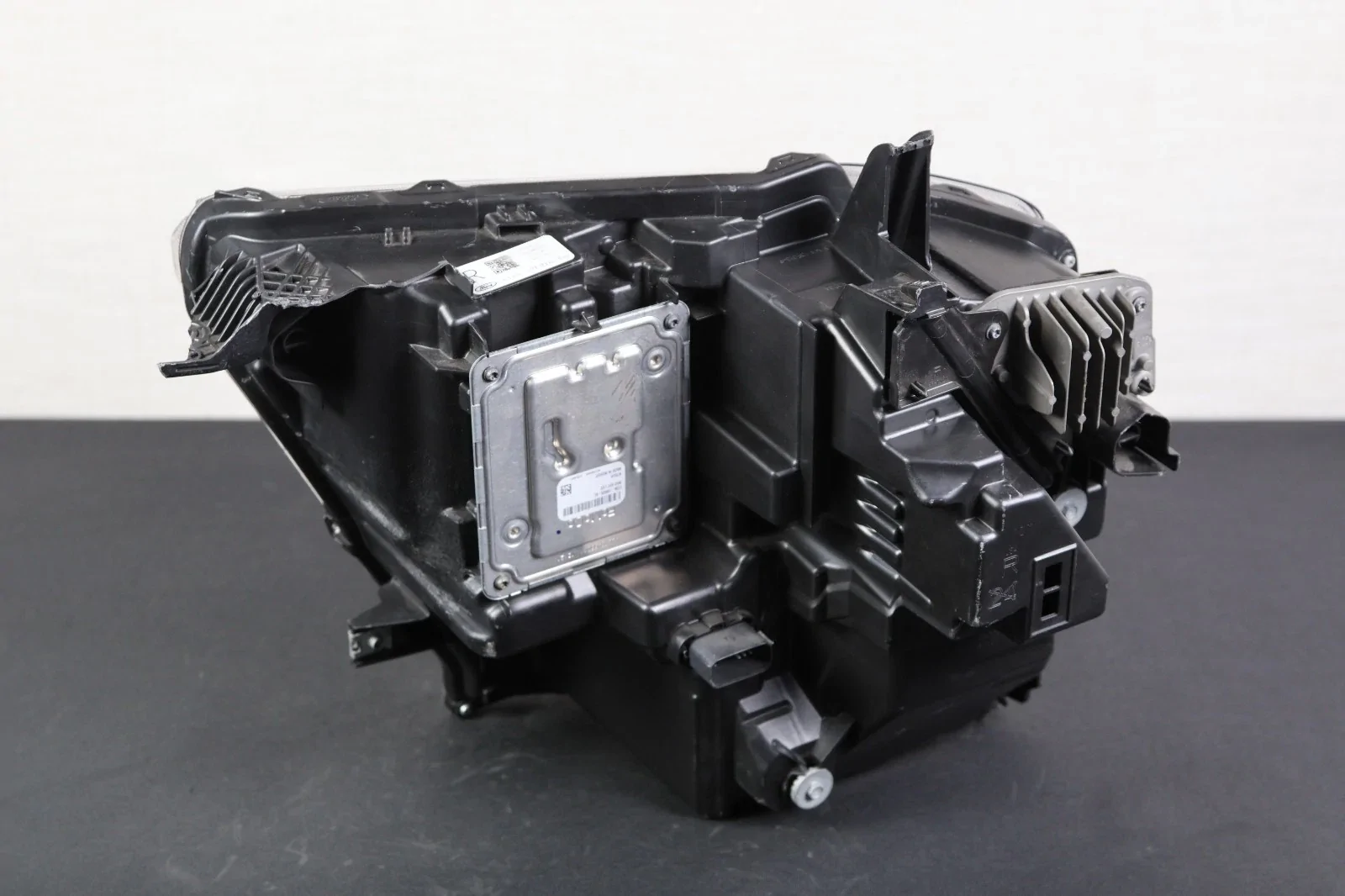

Nope all stock. I think I get flashed because stock Ford has both lights on in low beam. When you change it to high beam it just a internal door/flap that changes the direction for the high beam.
I am skeptical this is the case. I had a car with HID projectors where you could see the motion of the light as something physically moved when you turned the high beams on. My ‘24 Lariat doesn’t look like that at all. In fact it has the cute feature where auto high beams fade in imperceptibly but cut out instantly.
Knowing the ‘24-25 Lariats and RR have the matrix LED hardware it’s more likely that “high beams” are just extra matrix zones that turn on or off. Also a good guess why they’re being removed from the US Lariats: Word is that Ford abandoned activating the matrix anti-glare due to incompatibility of the system to meet US market rules. So there’s a ton of extra cost in those modules that’s sitting unused even in the 24-25 years.

I did the Lariat projector headlight swap recently. They’re not truly plug-and-play; either grab the Lariat front-end harness or be ready to repin and change BCM as-built with FORScan. If you’re buying from online auctions, make sure the LED drivers/ballasts come with the housings and ask for 6–8 inches of pigtail—lots of sets show up missing modules. Plan on a full donor and time with FORScan if you go for the full intelligent access route.
