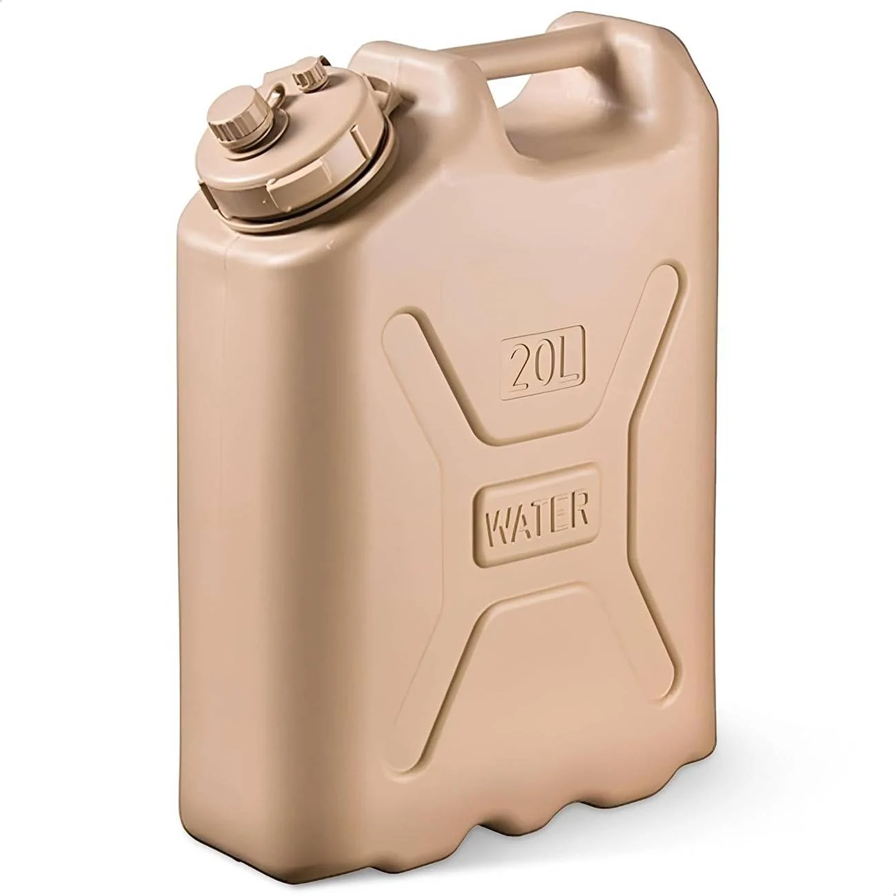

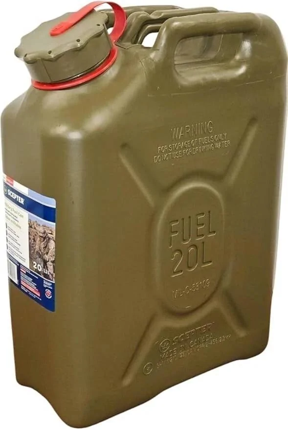

Speaking of fuel can, I have spent some time trying to figure out a good "common" fuel cannister that everyone can agree on. I'm not a huge fan of the spouts that we must have on cans now. I spent 8 years in the Marine Corps using the plastic jugs with lids on them. I'm fully qualified to pour fuel. ?
That being said, I would love to hear your feedback. The NATO fuel cans are easy to come by, very cheap, as compared to some of the more popular overlanding cans on the market and are obviously super durable. Scepter, the company that makes them for the military, also makes the same can for water storage. So, building a jug mount around this can would net a fuel can mount and water can mount. One on each side of the bed of the truck, secured to the MOLLE panels would be pretty cool.
We do already make a mount for the Scepter water jugs, but it would not be a great fit for this application. We are working on a new design, specifically for wall-mount applications.
Existing mount - https://americanadventurelab.com/product/universal-nato-jerry-can-mount/
Fuel can - https://ebay.us/m/1Eteyw
Water - https://a.co/d/bhJClnT
For bonus points, would you choose the 5 gallon jugs or the smaller 2.5 gallon jugs?
Small jugs - https://ebay.us/m/nRC50t

I already use two of the water versions of these for drinking water on my longer trips, in conjunction with an 8 gallon tank on my trailer for showers / dishes / etc. I currently bungee them down either in the bed of my truck or the trailer. Having a purpose built mount would be fantastic.
I wasn't aware they had fuel versions, and I'm in the market for such a thing. I'd probably go with 2x of the 5 gallon and either use only one when less is needed or partially fill when a full 10 gallons aren't needed I'd rather user a portion of a total capacity than find myself limited.

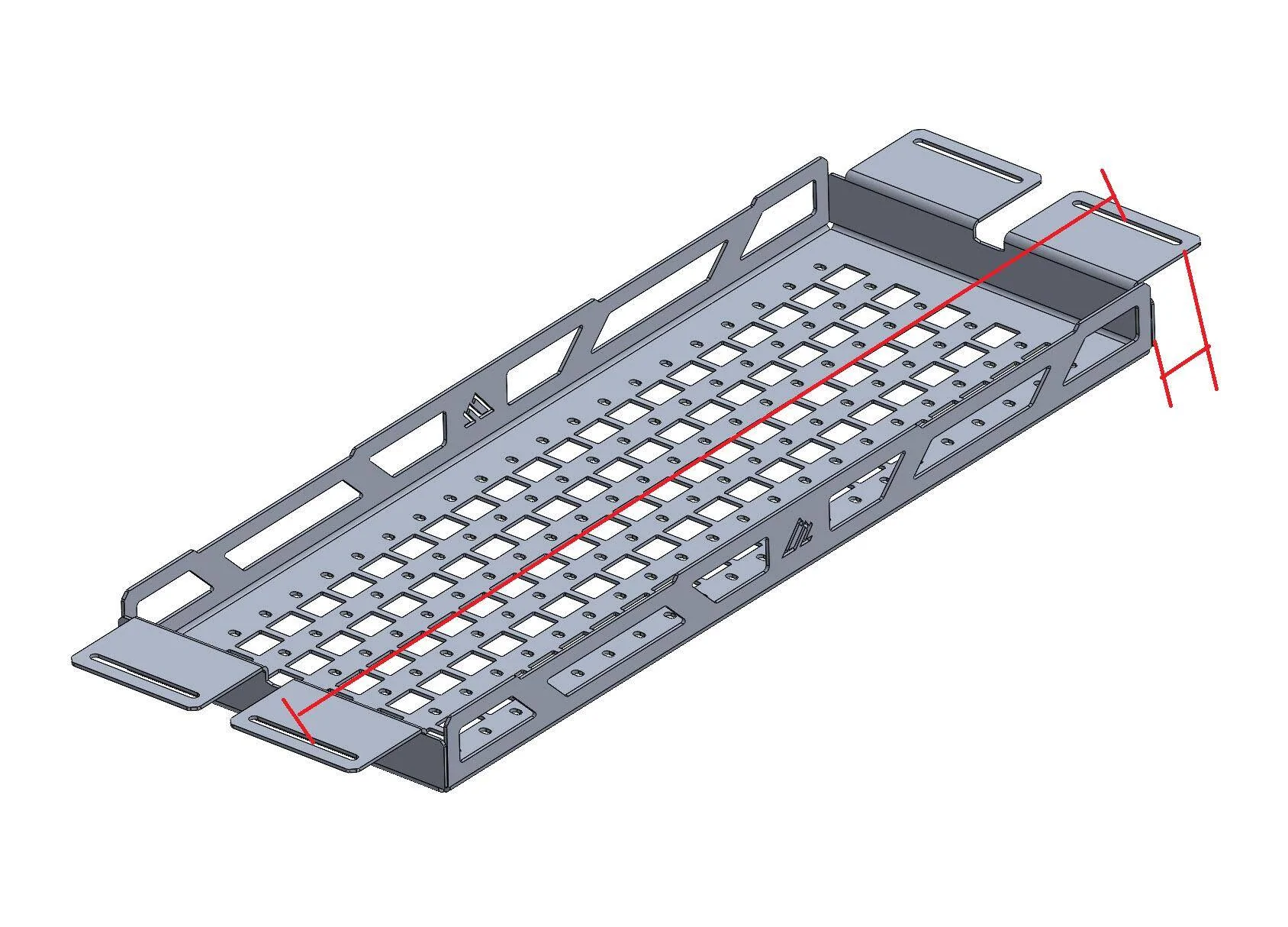

When you get around to it, I'd like to know these two dimensions on the Tool Tray. I'm thinking about adding it to my Kuat bed rack.

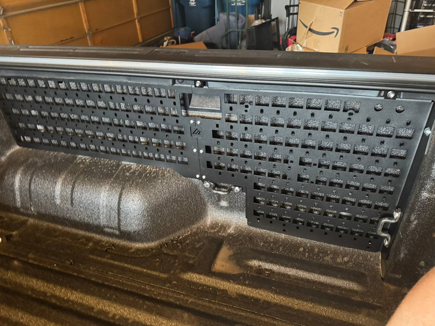

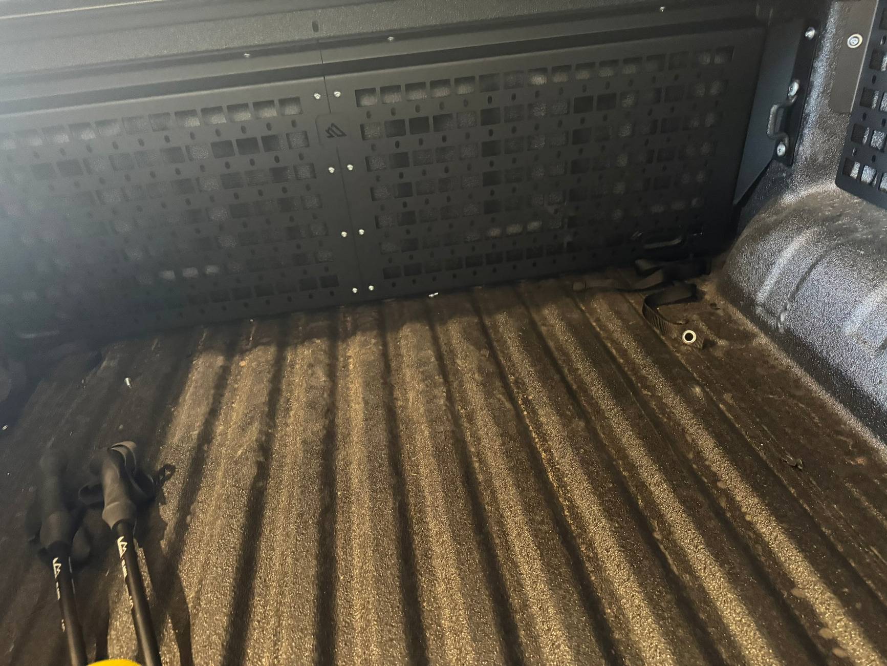

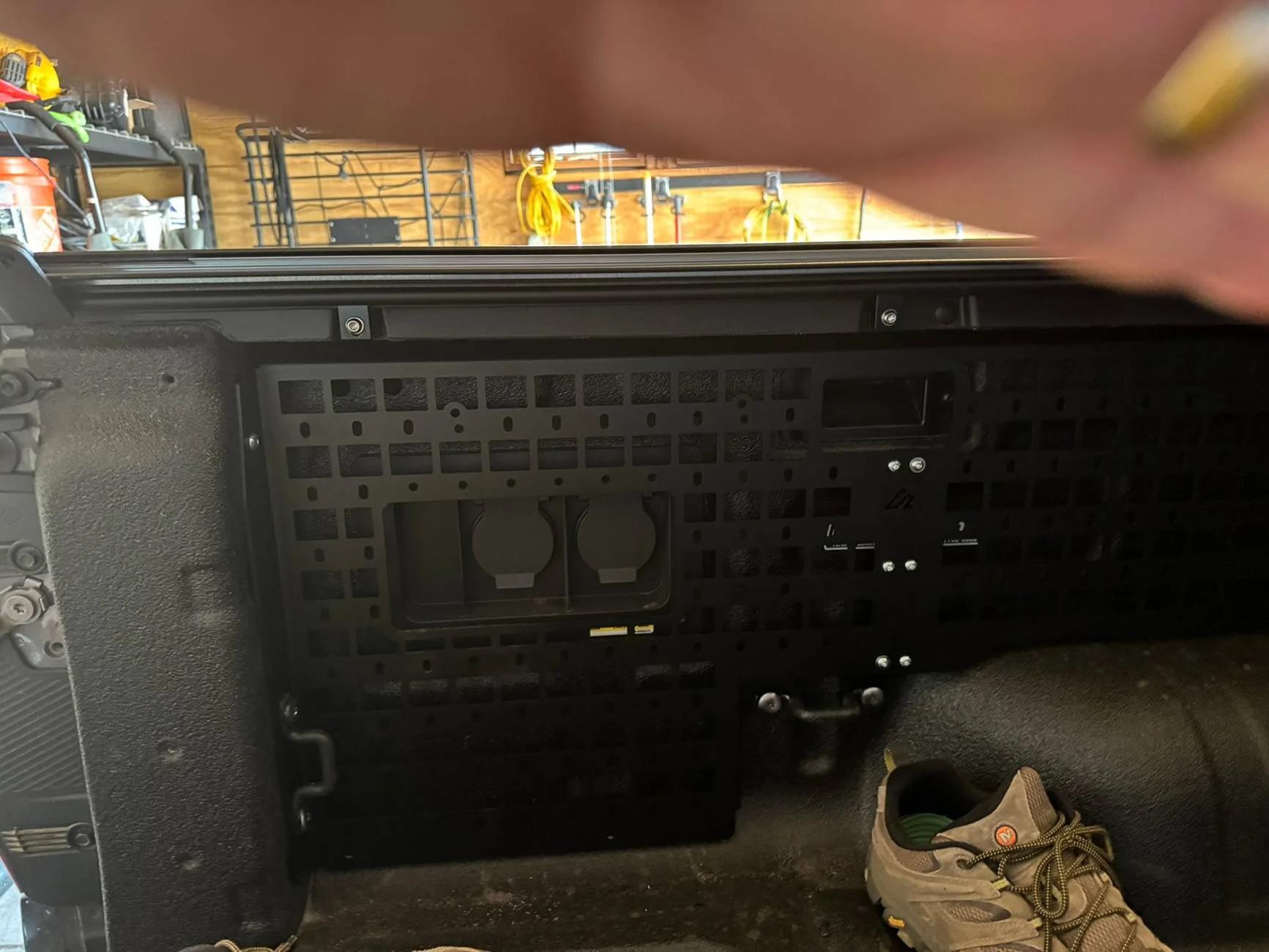

Just finished installing mine. I will state, there is so much aftermarket crap, these panels are not in that category. Exellent fit and finish. Very light, but when mounted they feel very strong. Very Little bed space is lost, IMO, bed space will be gained using things like QuickFists. Install was easy. I did not read the instructions, so there was some trial and error.
The only "difficult part was mounting the top 6mm bolts for the bulkhead panel. I sacrificed a number of nuts to the top of the fuel tank.
I did not need the nutzerts as my 2025 has them for the front panel on each side. The bolts for the tie downs came out easy with a small impact, and went in properly. There is thread locker on them.
To install the bulkhead upper bolts an angled needle nose will help.
If you have bedliner sprayed on, get 8mm and 6 mm Taps, Starting or Plug type and be patient.
I have a background as a machinist and machine mechanic so I know how to use a tap to chase threads without ruining them.
Your bed cover will need to be remover to install the bulkhead panel.
Suggestions: Nutzerts for the packout panel attachment points.
I have the BAK revolver M4S cover .
