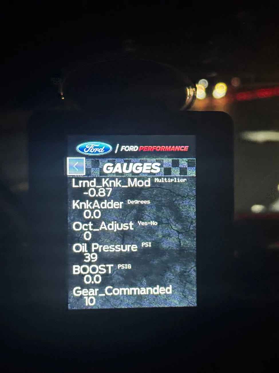

Just found something that may be similar? Says Lrnd_Knk_Mod. Here is what I’m looking at.
Ford Ranger Octane Adjust Ford Performance Tune? 25 RR IMG_1106

Shoot no that's something else

What’s odd is today the learned knock modifier went from the -.87 to a -.88 while I was driving. To me, it appears like this value might be similar to an octane adjustment value indicating a certain level of performance with the given fuel, although I could be off-base on that. The truck is definitely varying time as indicated on the tuner. The question I have, is how do I know based on the timing advance number and the learned knock modifier, if the truck is performing its best or not. For the timing advance, I tend to see anywhere from 0 to -33 degrees with an occasional positive number around 0 to +5 maybe. My assumption was this number alone really doesn’t say much but that the learned knock modifier would be a better way to know. I’m curious what your numbers show on your tuner(if you have the performance tune).
