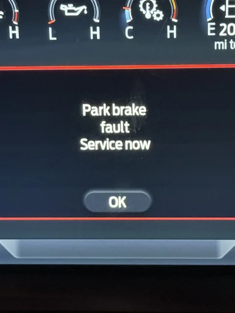

I did a 2" spacer lift over the weekend on the front of my 2025 RR. Everything went ok and everything is re-assembled and looks good. Problem is, this kicked of a Park brake fault and it seems my paring brake is stuck ON. When disengaging it the brake light on the dash blinks continuously. It appears that the brake has disengaged but it clearly is still engaged as I can't move the truck. I had the negative battery terminal disconnected during the work and have tried puling it again to reset things. Nothing seems to work. I have an ODBLink EX which I am going to hook up and see what I can do with this.
Anyone have anything like this happen?? HELP!!!!

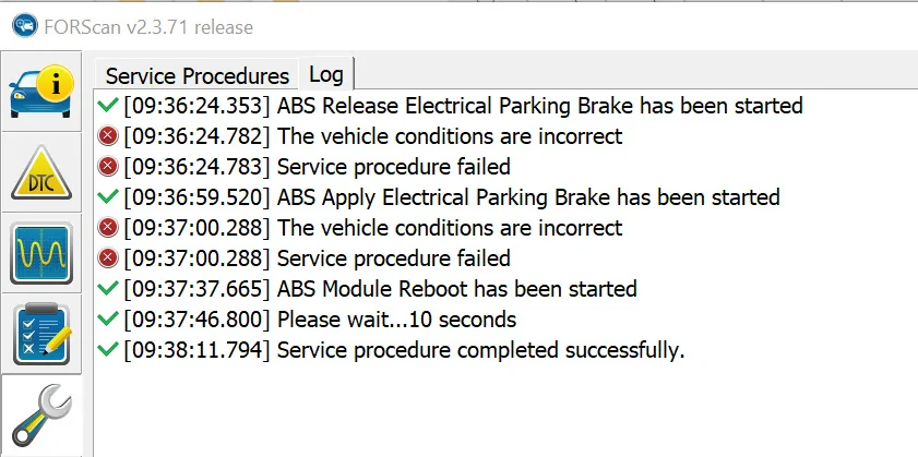

So I went into FORScan and it shows no faults. I tried the "ABS Release Electric Parking Brake" ALso rebooted the ABS Module - still no luck. Any recommendations?

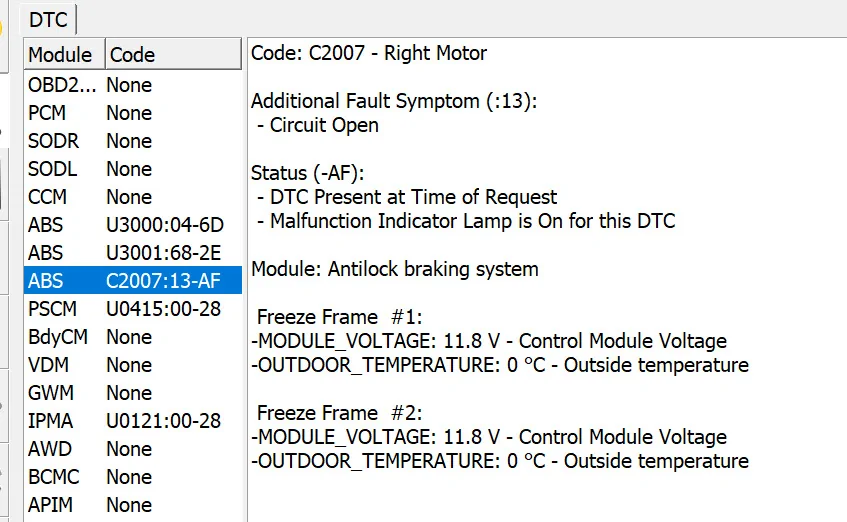

Here is the log - any help would be greatly appreciated

That last code on the ABS module seems related to the electronic parking brake on the passenger rear. Maybe wiring issues. If it were me personally, I would clear all codes and then recheck to see if they pop up on a new start.

It's one of the yellow icons near the "save log" button. I believe one deletes all of the codes while the other just the specific one you've selected.
Either way, looks like a "circuit open" wiring issue. Anything look out of place on the rear? How insulated is the wiring? Just as an example, I got a similar code for my wheel speed sensor on my Maverick and the 22-gauge tiny wires were "protected" by black Tesa tape. I couldn't see the nicked wires until I removed it.

I tried resetting with the yellow triangle icon...it still comes back with ABS error. I never touched the rear (yet). The one item that I disconnected from the front while disassembling the shock strut was the ABS sensor that goes into the front brake caliper area. It's a simple black plastic sensor that "floats" inside the front caliper/rotor area. All that is back in place. No broken or nicked wires. The truck only has 3k miles on it. I'm going to take the front wheels back off and doublecheck but I think the ABS module must have freaked out and I am going to have to tow it to the dealer. Hopefully not but I'll let you know.

Is the battery charged? 11.8v seems low.
