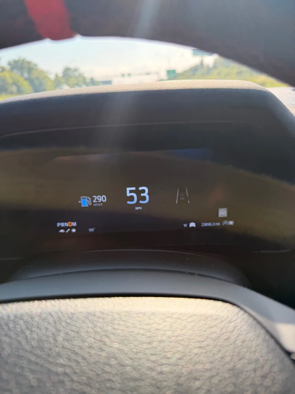

My instrument cluster changed in the middle of driving an hour ago. All my gauges and tachometer are gone and there is a new fuel gauge icon on the lower left side that was never there before. Haven’t been able to figure out how to get it to change yet. Pretty pissed about it right now. I see there was a sync update.

Thats the "calm screen".

Definitely didn’t make me calm…Don’t know why it switched either, I had both hands on the steering wheel and didn’t push any buttons when it switched. I guess it enabled itself in My View for some reason. Thanks for the info.

Definitely activated the calm screen.
