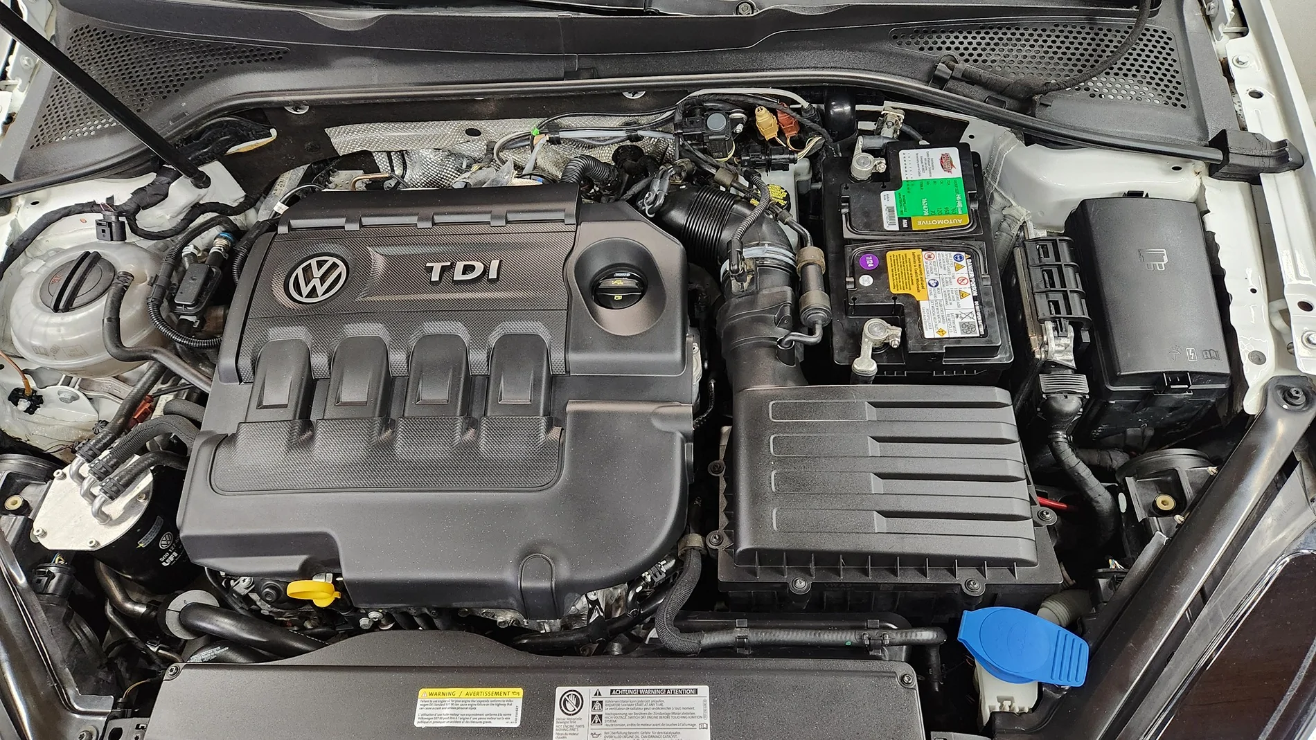

Hello folks! Went to top off washer fluid and noticed a bunch of gravel all over the top of the engine. I was pretty surprised since I baby this truck and I do not go off-roading at all. It has rained a lot in the Bay Area and the right side of my driveway gets a little muddy (my driveway is narrow, so the right-side wheels dig up grass), so I added gravel to that side over the last week. I have a very short driveway, so I go slowly in and out.
My question is, could gravel get stuck to the tires when it was wet and then flick up into the engine when I turn the wheel driving off? It is the only thing I can think of. I will power wash this out tomorrow during the day but wanted to get the community's feedback.
Pictures below

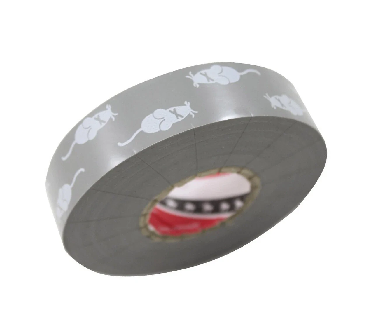

I bought some of this Honda anti-rodent tape when mice got under the seat of my ATV, built a nest and chewed up all the wiring. Wrapped all the wires of my Polaris Ranger too as soon as I saw some hay and a little bit of chewage.
Had them eat most of the fire wall insulation out of my 2005 Duramax over the 20 years of owning it too. It had a reputation of having an attractive odor.
Once I used this, never had an issue with chewing the wiring since. It has been in there for over 10 years now.
