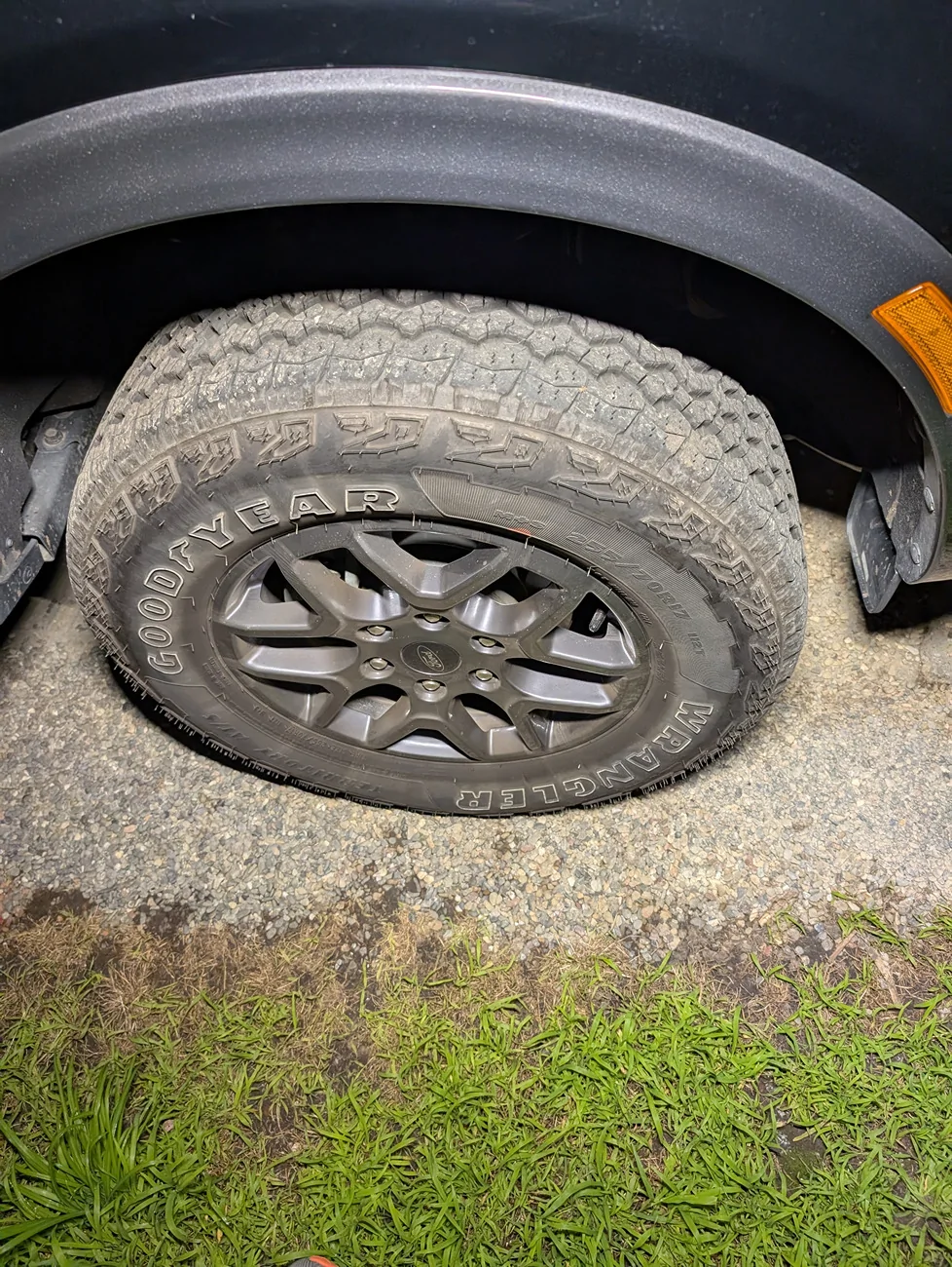

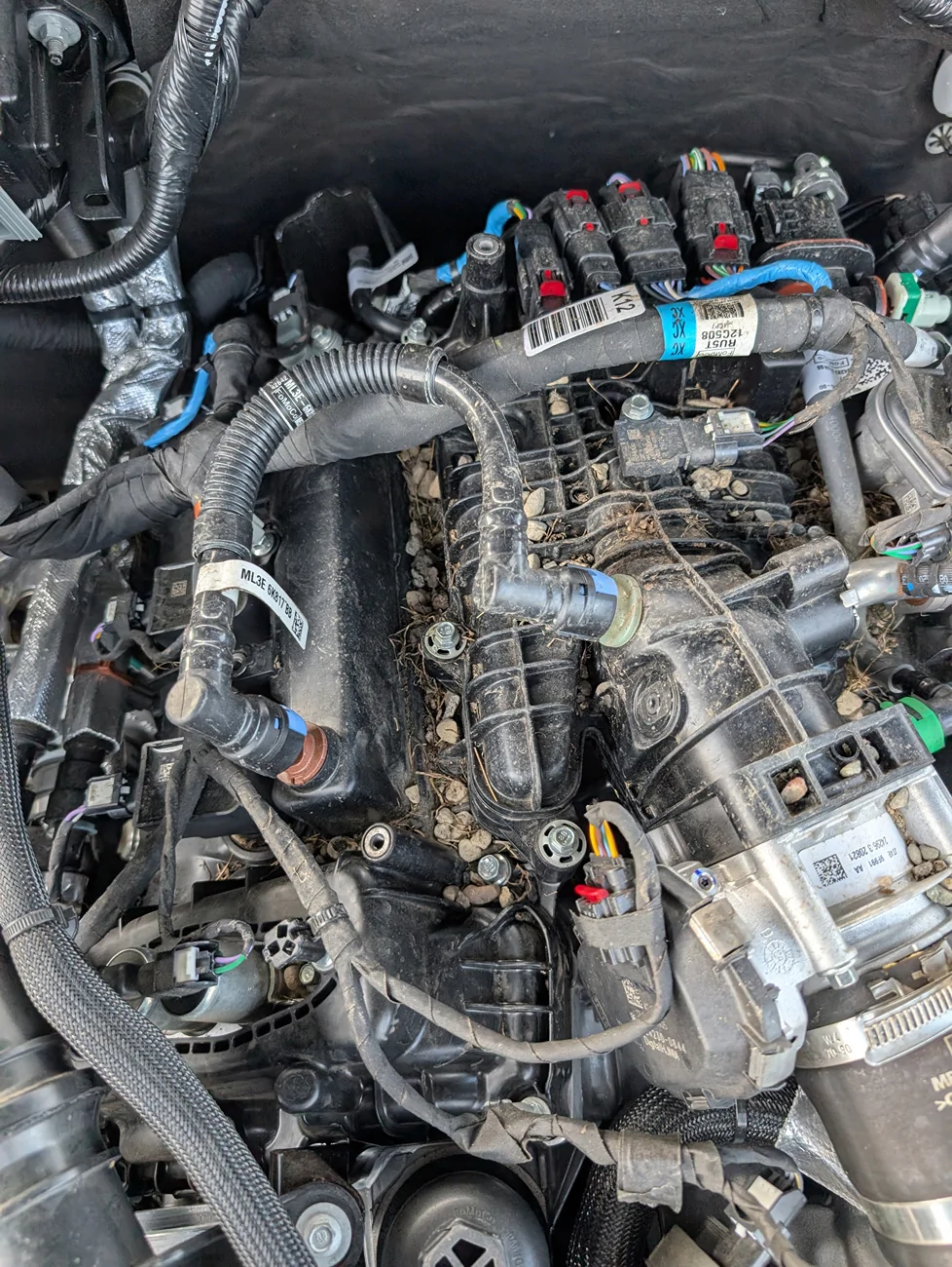

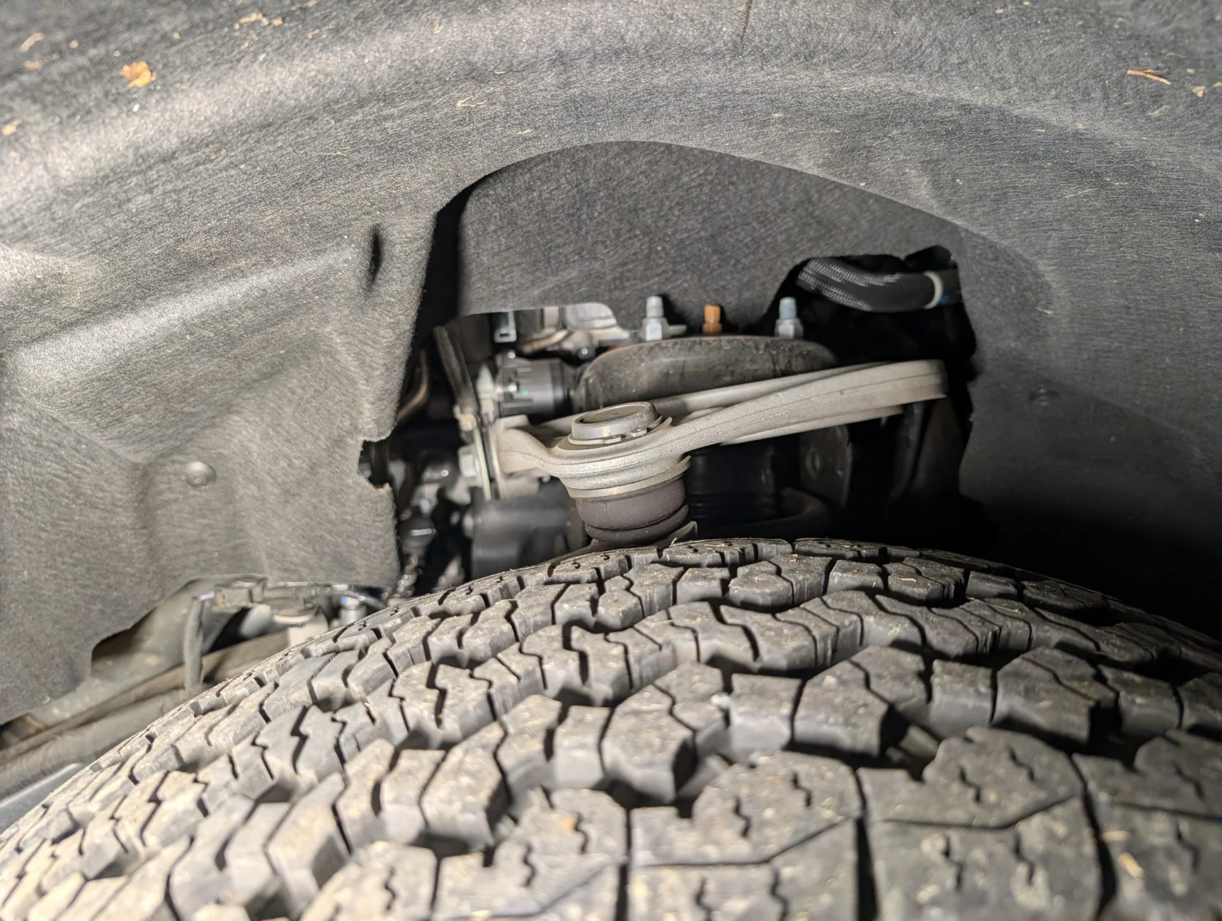

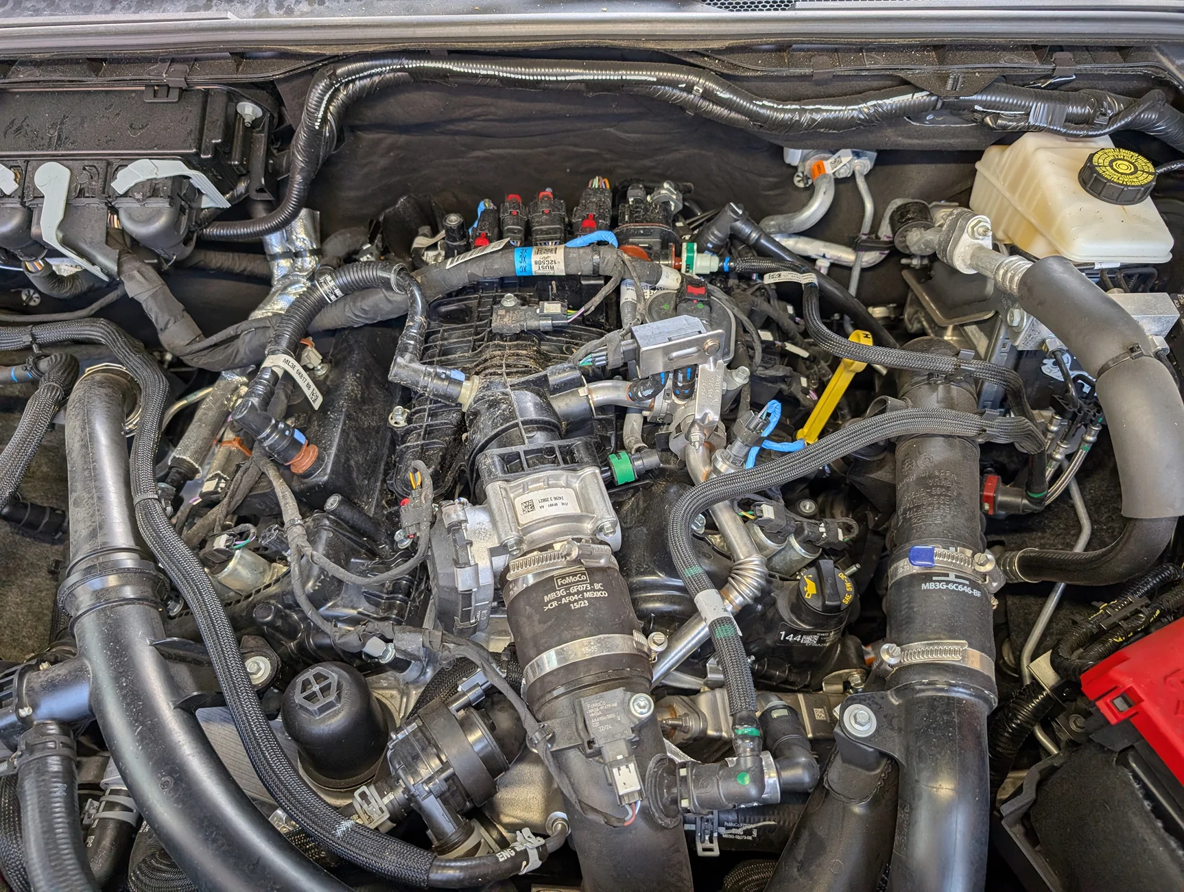

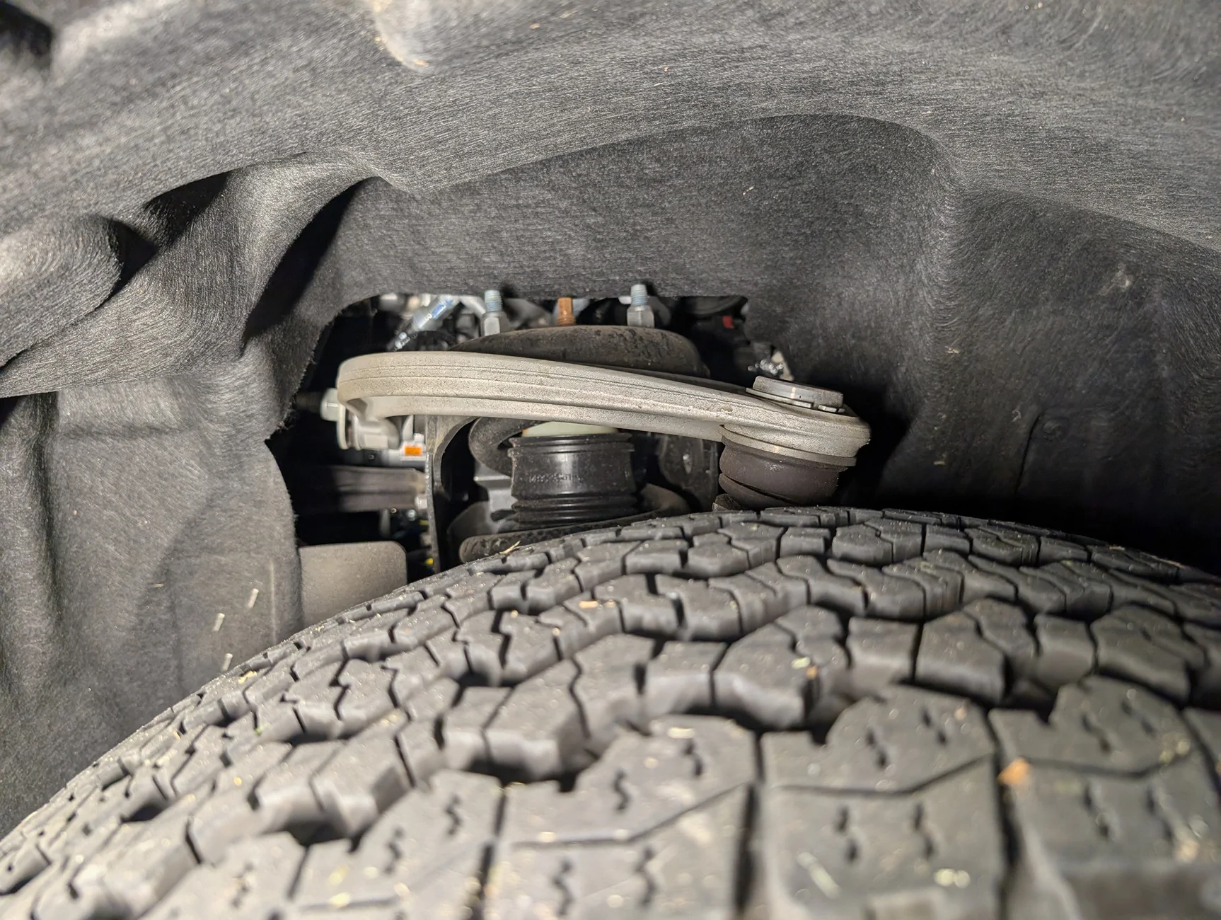

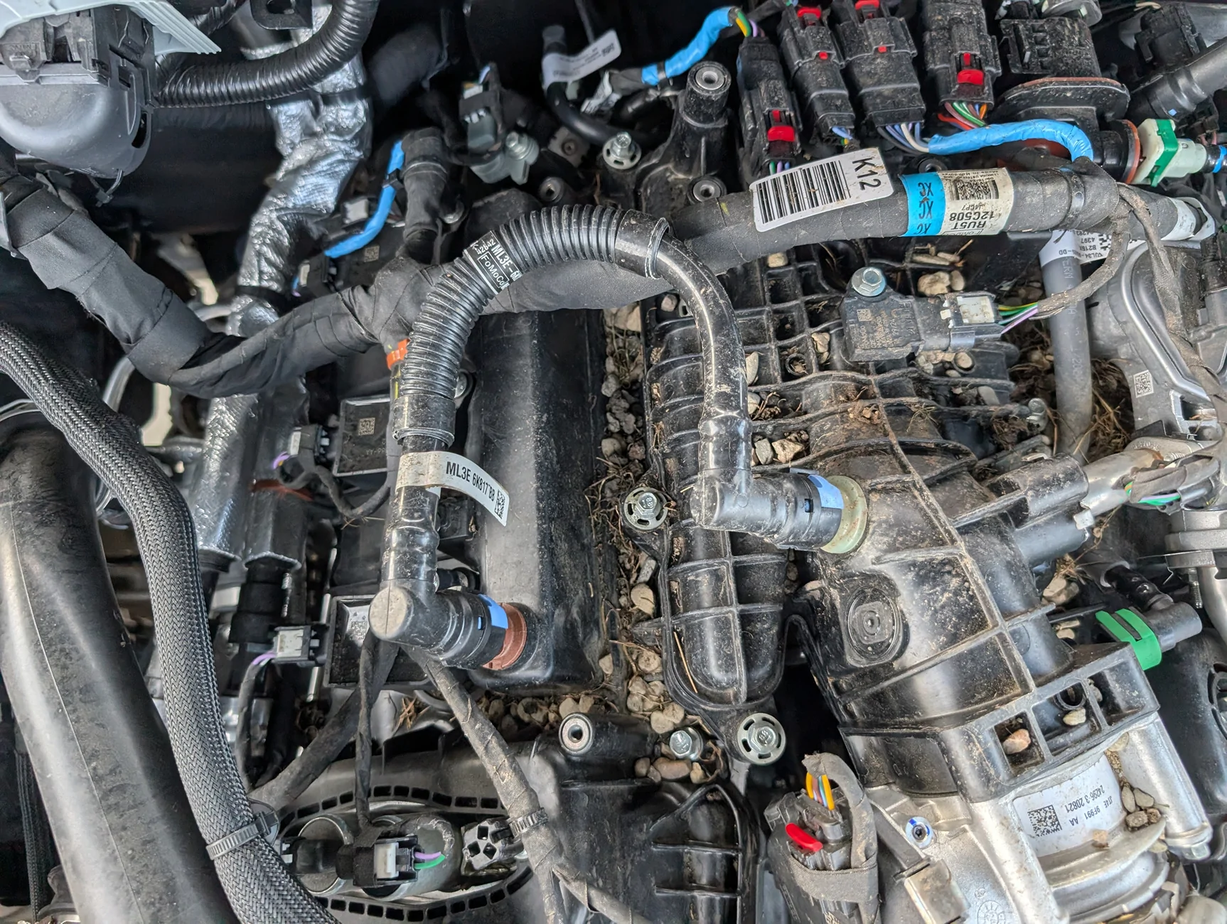

Hello folks! Went to top off washer fluid and noticed a bunch of gravel all over the top of the engine. I was pretty surprised since I baby this truck and I do not go off-roading at all. It has rained a lot in the Bay Area and the right side of my driveway gets a little muddy (my driveway is narrow, so the right-side wheels dig up grass), so I added gravel to that side over the last week. I have a very short driveway, so I go slowly in and out.
My question is, could gravel get stuck to the tires when it was wet and then flick up into the engine when I turn the wheel driving off? It is the only thing I can think of. I will power wash this out tomorrow during the day but wanted to get the community's feedback.
Pictures below

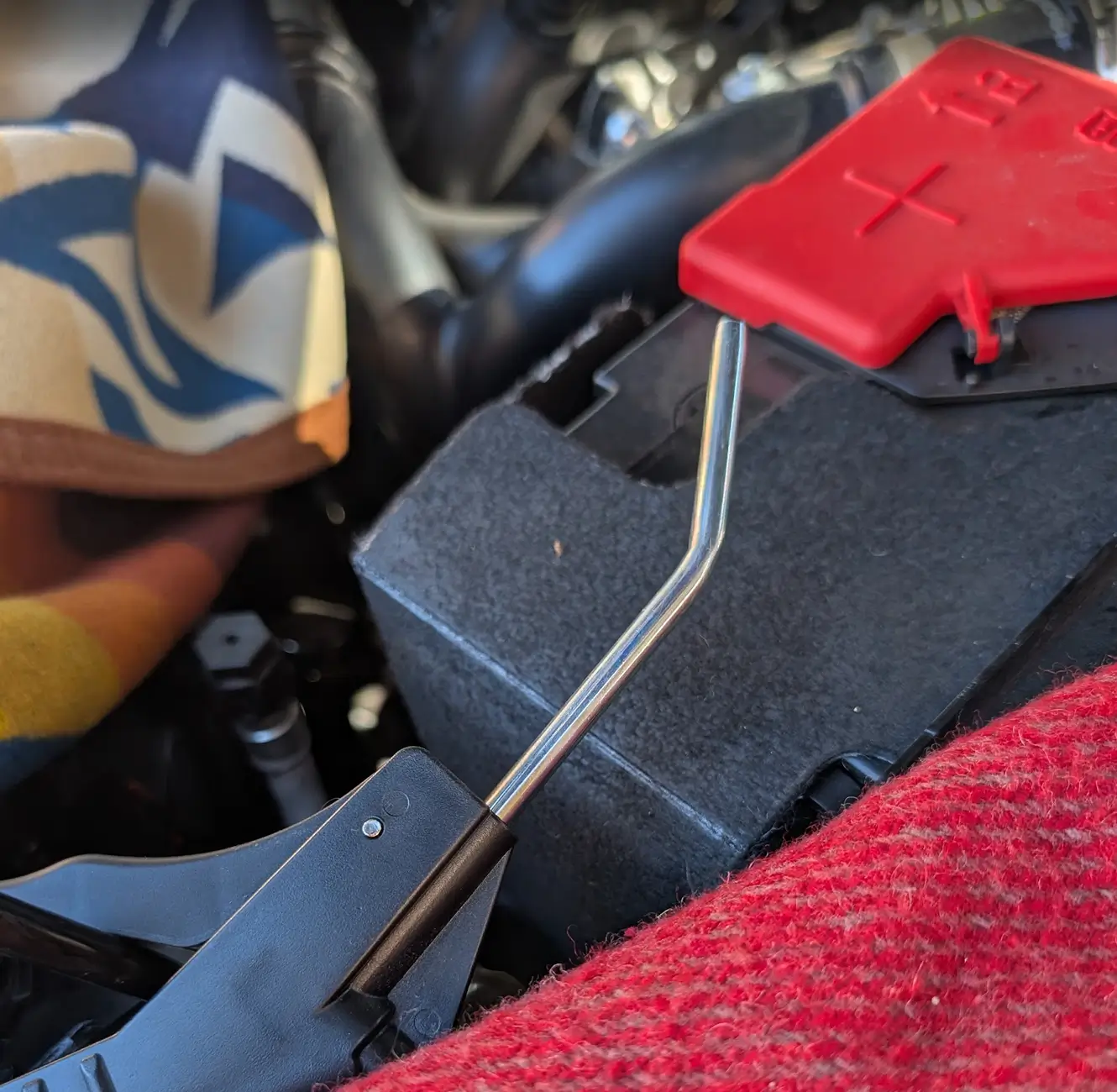

Hello everyone! Update: I got 99% of the rocks out. When I do the next oil change I'll see what under the engine and around area as well.
Thanks for the tips and feedback. To those who say you can’t power wash an engine bay: actually, you can. The trick is to use a stubby gun with 45 angle tip, hold it above the engine, spray downward, and let it dry. Spraying the jet directly into nooks and crannies is definitely not recommended. But don't worry, I didn't even use a power washer this time. My ford buddy says they use power washers all the time on the cars they service.

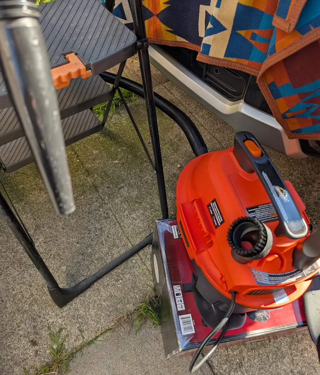

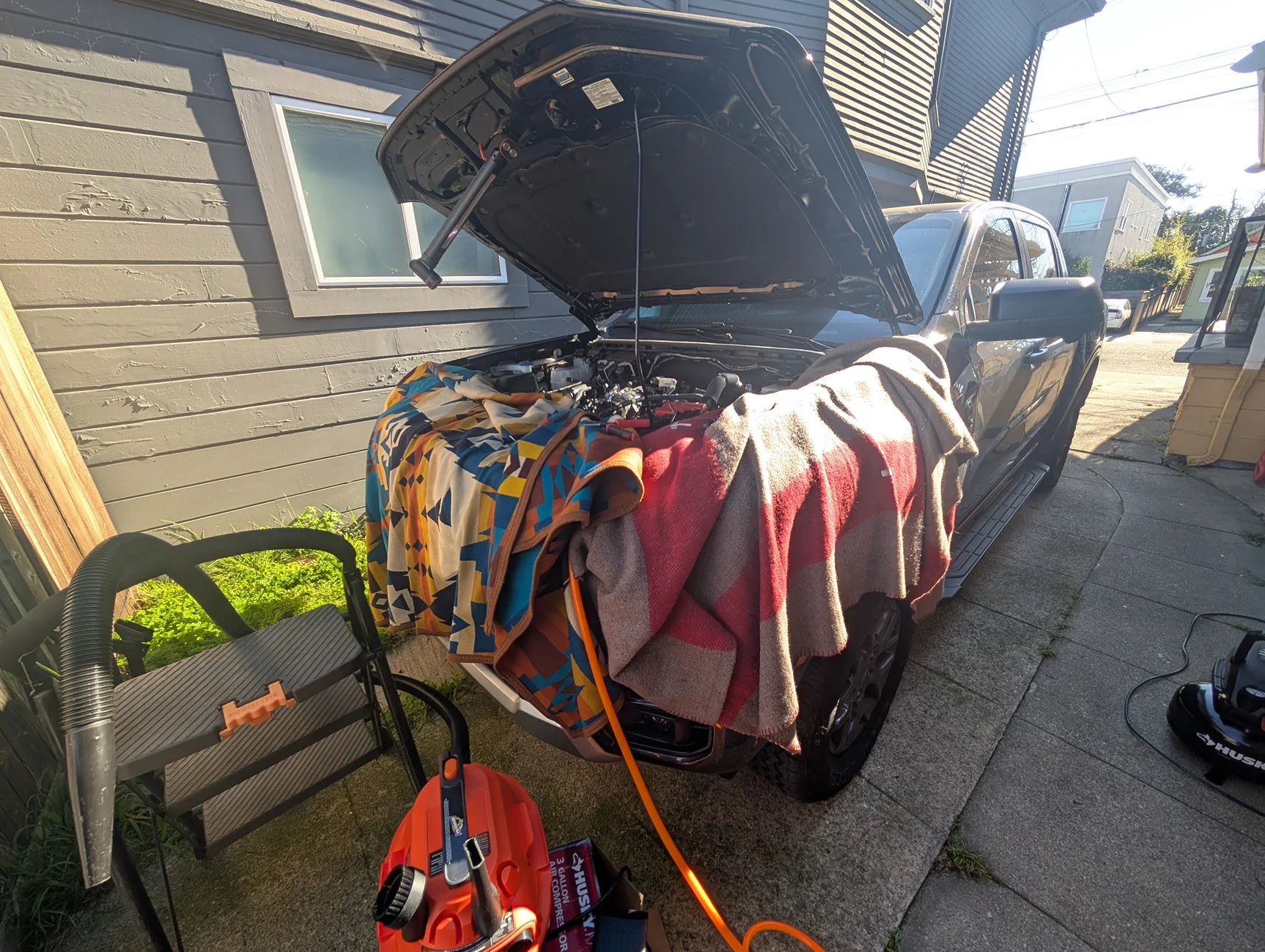

Anyway, with that out of the way, I was able to get everything I could see using a shop-vac and compressed air. The amoral shop vac was the ticket plus a pointed nozzle for the compressor
Took two days about 3 hours each day with a few breaks. Had to use both in tandem. Have the hose above where I shoot the air so the rocks that go flying get sucked up. I also had to use some hook, needle nose tools to get pebbles that were wedged in.

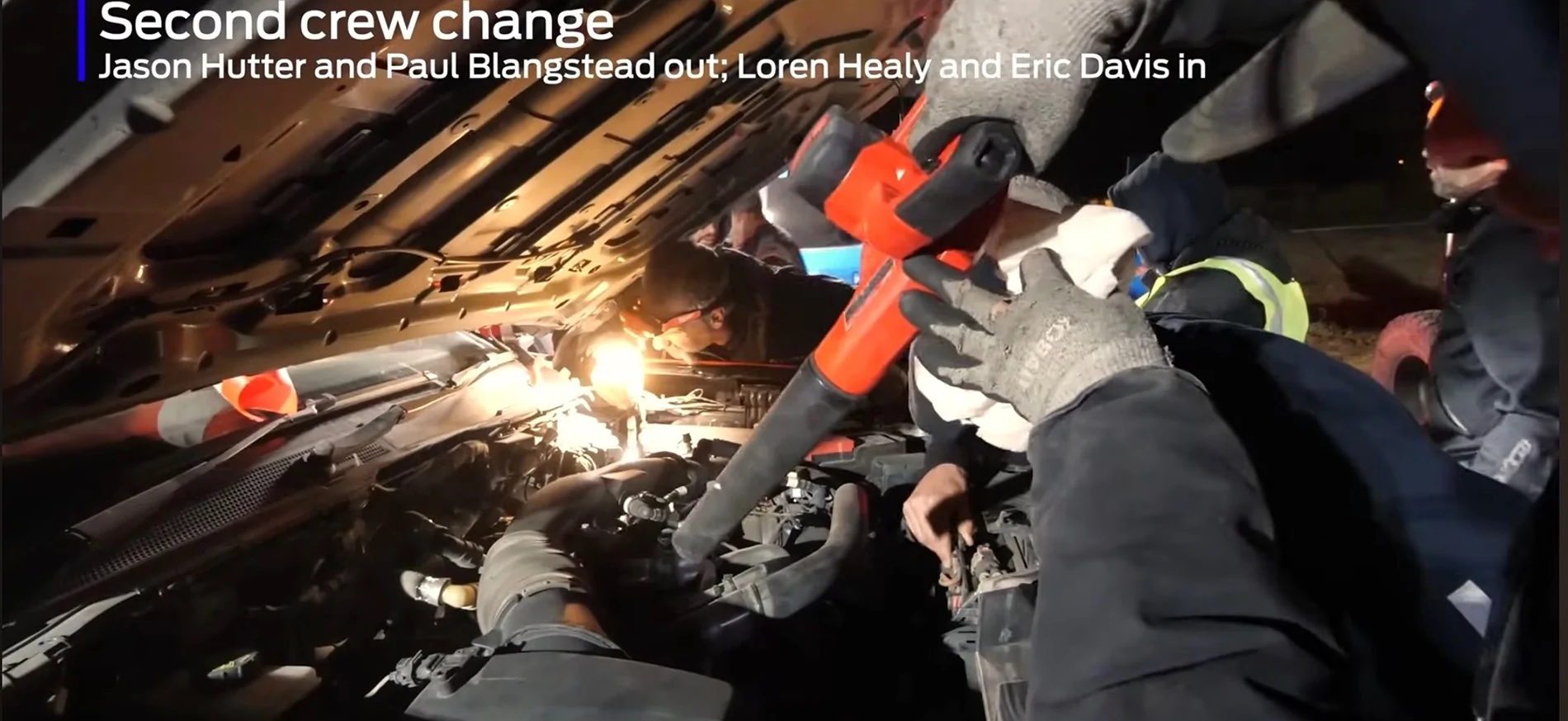

I stumbled across this post a while back and just thought I’d share this screen grab from the tough as finke YouTube series I watched last night. This is a driver swap / pit stop during the Baja 1000.
