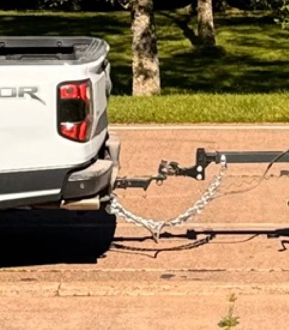

Trailer is ‘24 Lance Enduro 1200 IK, about 3500 pounds dry and 41-4200 loaded. Handles like a dream, even panic stop from 75-80 mph!
Which coupler do you have? Like it?
Your chains are WAY too long, they need to have only enough slack to not bind in turns, this way they will catch and hold the coupler if it disconnects (without hitting the pavement). Remove as much length as necessary where they bolt to the tongue.
Ford Ranger What are you towing with your 6th Gen Ranger? IMG_7478
IF they still hang down a lot, use a regular bungee cord, 18”or 24”, hang it over the ball mount and hook the ends to the chains and to the breakaway cable. This keeps them well off the ground and will still allow them to move when turning. Plus it will look more professional.
Secure the 7 pin harness and the breakaway cable up high!!!! Use rubber padded clamps or extra bungees and loop the excess length on top of the tongue.

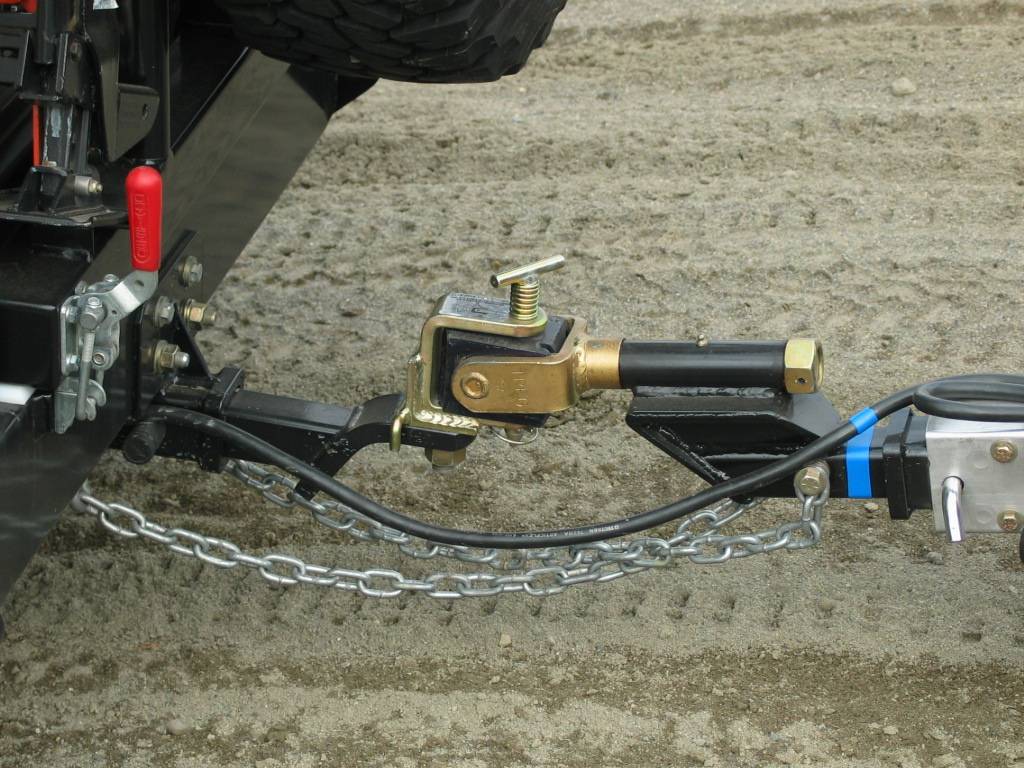

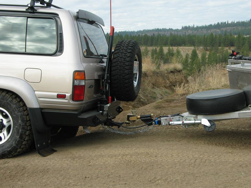

Here is my (gone) trailer with Treg monoblock coupler. the chains rarely touched the ground.

Dragging chains spark forest fires! A dragging harness can chafe through, short out, and blow fuses in your truck!

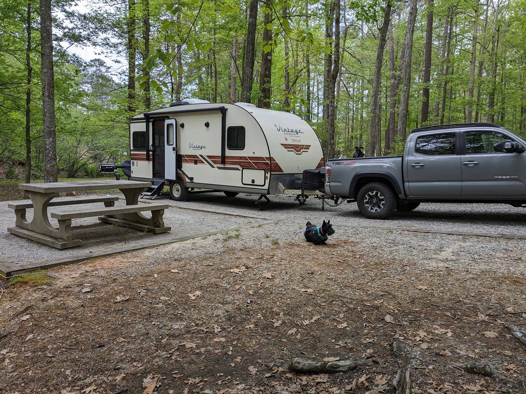

Replacing the Taco with a 2.7l XLT with Tech and advanced towing. Build date is Oct 7.
Gulfstream 19TWD, ~3800lb with out food, water, 4200lb GVWR. ~500lb tongue weight.

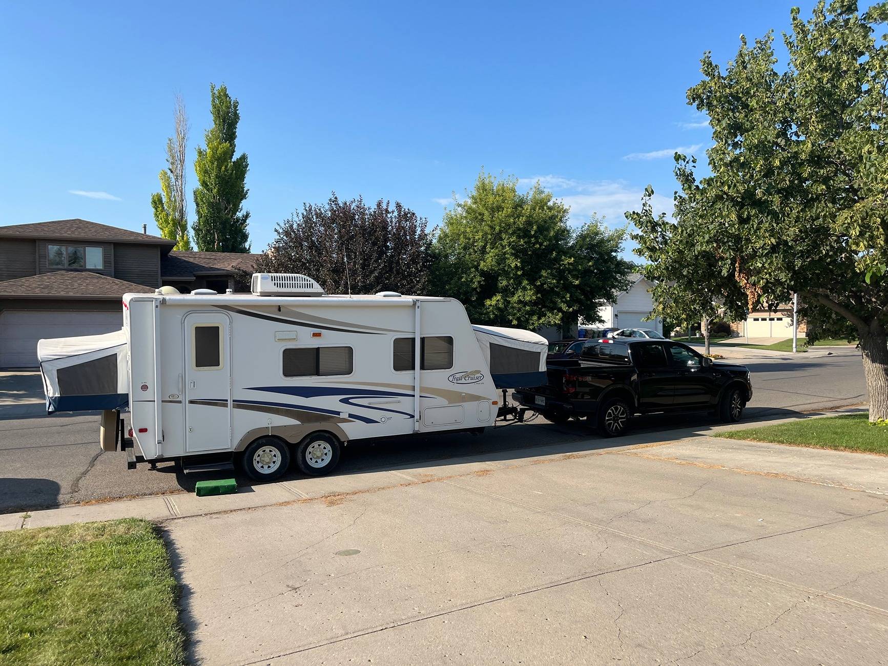

Lariat FX4, I tow a hybrid trailer about 22 ft long hitch to bumper, 3000 lbs dry. Handled like a champ!

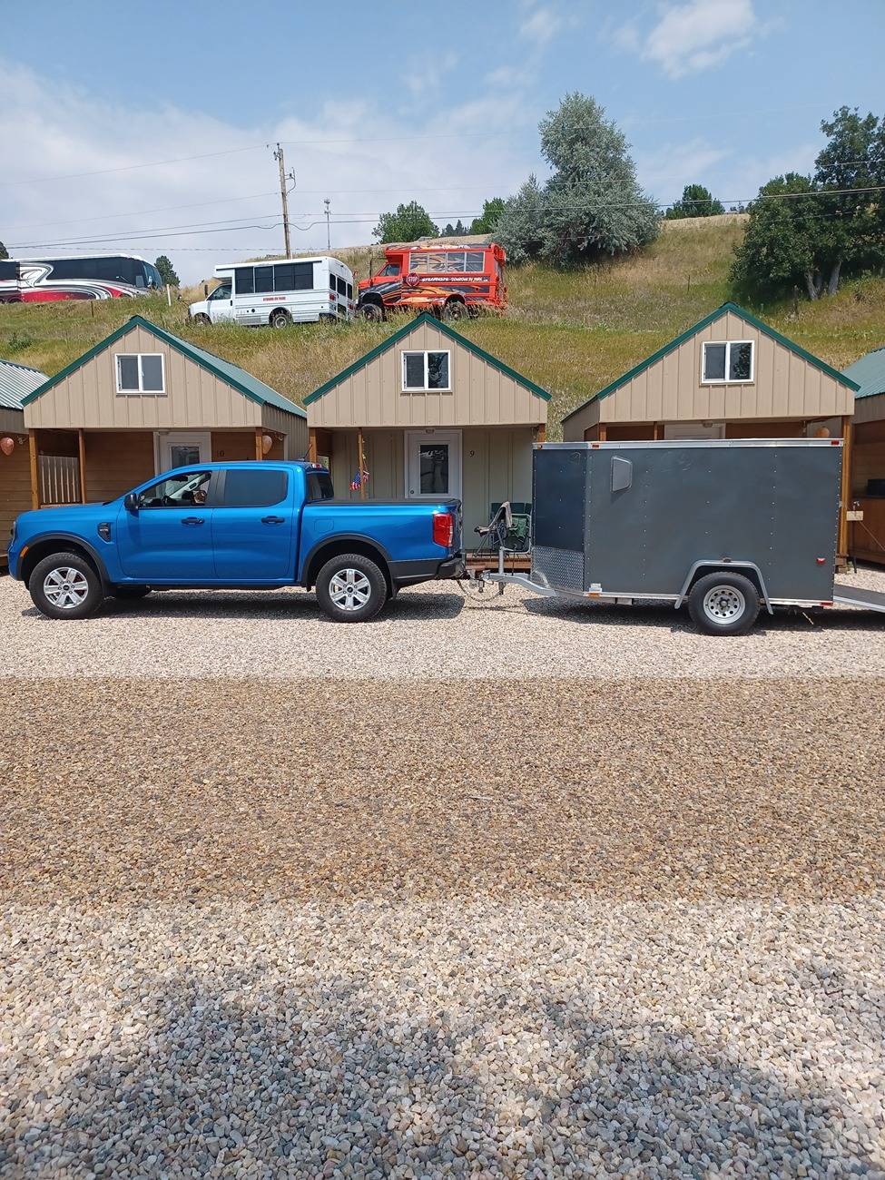

Took my 5x8 V noise to Sturgis 2024 1k one way...did fine used tow haul in hills would downshift to 8 on big ones..very smooth ran 70..75 got 16 most times
...did good job!
