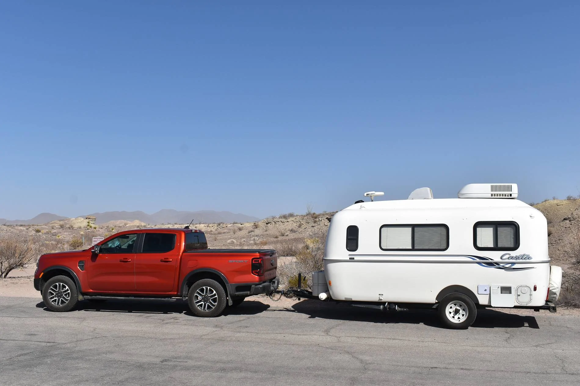

Just finished a 4500 mile road trip to Texas towing our 17' (3000# wet) Casita trailer. Pic is outside of Big Bend National Park, Texas. Truck doesn't look the greatest wearing about 3000 miles of road grime. The Ranger pulled like a champ. Computer MPG of 19.1., hand calculated 18.5. That beats our previous tow vehicle (VW Touareg with 3.6lt V6) which averaged 15.9 MPG, hand calculated. The Ranger tows better and has more usable power though both engines are rated at 270hp.

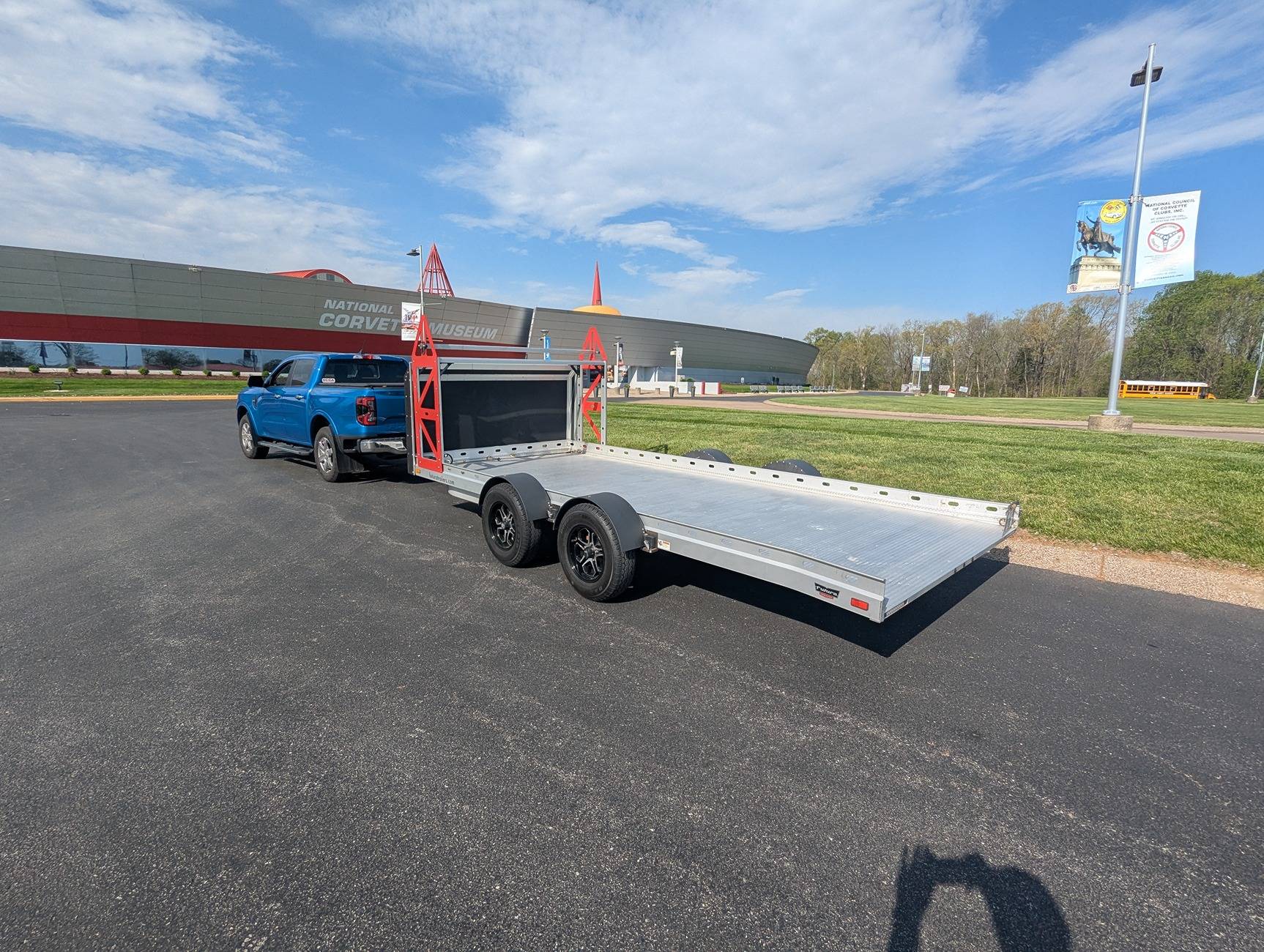

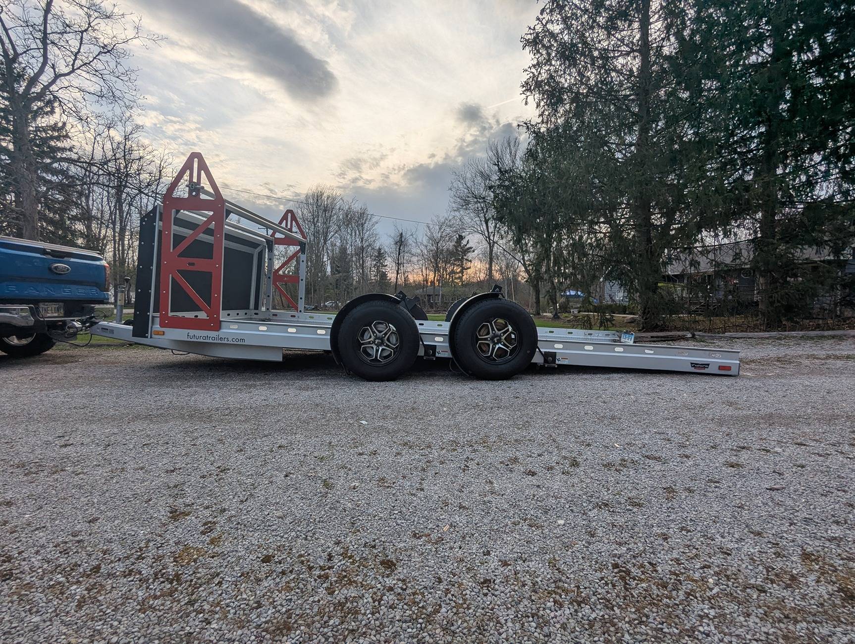

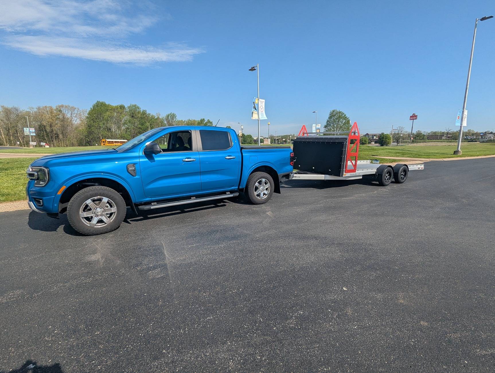

Took a 950mi round trip to go pick up a new to me Futura Super-Sport trailer this weekend to tow my cars to the track. Managed 23.3mpg in Eco mode at 75mph on the way down and 16.3mpg at 75mph in Tow/Haul on the way back. May have to look into tow mirrors of some kind because with the stone shield on this trailer I can't see anything directly behind me.

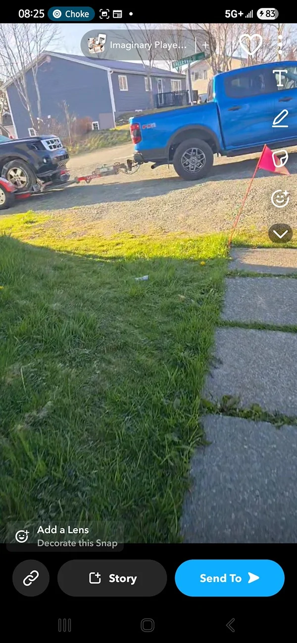

my pup camper, my utility, and the heaviest was my old parts rig when I brought it to the recyclers, loaded with 10 sets of old rims and tires, like 10 old vehicle/power sport batteries, and old parts I replaced but had in my shed.
