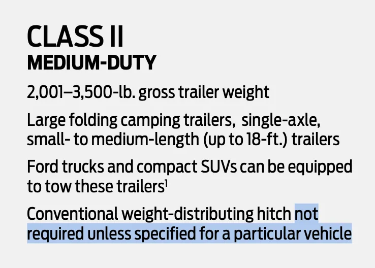

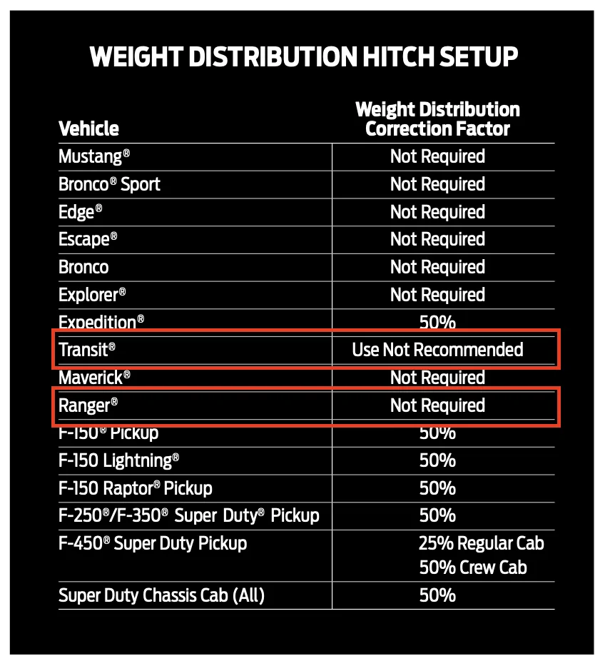

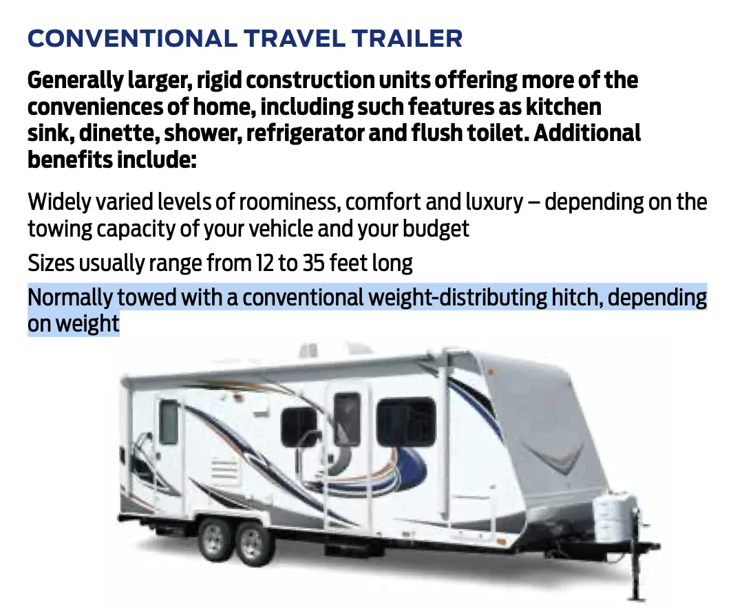

I'm not sure how you meant it, but when I hear "not recommended" that suggests it could be harmful. Looking over the 2024 towing guide again I can't find anything suggesting you "should not" use a WDH with a Ranger, only several places that confirm it's not "required". Page 41 does have an example where WDH is "not recommended" for the Transit van, but for Ranger it just says "Not Required". There is also a suggestion in the guide that small travel trailers are usually towed with a WDH (screenshot attached).
I weighed my 2021 Ranger and trailer at a CAT scale. The published base weight for my 20' trailer is 3,400 lbs. Without WDH bars installed the weight on my rear axle was 3,120 lbs, which is only 250 lbs away from the rear GAWR of 3,370 lbs. This was empty trailer, single person, empty truck. Any more than 250 lbs of payload in the bed or truck and I'd probably be over my GAWR.
Compare that to with the WDH spring bars installed: Now my rear axle is 2,640 lbs and my front axle 2,680 lbs. I have a ton of usable payload capacity left without exceeding GAWR and I've got equal weight on the front and rear axles (instead of removing 280 lbs from the front, steering wheels).
So could you tow 7,500 lbs without a WDH? Probably yes, but you'd likely need the truck to be completely empty to avoid maxing out your rear axle. That's not realistic for most people taking a trip with their camper though. Add in the benefits of the sway control you get with most WDH and it can add up to a much more comfortable/enjoyable (and probably safer in emergency situations) experience.

thank you for your reply. i probably didn't choose my words well when saying "not recommended"...i was thinking more along the lines of "not required". your cat scale measurements are interesting for sure and make me think that the WDH is actually very helpful. where i usually get hung up is the weight of the WDH itself and the extra weight that that takes from payload capacity. i have plenty of payload left with the trailer hooked up and probably shouldn't worry about the extra WDH weight. but i always did wonder why the tow guide didn't mention a WDH in the ranger section at all while other trucks give a weight with and without weight distribution. was it just an oversight in the tow guide or is it really "not required".
i am pretty new to all this and have towed a trailer about 5 times (including small trips from the dealer and back). we bought our trailer last year and used it only 1 time this summer because one of our family members got sick and we had to change our plans and cancel our other camping trips. before that we rented a trailer last summer that was closer to 4000 lb and towed it a few hundred kilometers with my 2020 ranger. i didn't feel like it was difficult to control or that the trailer was too much for the truck at all. i did keep my speeds on the slower side though at around 55 mph. i actually got pretty decent fuel economy too at around 15mpg. there weren't many hills involved and the winds were calm. i am excited to try my 2025 with the 2.7 but might have to wait until next summer and i will put more thought into getting a WDH.

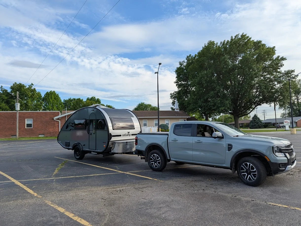

Have a Ranger Raptor and tow a NuCamp T@B 400 Boondock. Empty weight is 3k and typical camping weight is 3500lbs with about 400lbs on the hitch and under payload limits of the truck. Running an E2 WD hitch which is needed with the Raptors’ soft rear springs. Have just over 1300 towing miles and average mpg is 10.1 going at normal highway speed limit. Previous tow vehicles were a 3rd gen Tacoma(terrible at towing) but not as good as my diesel BMW X5

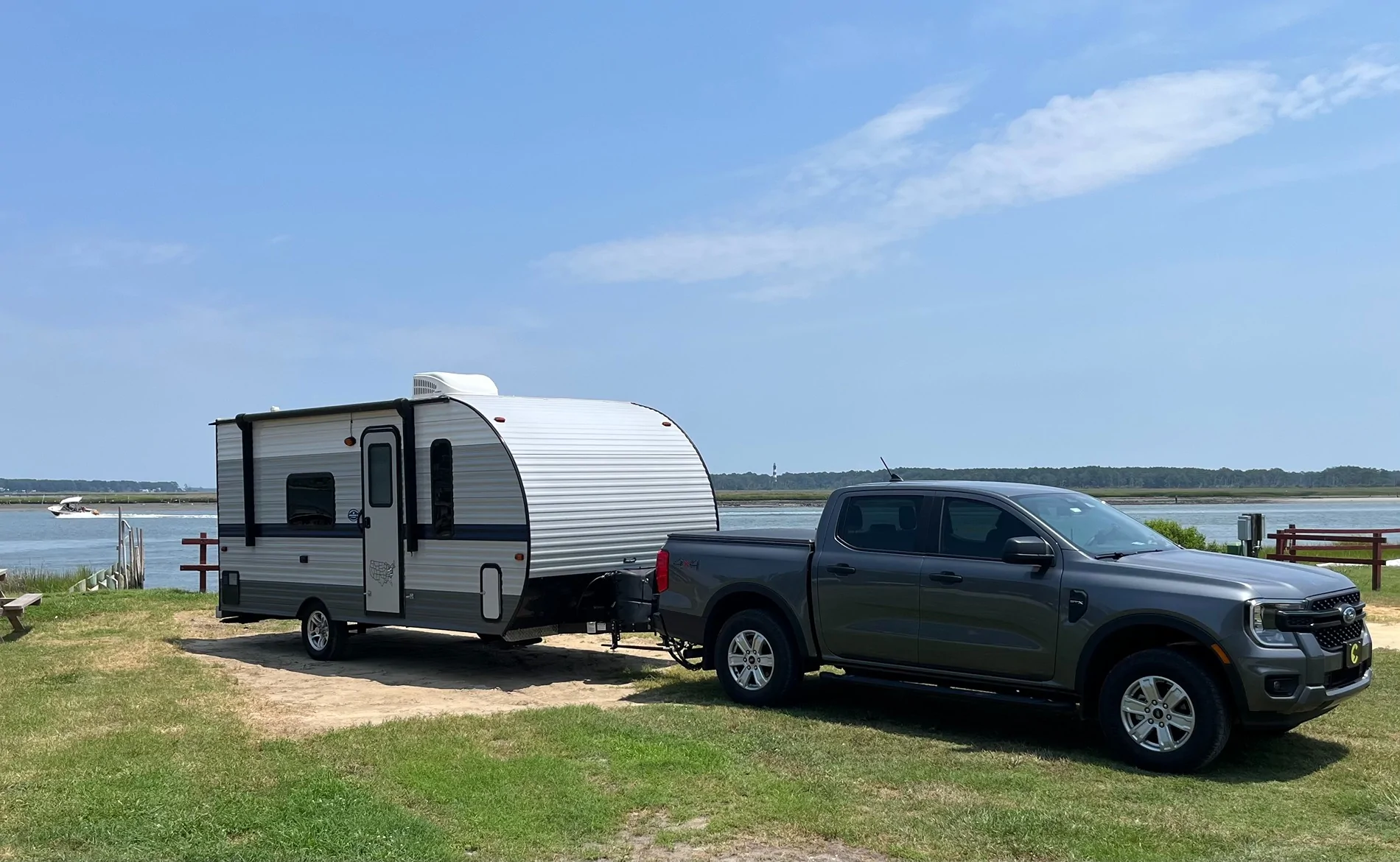

We tow our 20ft Gulfstream all over the country behind our XL. It weighs 3,000lbs dry, so I would imagine about 3800 loaded. I upgraded the trailer tires to LRE, and plan on adding a set of LT's to the truck to help with stability. She pulls the camper no prob (12.5mpg) but away is an issue. I couldn't imagine pulling this down the highway without a WDH.
