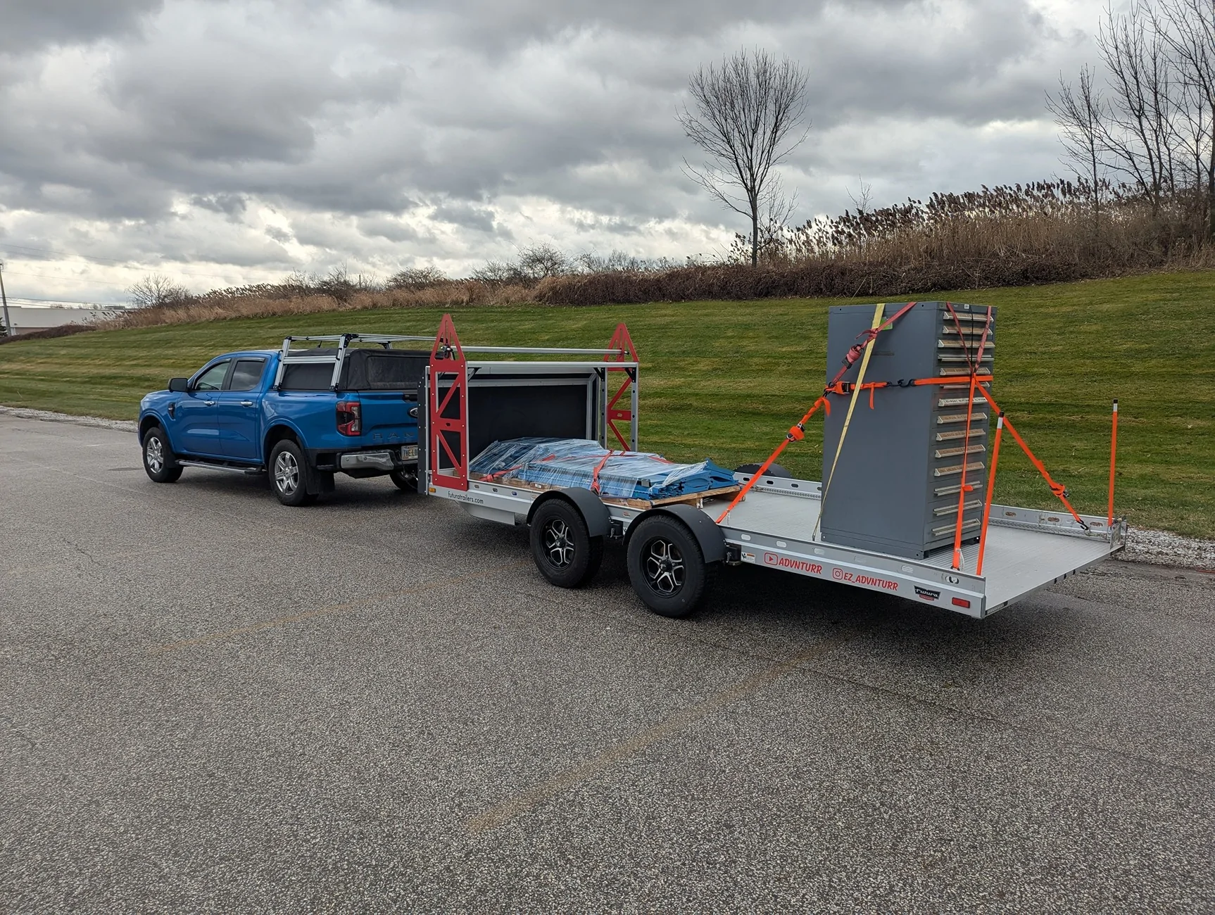

My work was giving away some shelving and some Vidmar industrial cabinets, so the car trailer became a utility trailer.

Nice setup. I’m pulling a 17' aluminum boat that’s about 1,800–2,000 lb wet, and the Ranger does great as long as I keep ~10–12% tongue weight and the trailer level (flip the hitch as needed). I run Tow/Haul and will drop it into M to hold 7th/8th on grades so it’s not hunting, and keep the speed around 60–65. For dirt/washboard I air the truck down to ~30 psi and the trailer to ~22–25, leave it in 4A/4H, and watch hitch clearance—then air back up before pavement. If you haven’t already, hit a CAT scale loaded to verify tongue weight and give the trailer lugs/hitch bolts a re-torque after your first few rough trips.

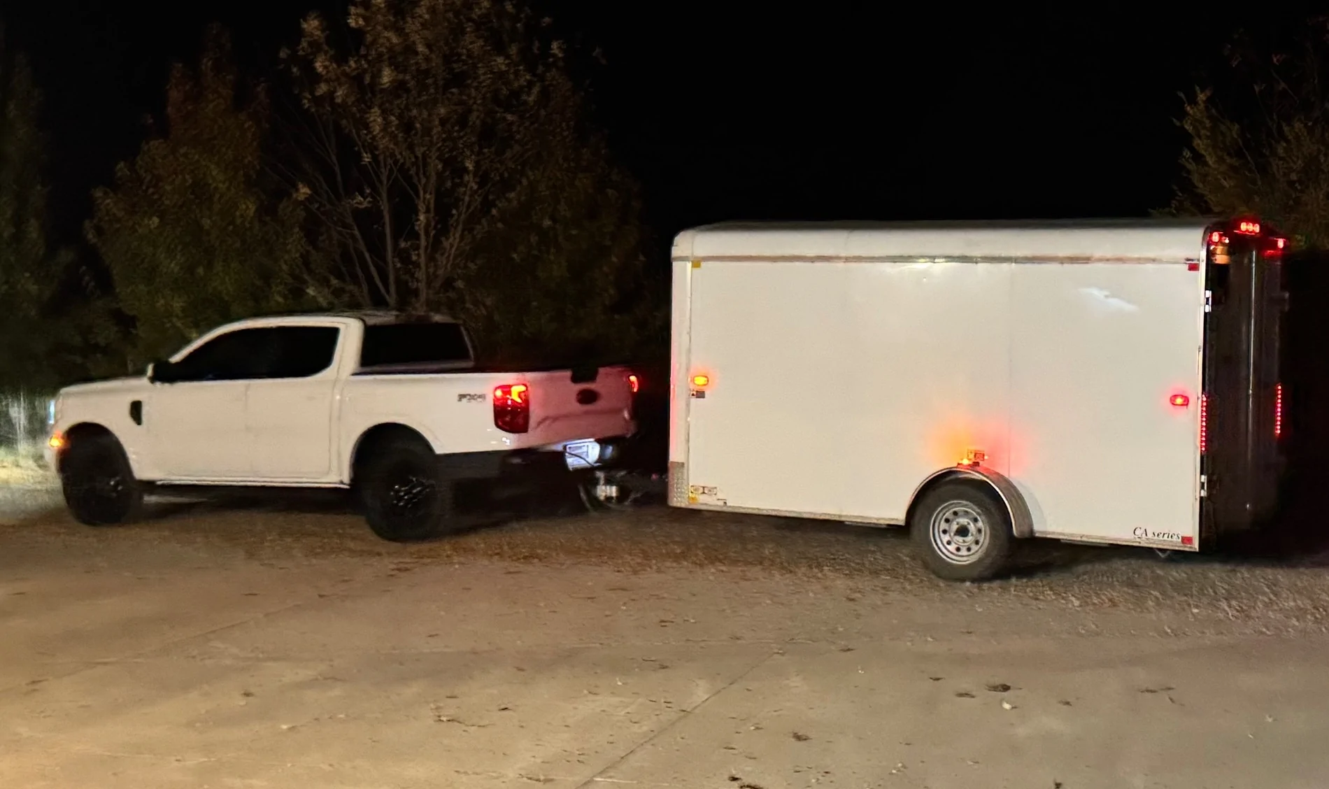

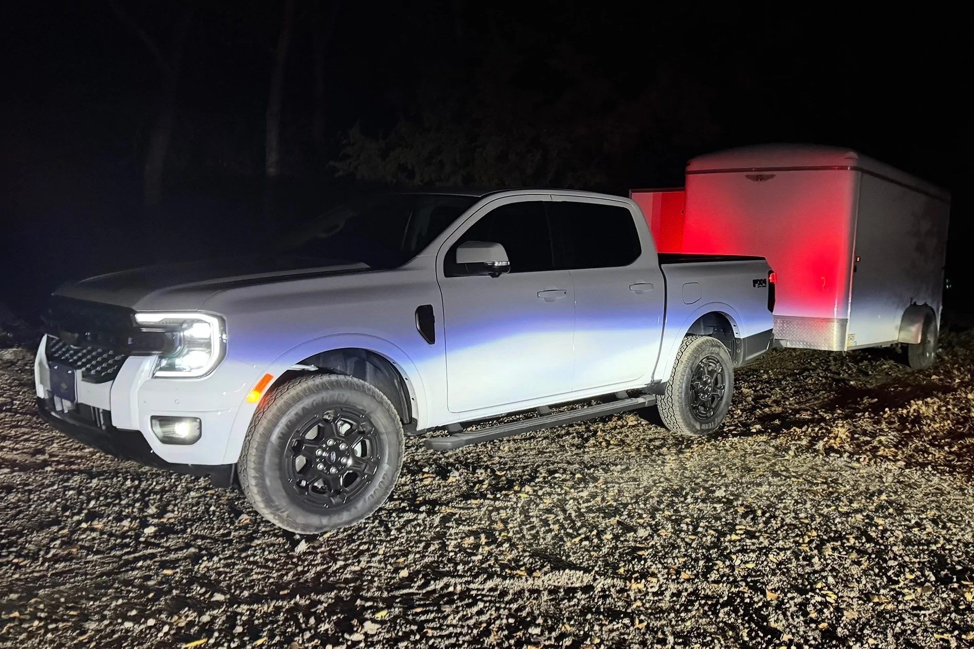

Cargo trailer. ‘

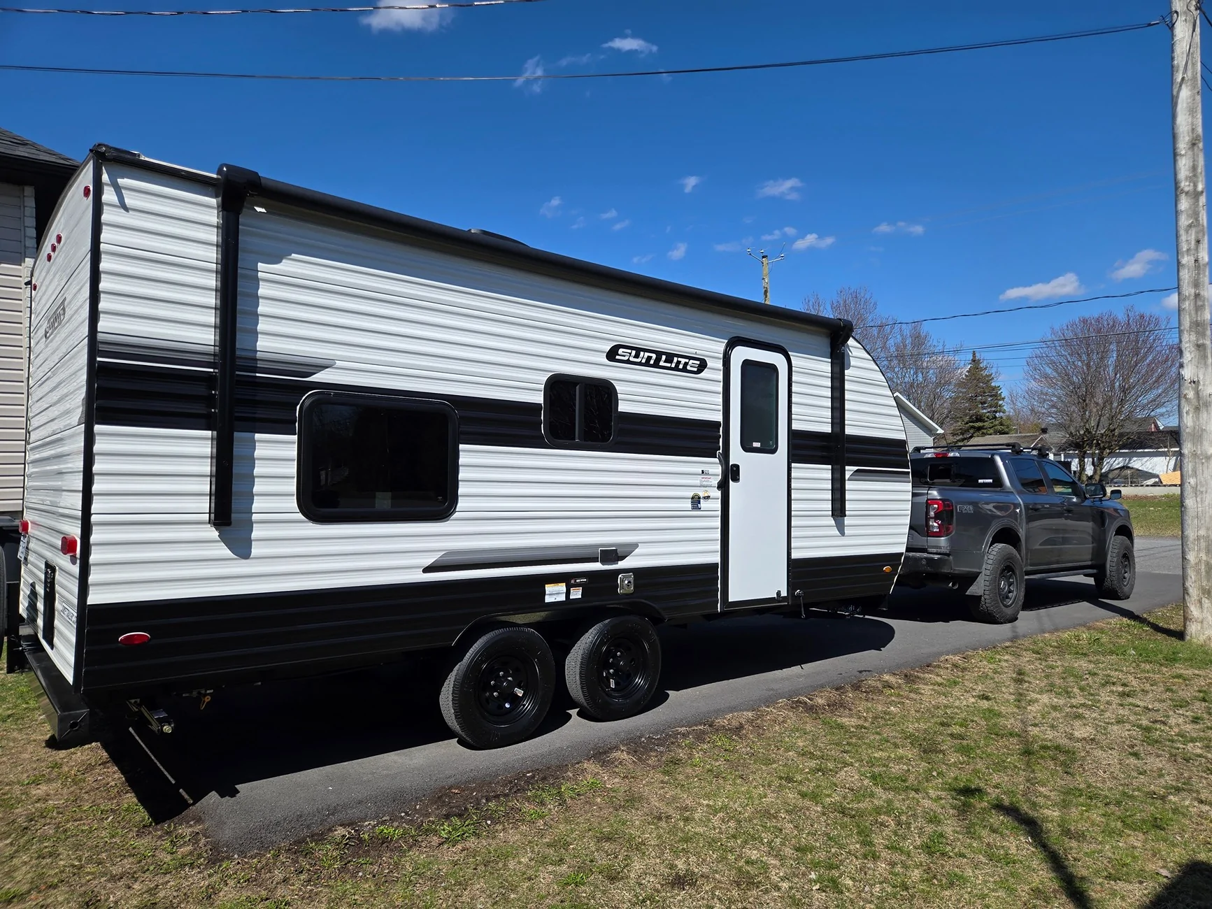

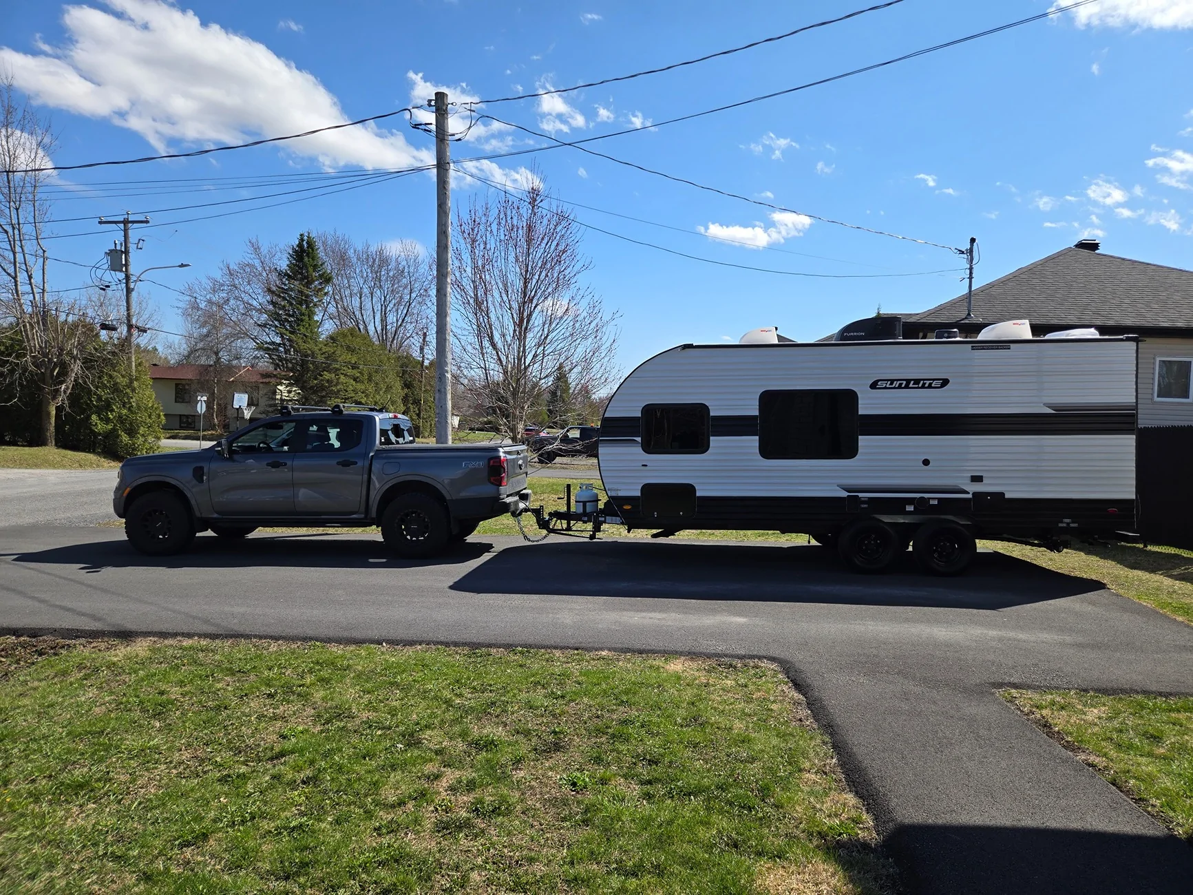

Towing a 22 feet, 3700lbs dry travel trailer. Probably somewhere between 4000 and 4500 loaded. 340lbs hitch weight (dry). Reese weight distribution hitch. I have a 1" lift up front from Fordrangerlifts, but in reality it's more like a 1/2 - 3/4 lift. Kinda surprised that it doesnt squat much. Standard FX4 suspension.
My very first experience towing a big trailer like this. I cannot compare with other travel trailers, but definitely feel the weight behind me. I would not like towing anything bigger or going faster than 100km/h with this.

Looks like you got it pretty darn close to level and set correctly(hard to tell really on the unleveled ground), safe travels and enjoy.
