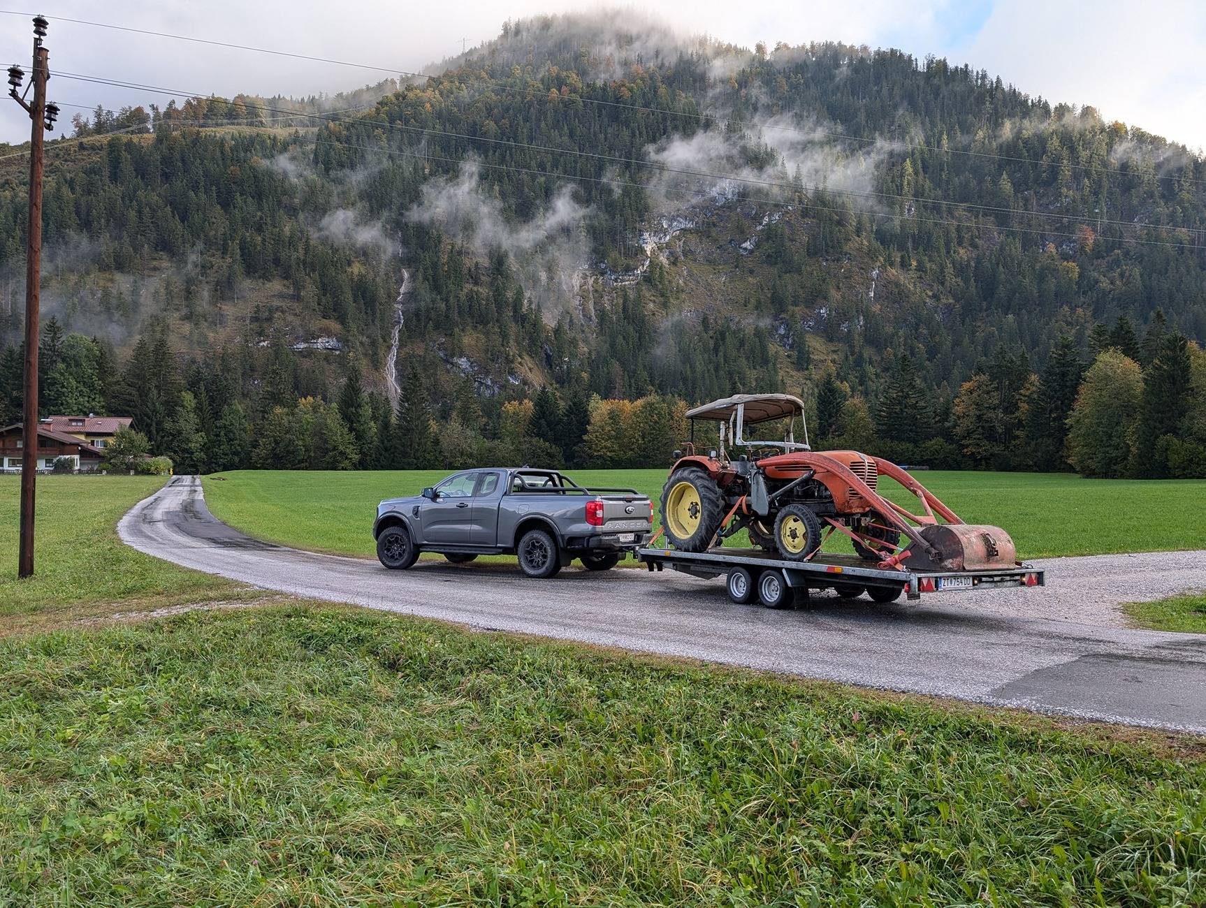

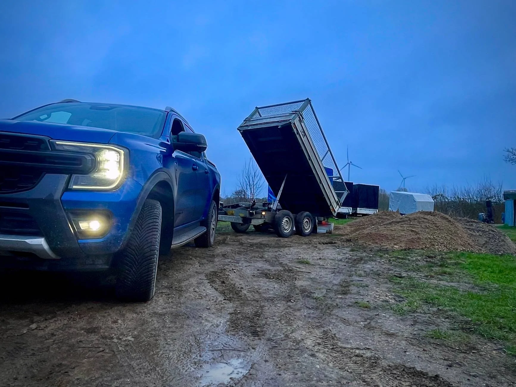

Picked up a small tractor yesterday weight with trailer around 2500kg-2700kg 5500lbs-6000lbs,
And where can i get a lower tow hitch with an euro spec 50mm ball, i only find ones with an 2"ball unloaded the trailer is driving on only 1 axle

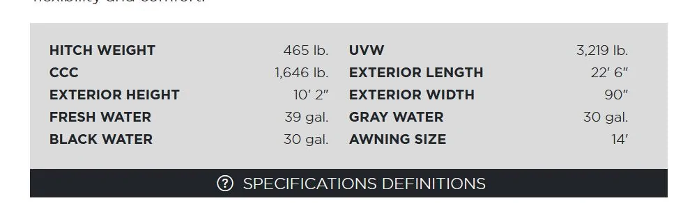

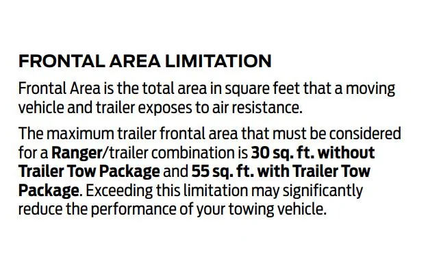

Can anyone shed some light on the Ford Towing Brochure that states
Ranger Max Frontal Cross Section towing limits.....includes vehicle + trailer in the cross section
no tow package 30 sq ft
with tow package 55 sq ft
with most 3500-5000 lb trailers being roughly 10' high by 7' wide.....doesn't this put these trailers out of the limits stated by Ford?
Specs below for a Wildwood FSX 179DBK

Maybe you have to deduct the frontal area of tge tow vehicle as it hits wind resistance also???
yet the wording is "Ranger/trailer combination...."
So i read it as, when you stand in front of the Ranger with trailer attached, what you see is all frontal area that the wind will be hitting....
I mean a surface completely vertical makes sense, but the sloped part of the truck (i.e. windshield) can't be as harsh as the vertical part of grill area. And most trailer fronts are rounded as well for this reason.
Still just trying to make sense of it all.
Yeah ran into the is same thing when i was looking at it. sounds pretty much like it's to cover there butt and explain why you ate getting 12mpg instead of 20 :D.
It doesn't say you can't.

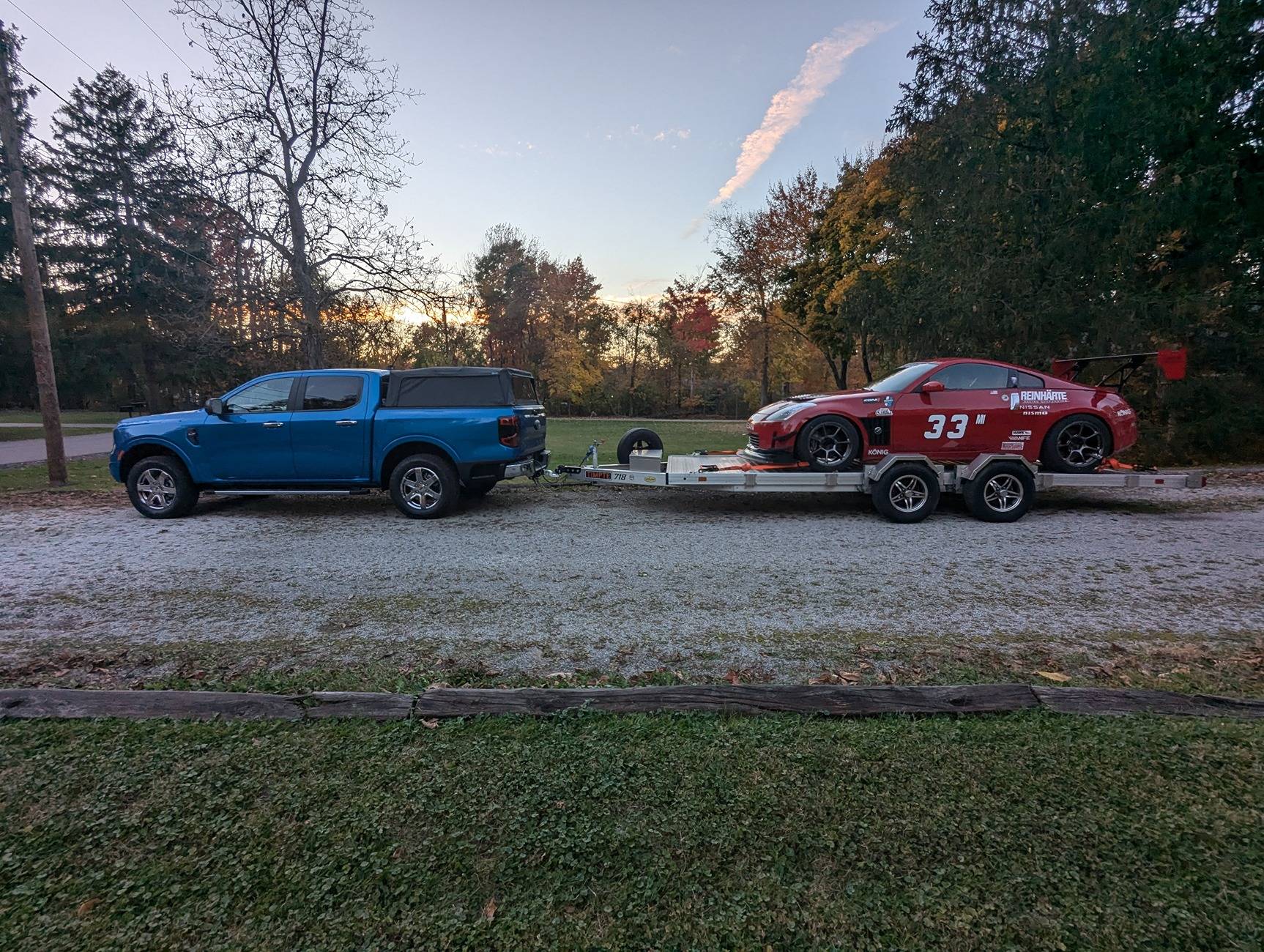

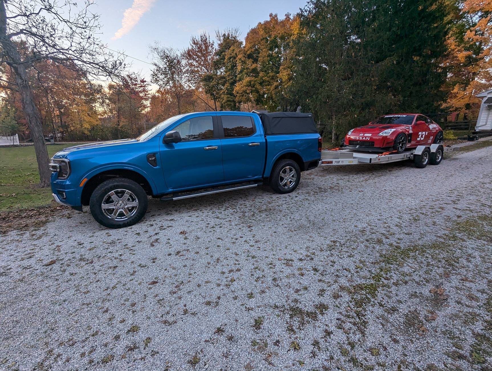

Barely broken in and my 2.7 is about to make a 500mi tow to NCM in KY with my TT350Z so I can compete in the SCCA Time Trial Nationals. Tongue weight seems good, brake controller gain is set, here's hoping ?

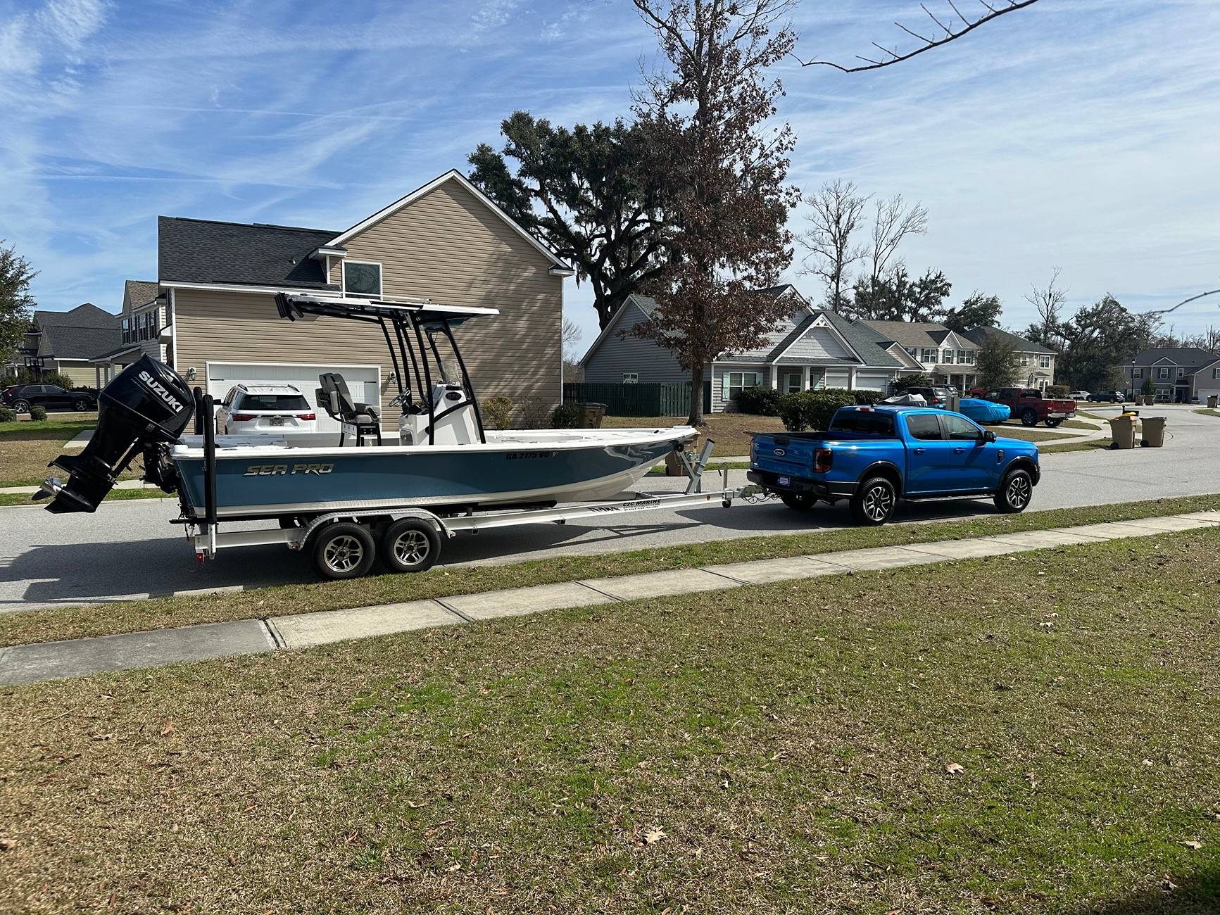

Haven’t had it for long, but I pull a 22 foot boat, just shy of 5000 lbs fully loaded and topped off. Handles a lot like my old F-150 did. No issues so far.

In case you have not seen this guide, be aware that trailer frontal area is very important with these compact trucks. You should tell us which Ranger you have, and which towing package.
https://www.vdm.ford.com/content/da.../towing/pdf/2024-Ford-Ranger-Towing-Guide.pdf
Since you live where there are steep mountains, always err on the side of caution when picking a trailer, for example no more than 80% of your rated max trailer weight (with the trailer fully stocked and loaded). Unfortunately most people buy the truck and then look for the trailer, this can cause big problems, because they end up pushing the safety margin too far, or exceeding it entirely.
