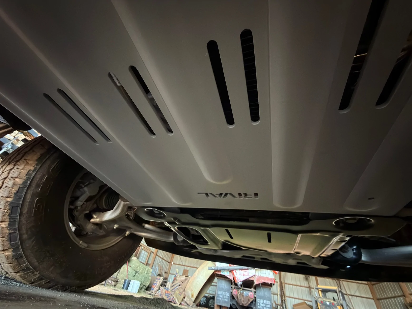

Installed the Rival transmission skid plate to go along with the Rival front skid and oem Bronco engine skid I installed the other day. Still need to go to the dealer to get an oem Bronco transfer case skid.
Do this mean when doing oil changes you have to take off both skid plates or can you still slide the front skid off to access oil pan?
Should come off with just removing the 2 bolts on the back of the engine skid plate and loosening the front 2 bolts. It would've been nice to get the Rival engine skid so that I'd have an access panel to drain the oil. But the ford skid was significantly cheaper and is quite robust.

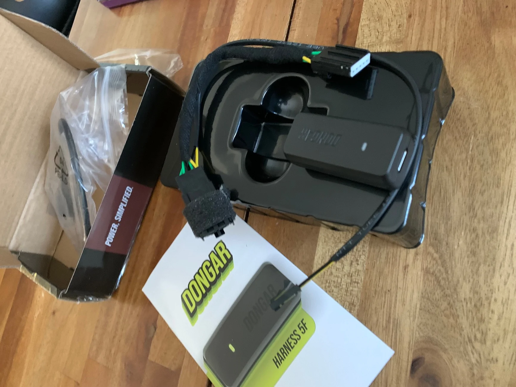

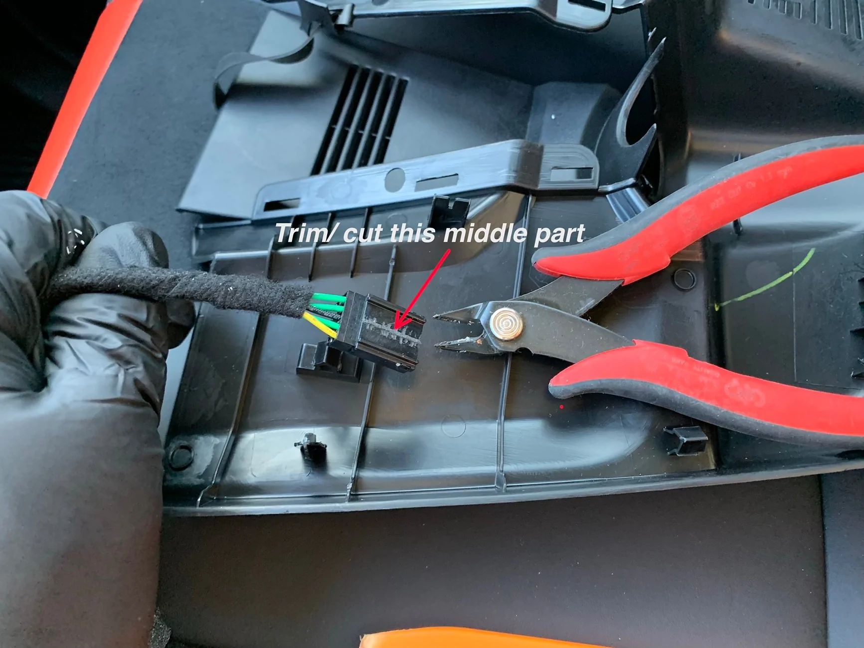

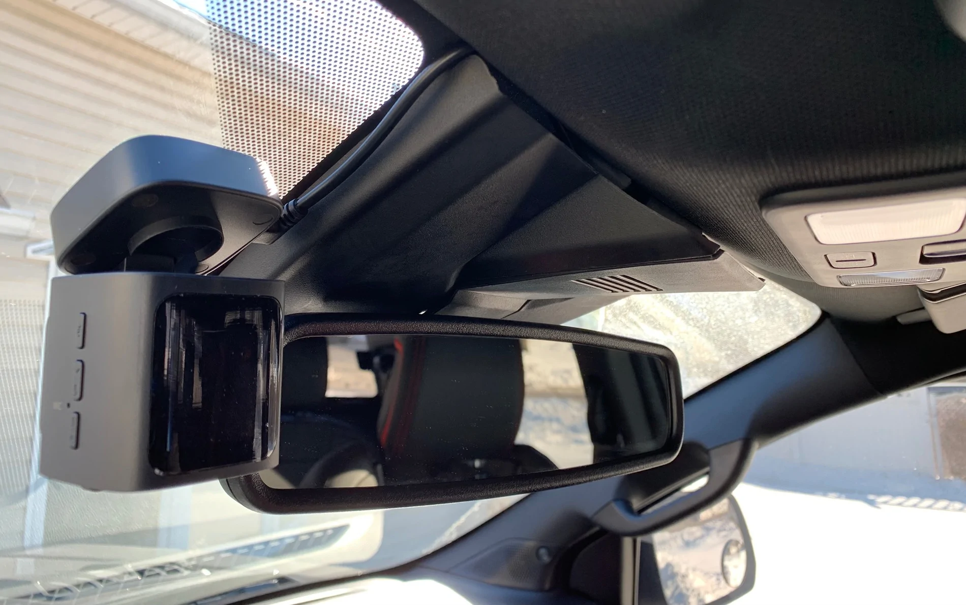

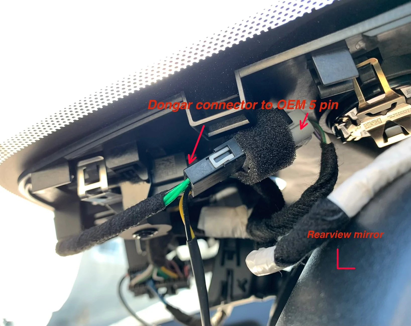

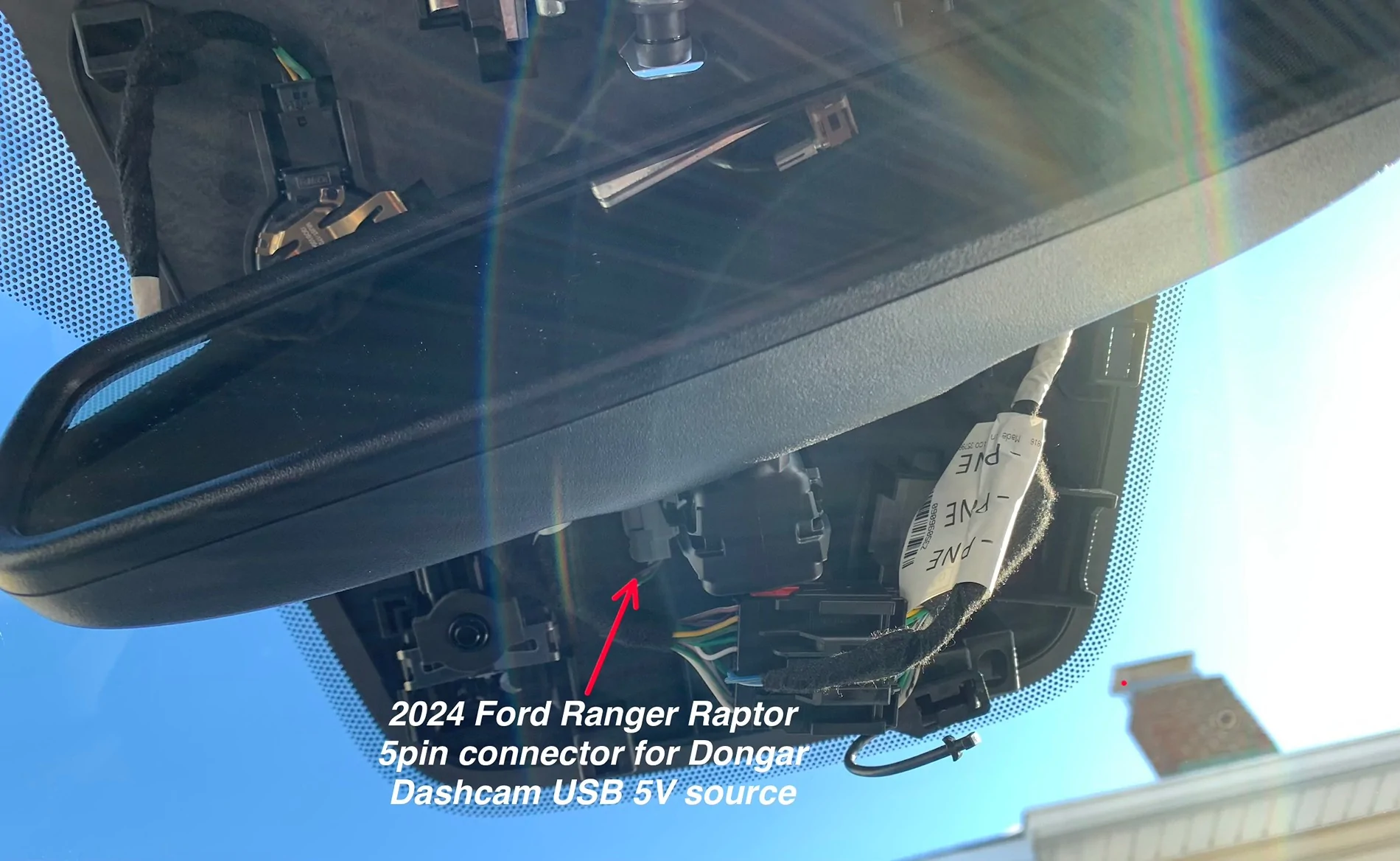

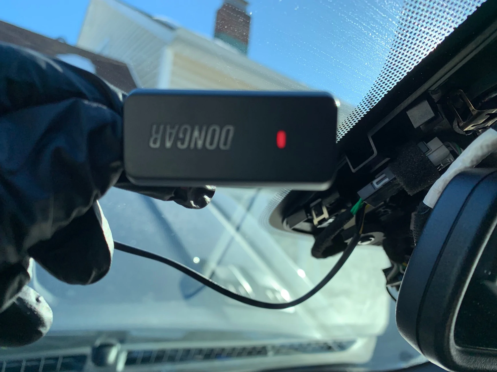

Added Basseus solar and USB powered dashcam to my 2024 Ranger Raptor.
Tapped into the 5pin power behind the rear view mirror using Dongar classic usb dashcam connector.
(took 10 mins to install)

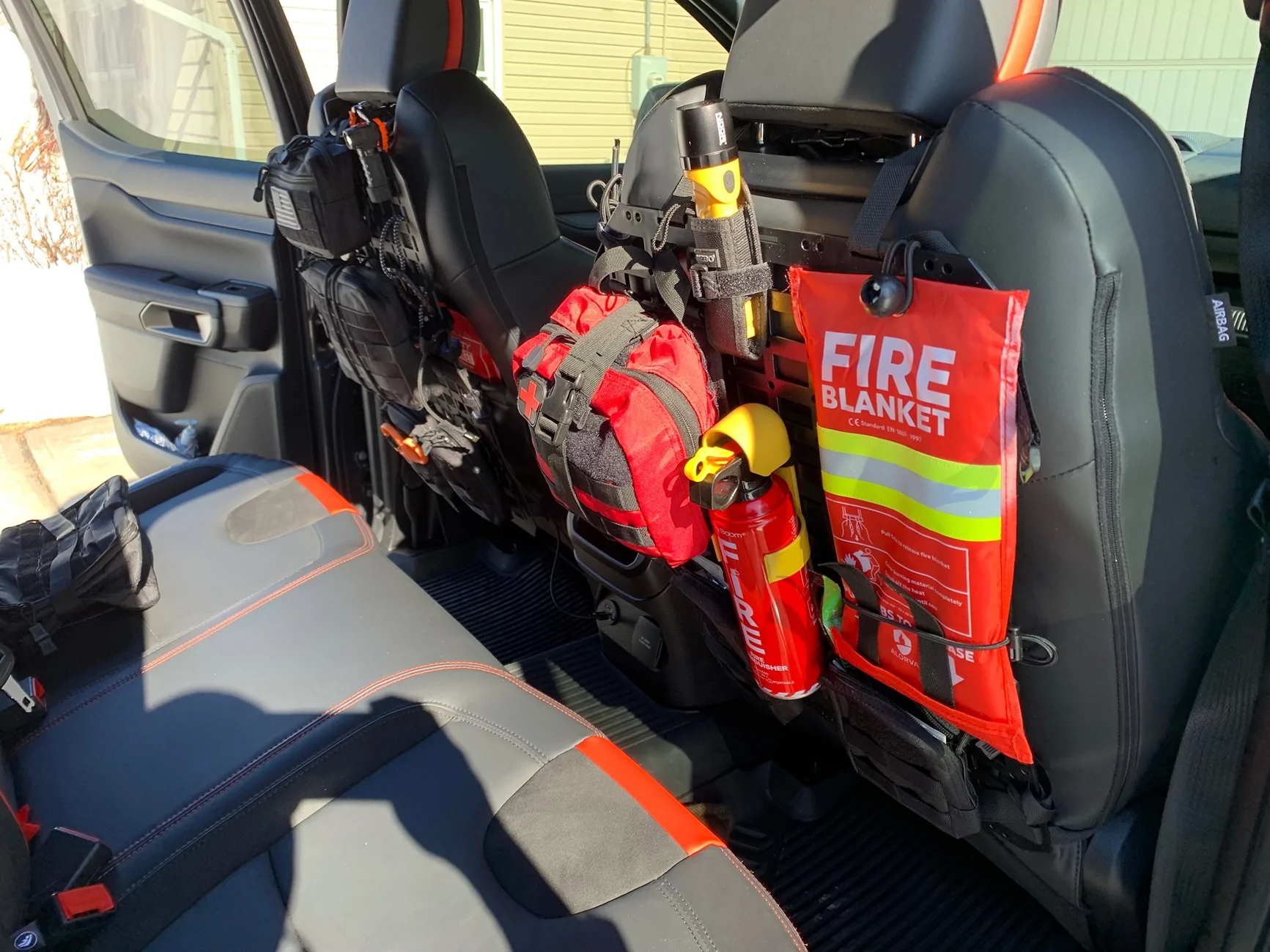

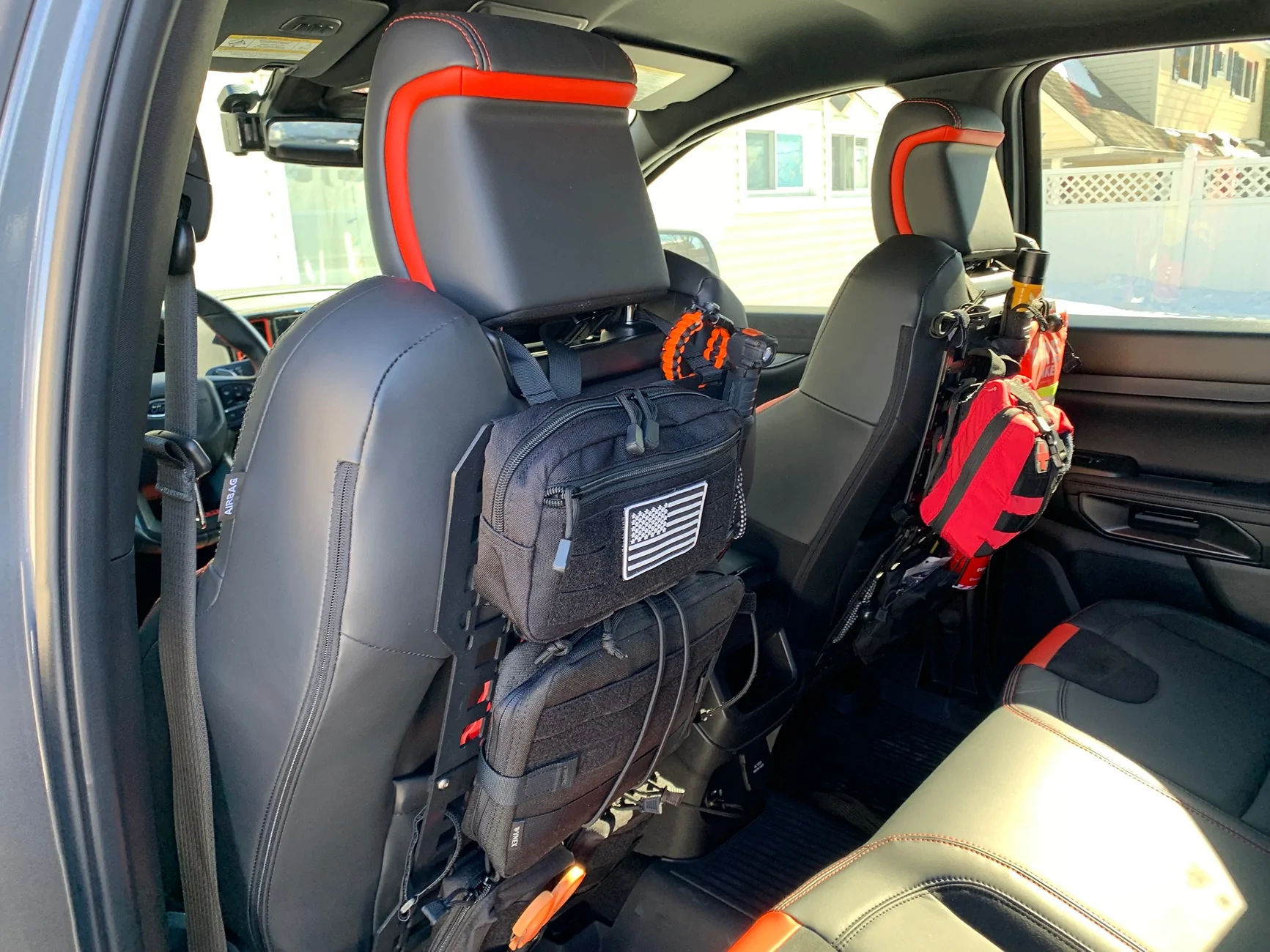

Also organized the backseat with rigid molle panels and added some first aid/ essential packs.

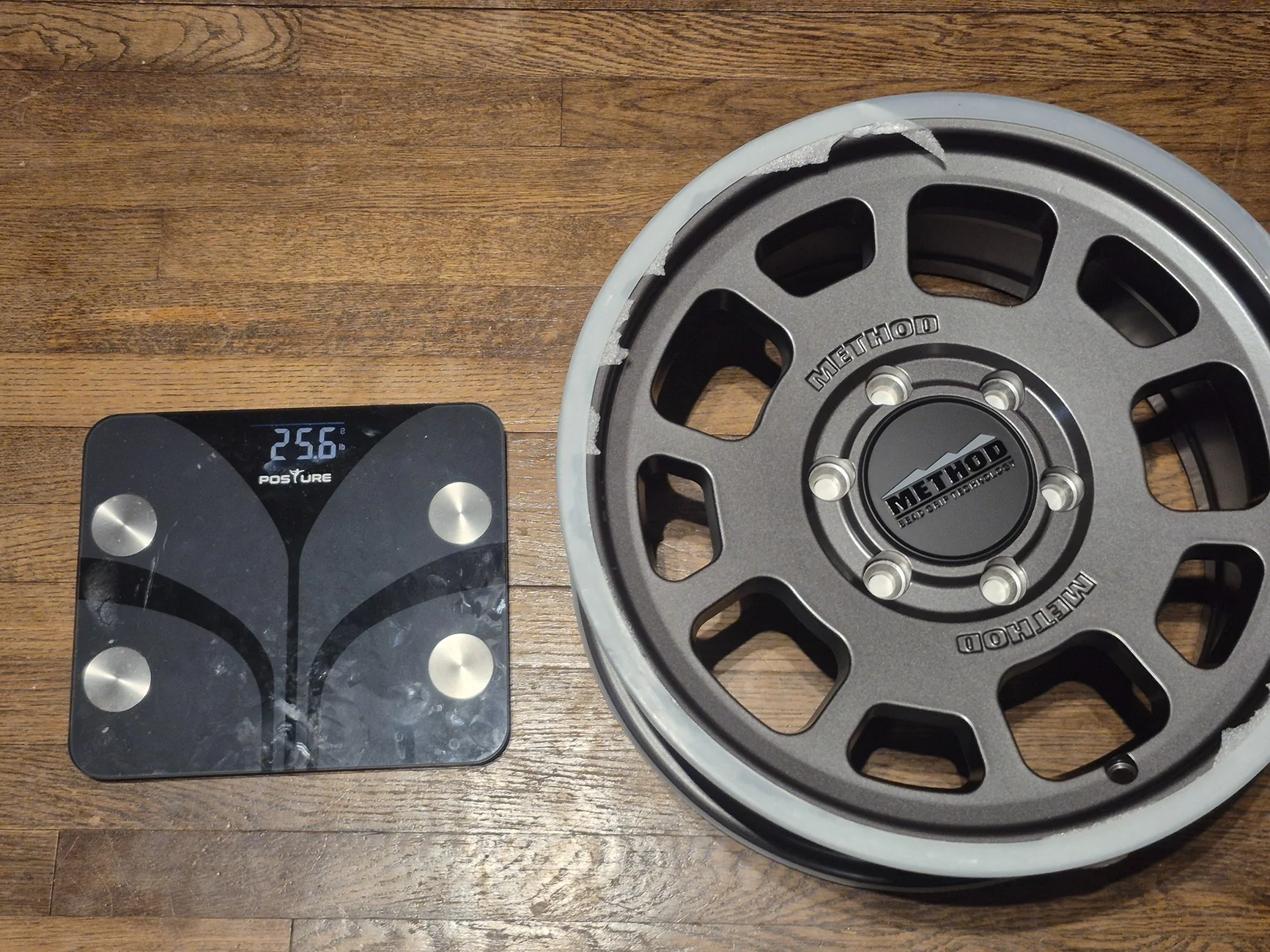

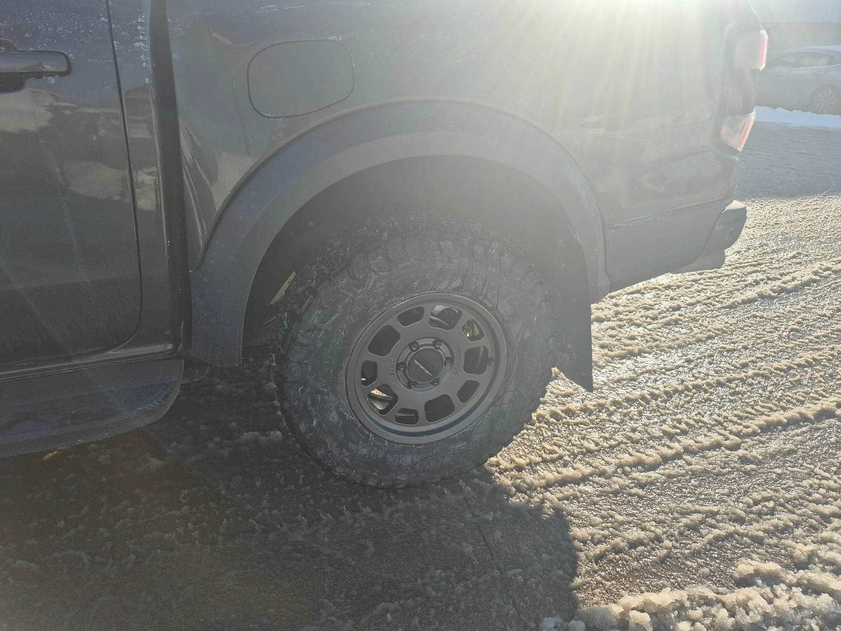

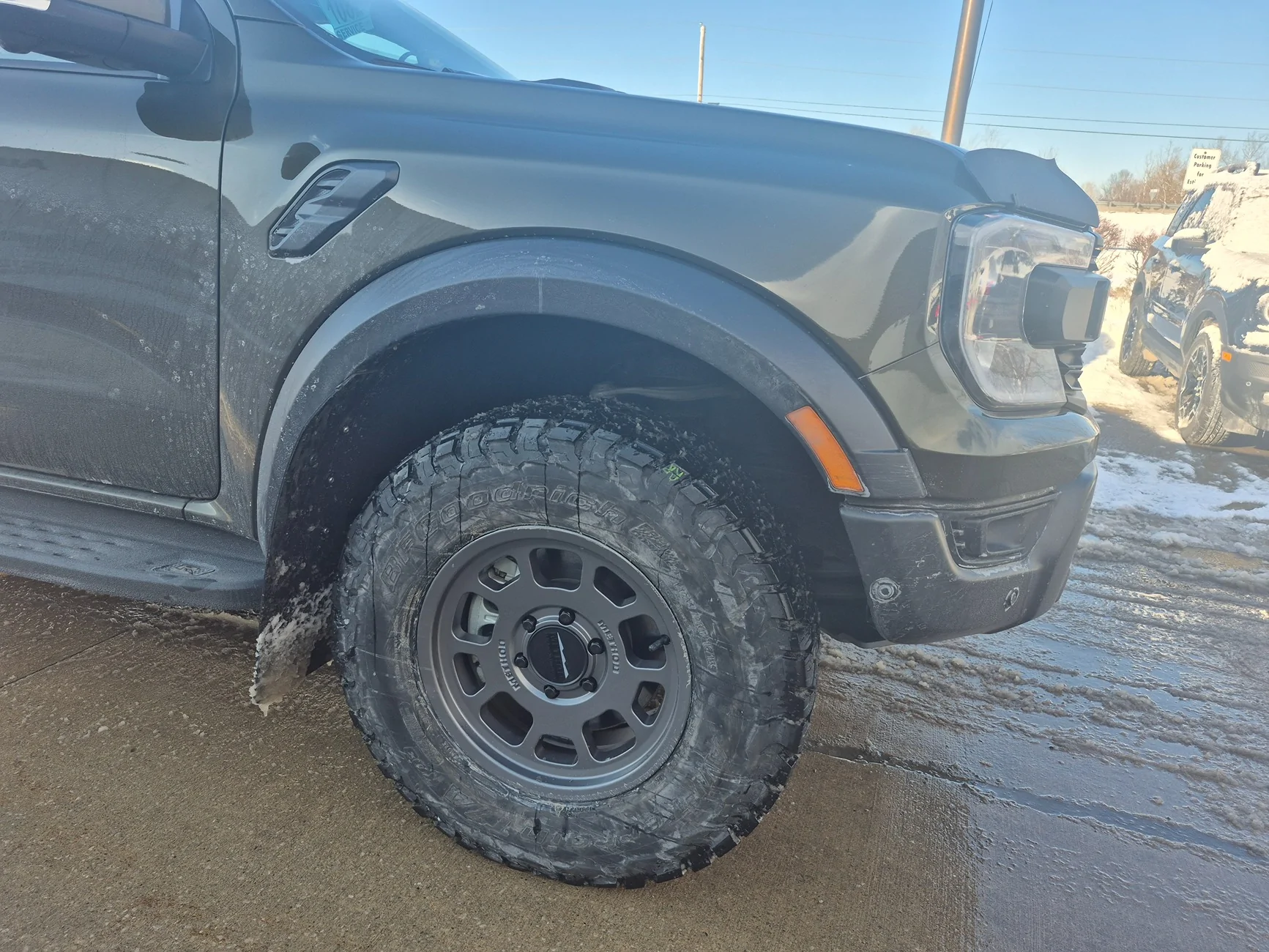

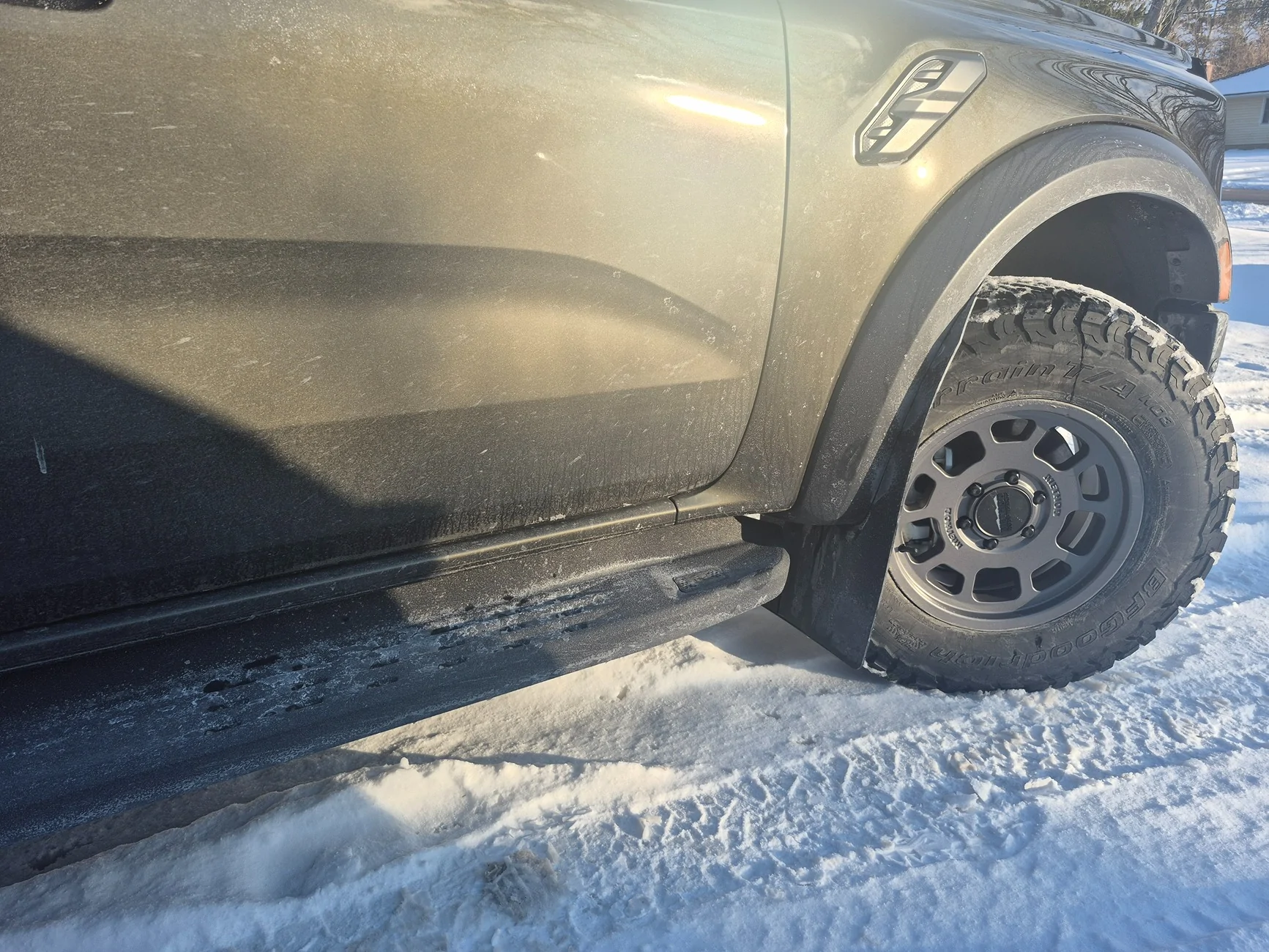

Wasn't today, but got my unobtanium 705's installed (glad I waited, love them, only 25lbs per wheel, bead grip and ET35, should have been factory!):
Ford Ranger What did you DO TO your 6G Ranger today? 🧰 🛠️ ⚙️ 🧽 20260116_194947
Ford Ranger What did you DO TO your 6G Ranger today? 🧰 🛠️ ⚙️ 🧽 20260117_161538
Ford Ranger What did you DO TO your 6G Ranger today? 🧰 🛠️ ⚙️ 🧽 20260117_150705
Ford Ranger What did you DO TO your 6G Ranger today? 🧰 🛠️ ⚙️ 🧽 20260117_150724

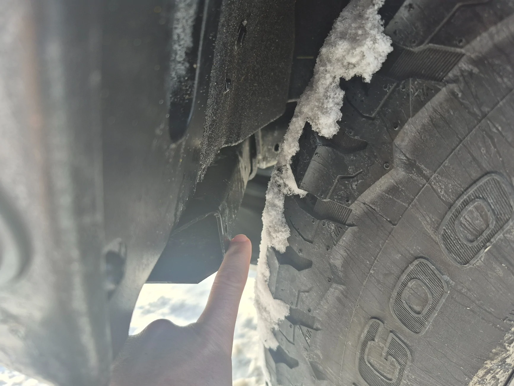

Plenty of clearance with stock 285/70R17 KO3's (or equivalent).
Ford Ranger What did you DO TO your 6G Ranger today? 🧰 🛠️ ⚙️ 🧽 20260117_161133
Glad I put on the XL mudlfaps though, the added off-set made the Ford OE one's a bit on the small side, XL's are 1 in wider than stock. And.....I can actually reach the valve stems, yipppeeee!!!

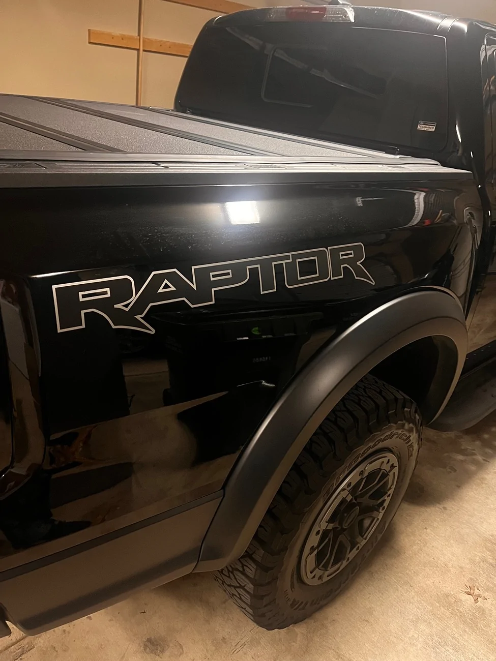

I removed and applied some decals…which I am regretting because of the shiny outline.

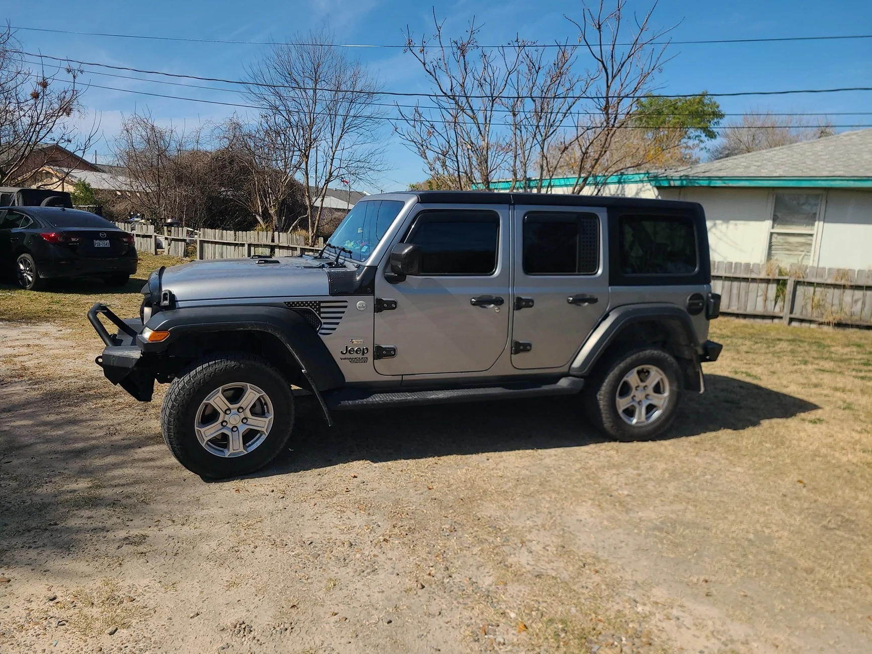

I gave the ranger a break and installed a lift on the wife's 2019 wrangler 4 door
