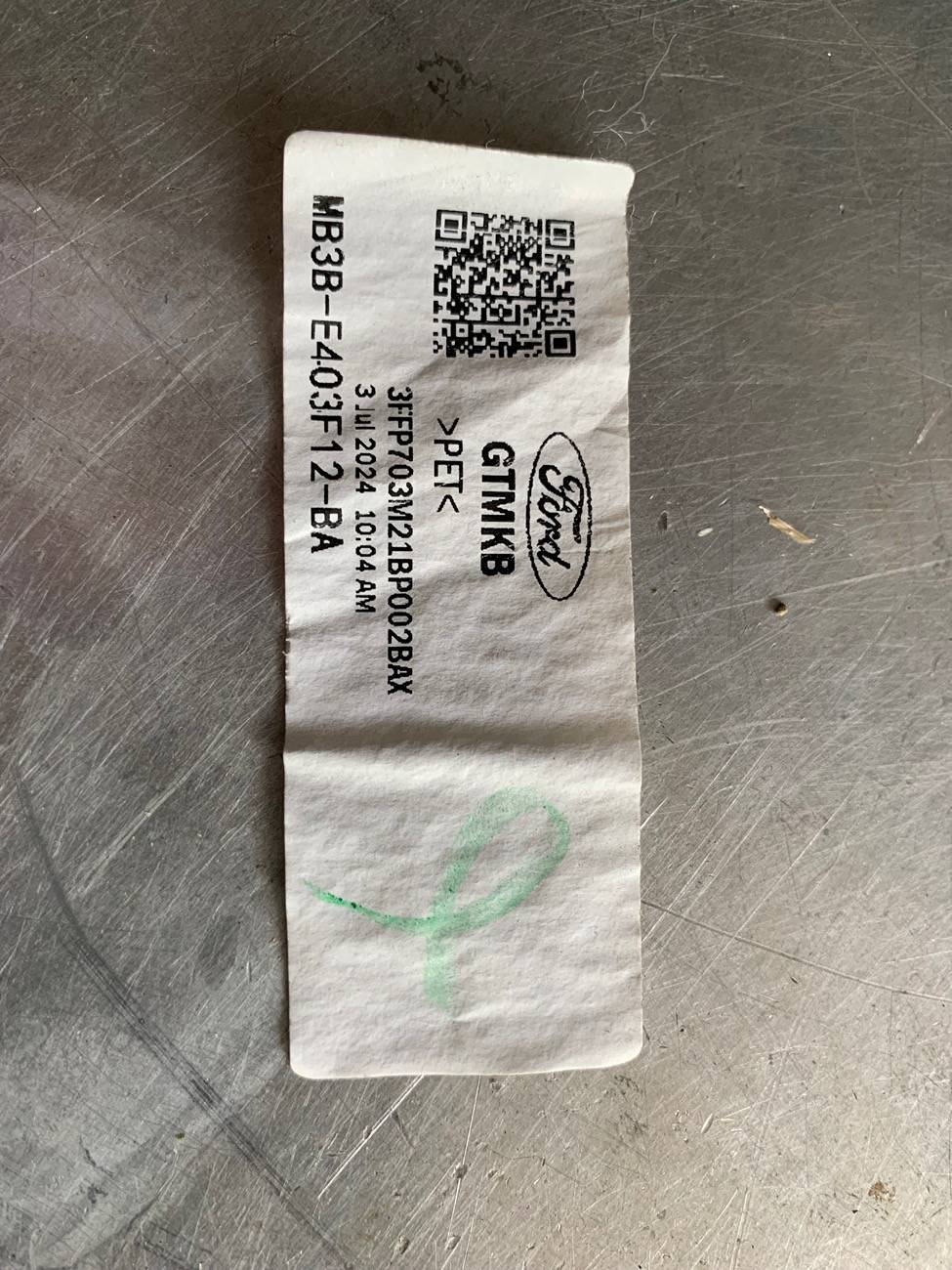

Still no answer I guess but trying to search the part number did not really help either but the label was peeling so here it is for all to see. Paul ?

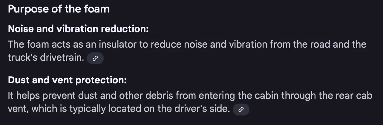

There are so many threads that have explained what this is and you can also get an explanation from Chat GPT or google. So many threads about it we should have a sticky. Some people who have removed it have reported increased wind noise and chatter from the rear. Other people are hard of hearing and can't tell.

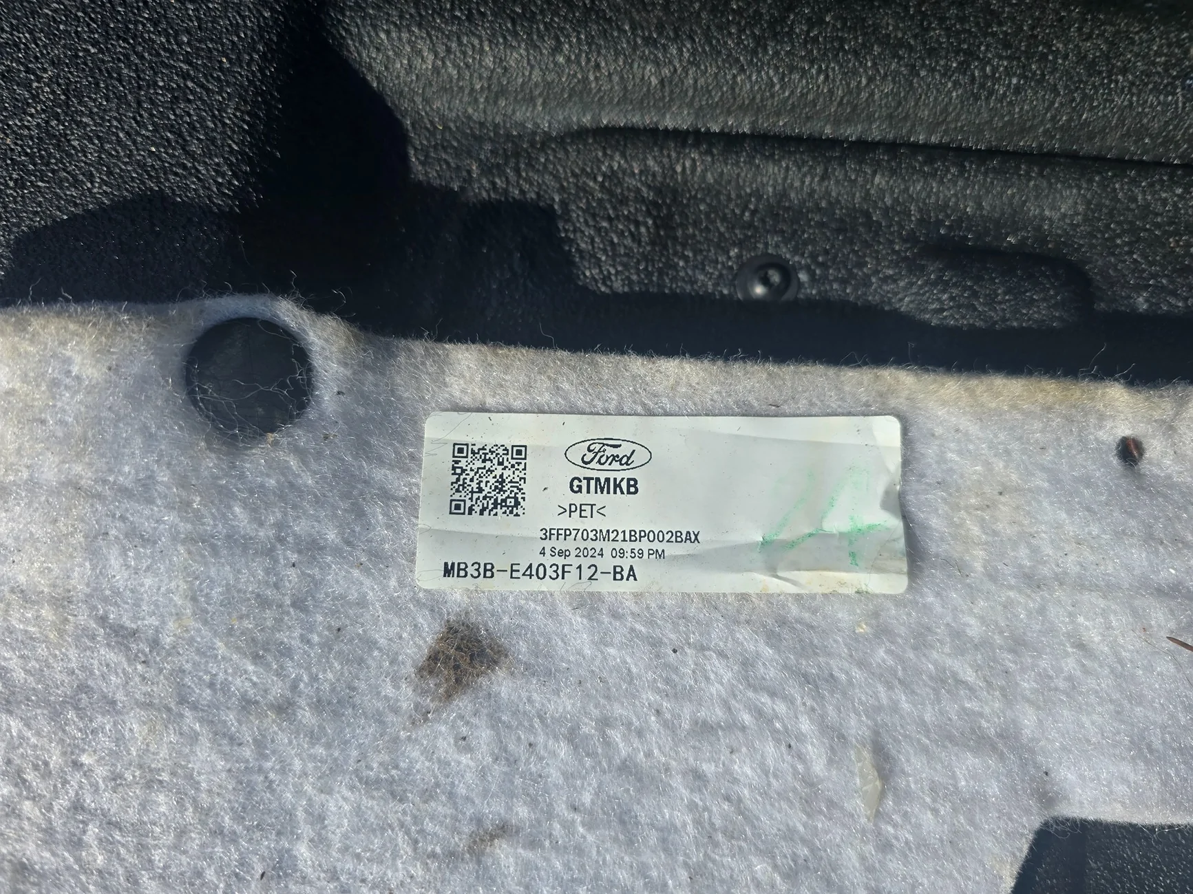

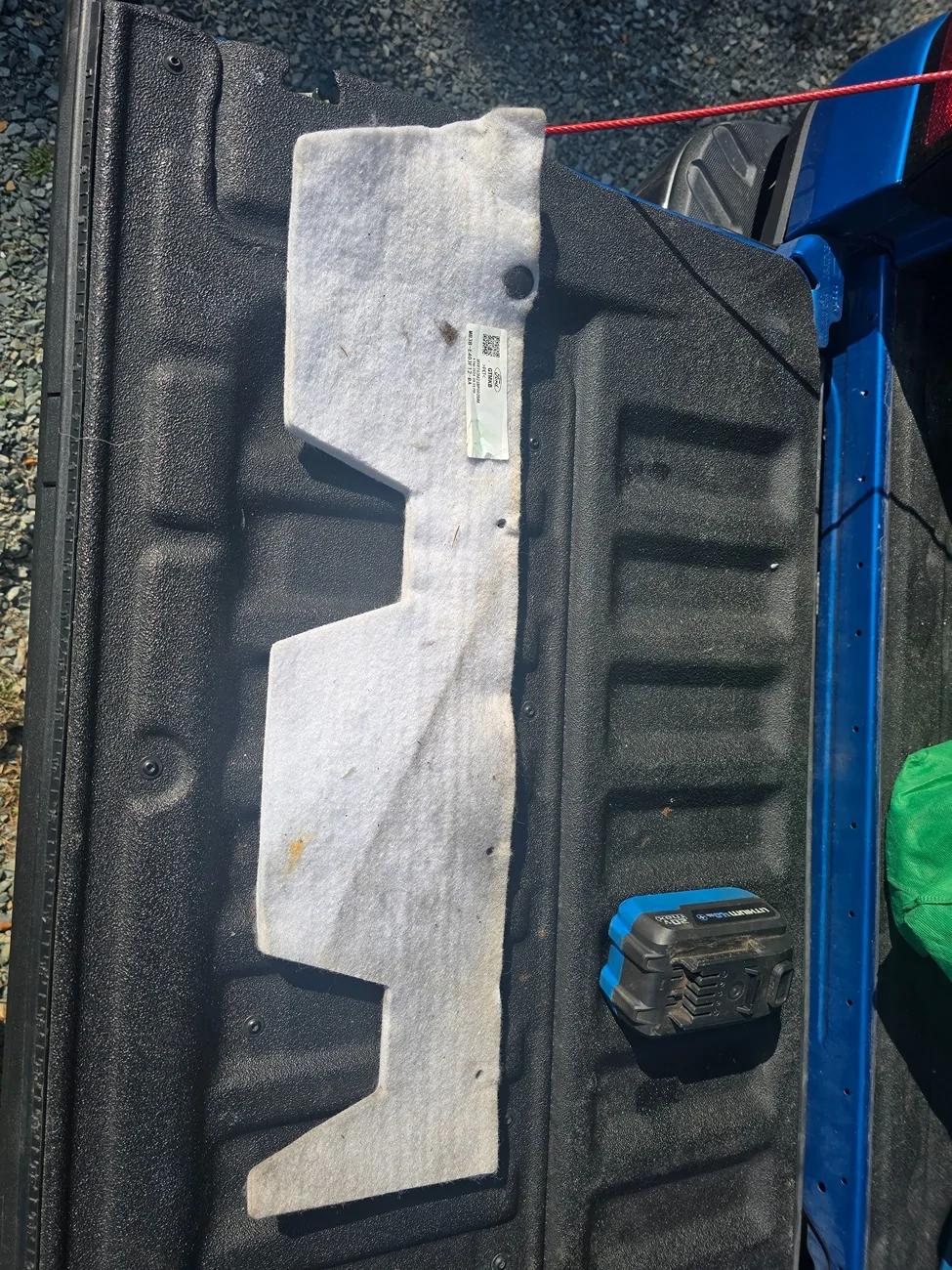

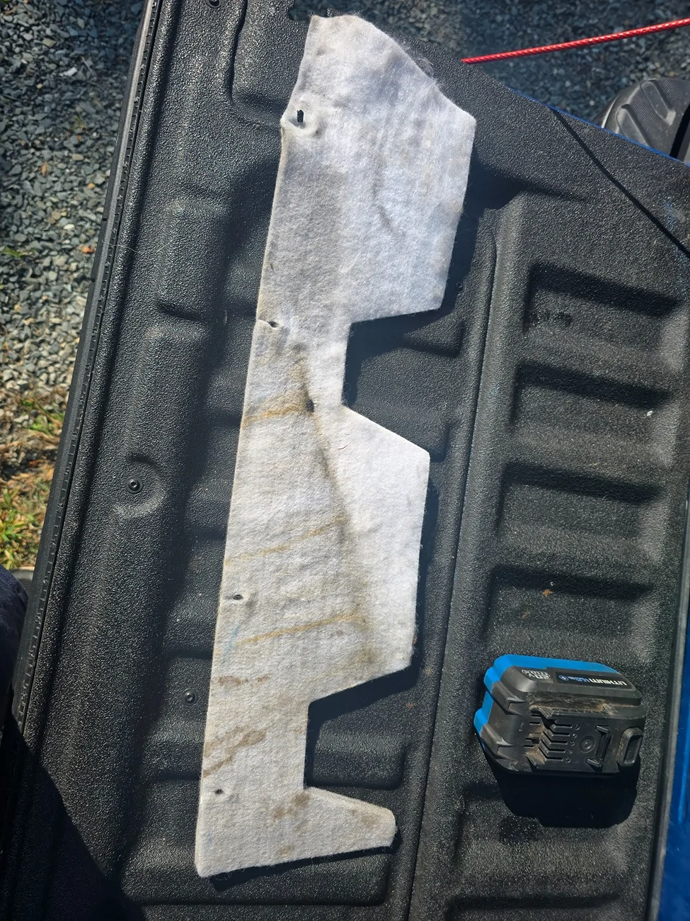

Yes. my 2025 had it. and I took it out. no noticeable sound increase. but it was wet(never had rain in like 4 days) and it was rotten. it will just hold dirt and salt up against your paint. I went in through the bed access plug, I was trying to see where the rear cab access plug was to run my rear dashcam wire out into the bed for my cap. now that the cap blocks the rear camera, and it was right there. used a 90° oring pick and bitta fenaggling got it out. lol
